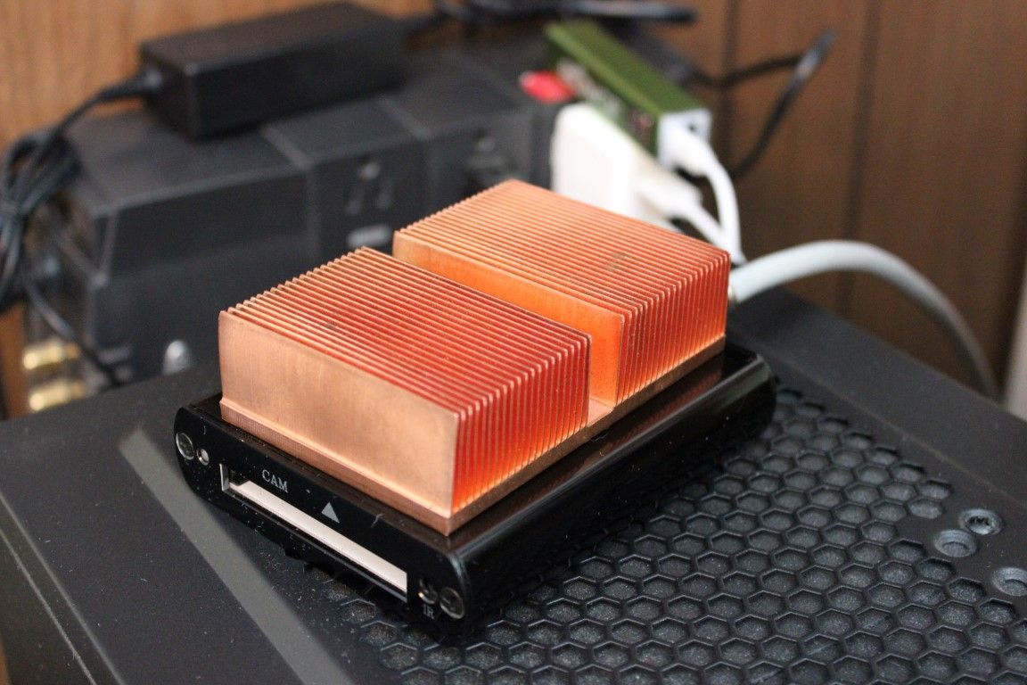

The TBS 5980 actually gets very hot when blind-scanning. It also can be (unstable) when using a longer USB cable, or a poor quality cable. I set a large copper heatsink (about the size of the top surface of the TBS 5980 device) on top of the unit which seems to have helped keep it cooler and more stable (crashing during blind-scans). (see attachment).

Just some of my experience with this unit. Your milage may vary! :)
