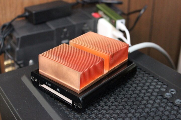

One observation,
The TBS 5980 actually gets very hot when blind-scanning. It also can be (unstable) when using a longer USB cable, or a poor quality cable. I set a large copper heatsink (about the size of the top surface of the TBS 5980 device) on top of the unit which seems to have helped keep it cooler and more stable (crashing during blind-scans). (see attachment).

Update...
Having trouble keeping the 5980 running (or software issue) for more than a few minutes at a time. Using SmartDVB I can tune into a channel and watch for a few minutes and then something crashes/freezes. Have to use control-alt-delete to stop the software, and disconnect the power to the 5980 before the software will actually close. To me this seemed like a driver issue so I changed to the original driver supplied on the disk with the Q-box, but this has made no difference. Also tried other software but as before non seems stable enough to actually render video or blind-scan other than Crazyscan, where the software/device crashes after a minute or two well before actually completing a scan.
Beginning to think this may be a hardware issue with the 5980. Will be contacting the vender to see if they have a solution.

Measured the power supply voltage, says 7.5 on the p/s case, voltmeter says 8.9V (open circuit), likely within tolerance.
But... checked for A/C voltage and I get 2V A/C!
Set up a bench supply for 7.5 volts DC (no A/C) and the device seems to run fine and a lot cooler??? Had it receiving one of the 24hr TPs on G19C all night an was still going strong in the morning.
I could not reproduce the 2vAC from the factory p/s on the bench though. Tried on the UPS again and it's gone there now too! Just for xxxxx and giggles I inverted the a/c plug (non polarized) and I get 2V of AC again!
Either it is something with my UPS or the p/s is sensitive to how it's plugged in (polarity). At least I think I have found the problem.
