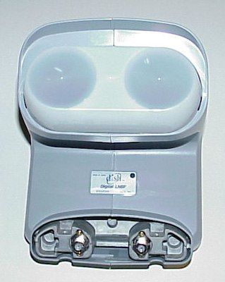

The LNB you are trying looks like this?:
LNBs Do look like that!
I have tried a single lnb (from a different system) in the 91 slot,, (119slot) great signal,+90% moved it to the eastern slot (82/110) and nothing,, not a bleap!
Any thoughts? (No switches in the line at all, just straight coax.
