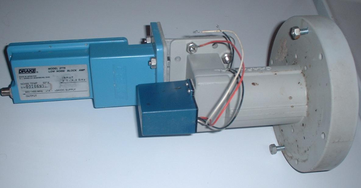

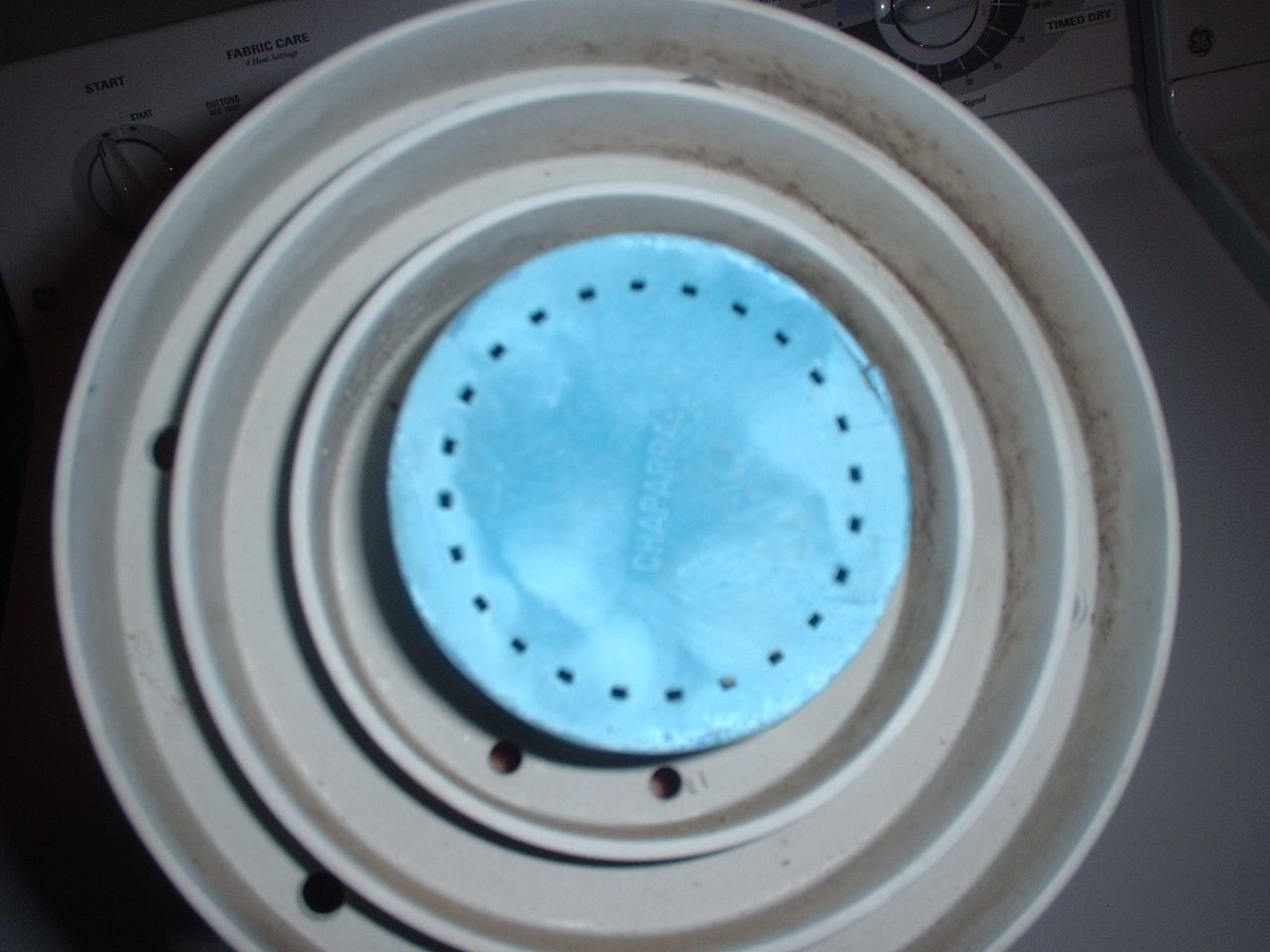

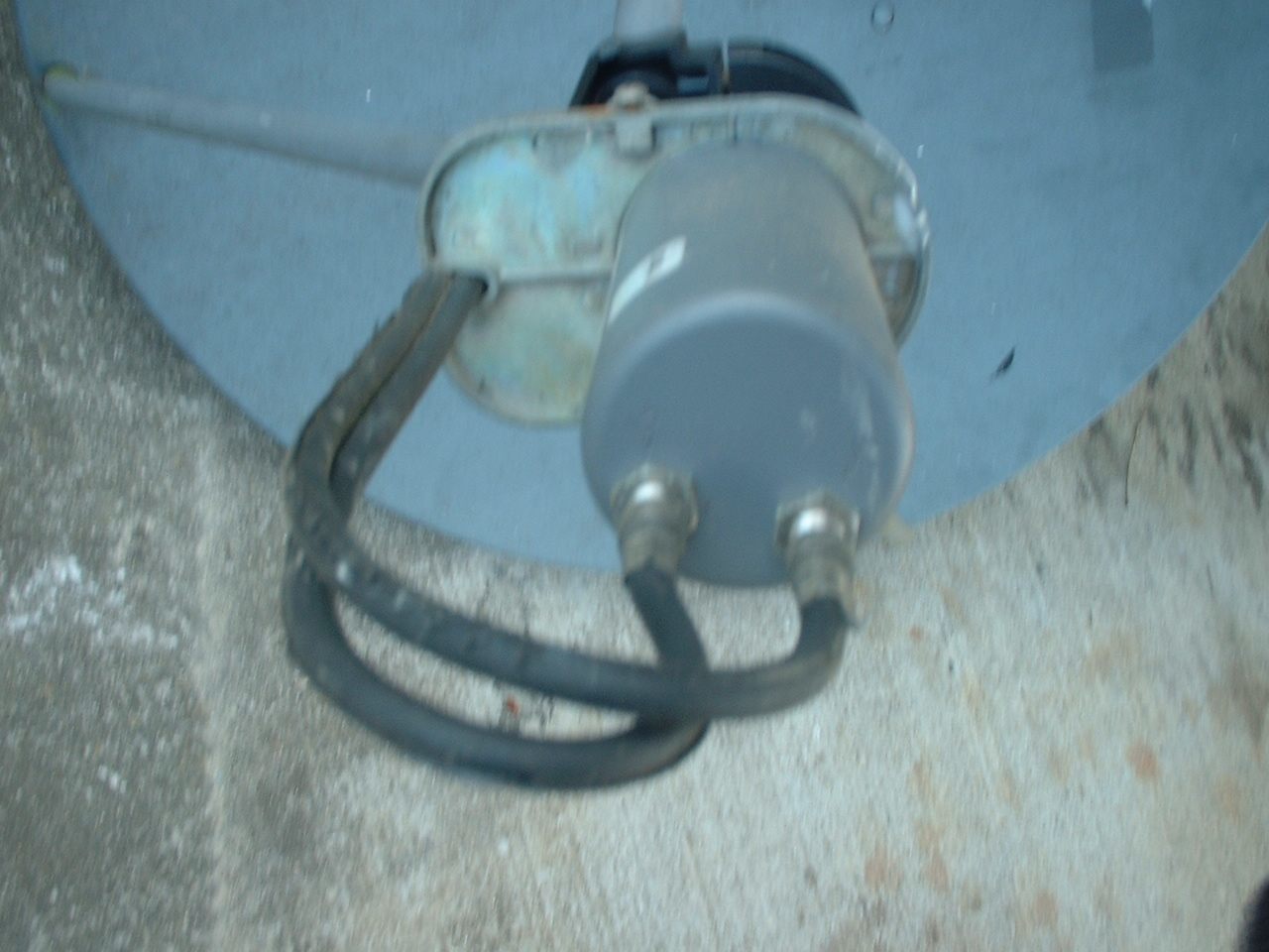

C Band Or KU Band?
Is either one of these horns KU Band?
