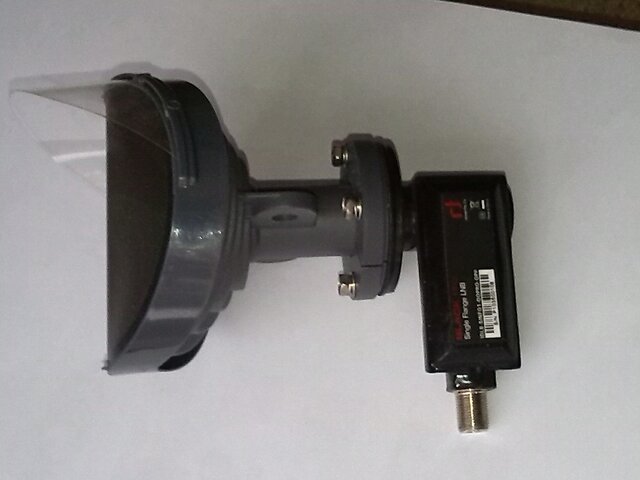

I purchased one of those last Summer. Used the LNB on the channel master with a different feed.
Purchased a different LNB for the feed for an elliptical dish and am waiting for Spring to install. Too dam cold in Michigan.
Be advised the holes on that feed may not match your mount. Did not on mine.

The PLL LNBFs are less than $20. Not to big an investment, because if it doesn't work you probably should get a bigger dish. And when you get the bigger dish you'll already have the perfect LNBF for it ;). But maybe you can scrounge up a bigger CM 84E like a STARBAND dish. The feed horn should separate from the LNB on your dish. You could find a good flange mount LNB like an Invacom to bolt on your feed horn. A few possibilities to think about.
I whole heartily agree with Magic -
Channelmaster 75E? I have the stock LNB
The stock LNB/feed combo is the best. IMHO the 75e is a bit small so the weaker may not be receivable or come and go. An aftermarket LNBF, meant for a 'normal' offset dish would only use the middle part of the dish, meaning performance would suffer more. [been there - done that - on the 84e]
The Invacom would bolt to the stock feed horn but really don't think you'd see that great of improvement. I'd be looking for a larger dish. A normal 90cm?? 'Purpose' the 75e on G19 alone maybe and a switch to use the 90cm.
