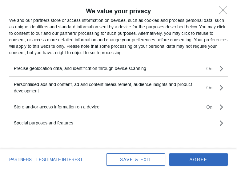

I wonder if it has anything to do with the "Privacy" settings doodad in the lower right corner of the browser.
When I click on it, I get this window. If I change the settings, it goes away but if I poke the button again, everything reverts to "On" (whether I save & exit or agree). It appears to be some rather sophisticated advertising profiling tool. If I don't hurry to agree, the 400 error pops up (perhaps on the page reload timer?).

I've been tinkering some more and the problem seems to hinge on the privacy settings as my recent post shows above. It seems to help if I avoid the button and only use the window that wedges itself up at the bottom of the screen after a few seconds.
I arrived at the determination that the site was its own worst enemy by setting the home page to www.satelliteguys.us (to avoid getting cookies from other sites) and then cleared all the cookies. There are approximately 45 domains that drop somewhere around 70 cookies on a short visit.
