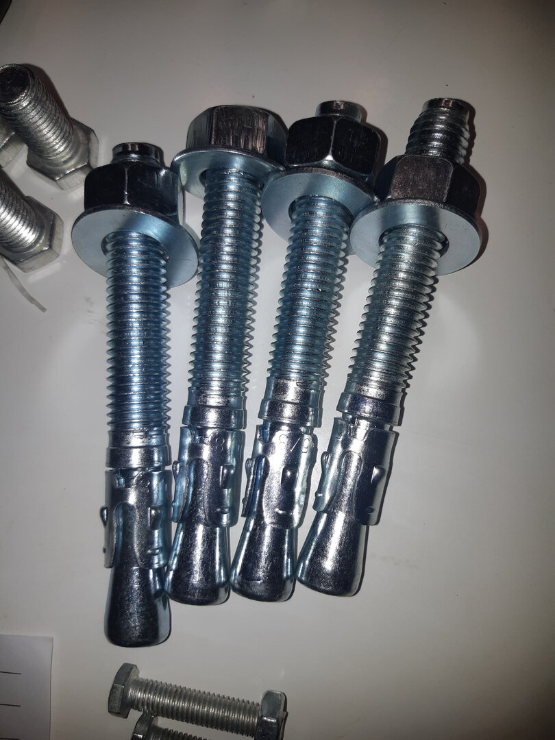

Very good. But i prefer not to plant the mast. I want to be able to remove the mast in case i need it. What do you think of these anchors ?

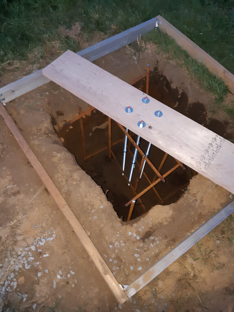

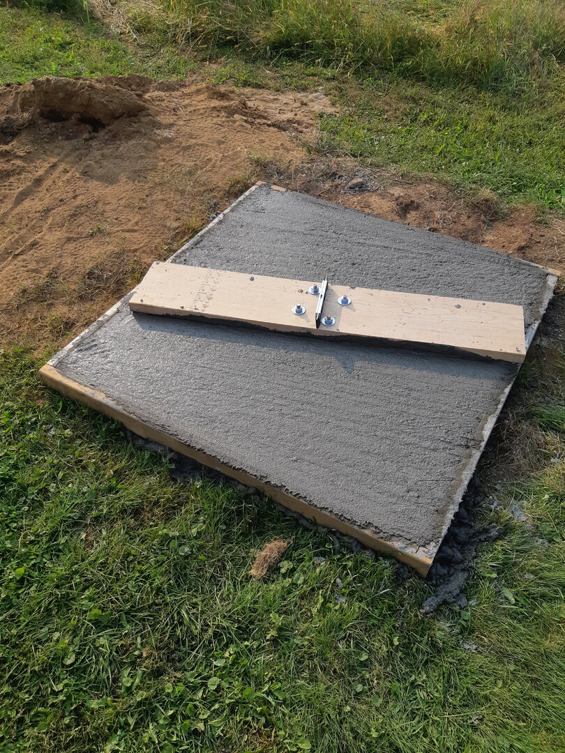

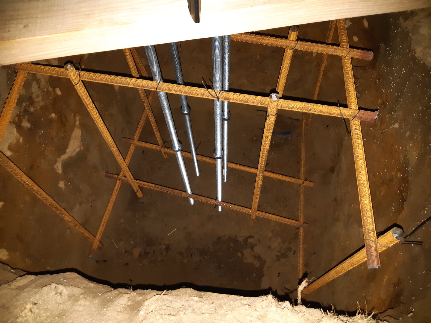

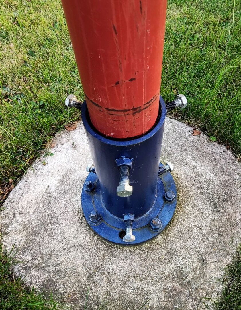

So, where is the problem, then?! Just make the mast removable and with adjustable plumbness, like I have made in several installations. IMG_20220823_194917a.jpg

This picture is for a pole of wich dish size ? Maybe i could do this for a 3.7m dish ?
Currently, there is 1.8m Channel Master installed, but if I had 2.4m antenna that would certainly easily fit on the same pole. The base is about 1 meter deep and holds almost 1 ton of cement. And anchor-bolts (as on your picture) are used. I think it is possible to make the same type of mount for your 3.7m mesh antenna.

I used that type for my first dish on the existing shed slab. They have held up well considering they were installed in, I believe, 2014. If you are pouring new concrete I would use the J bolts that John (JFOK) suggested. Sink them in the concrete immediately after you pour and make sure they line up with your dish base as there is no going back once it sets. Here is a Google search to show what they look like. Make sure you get large long ones designed for weather exposure that will support the weight and wind load the dish will have against it during storms.
