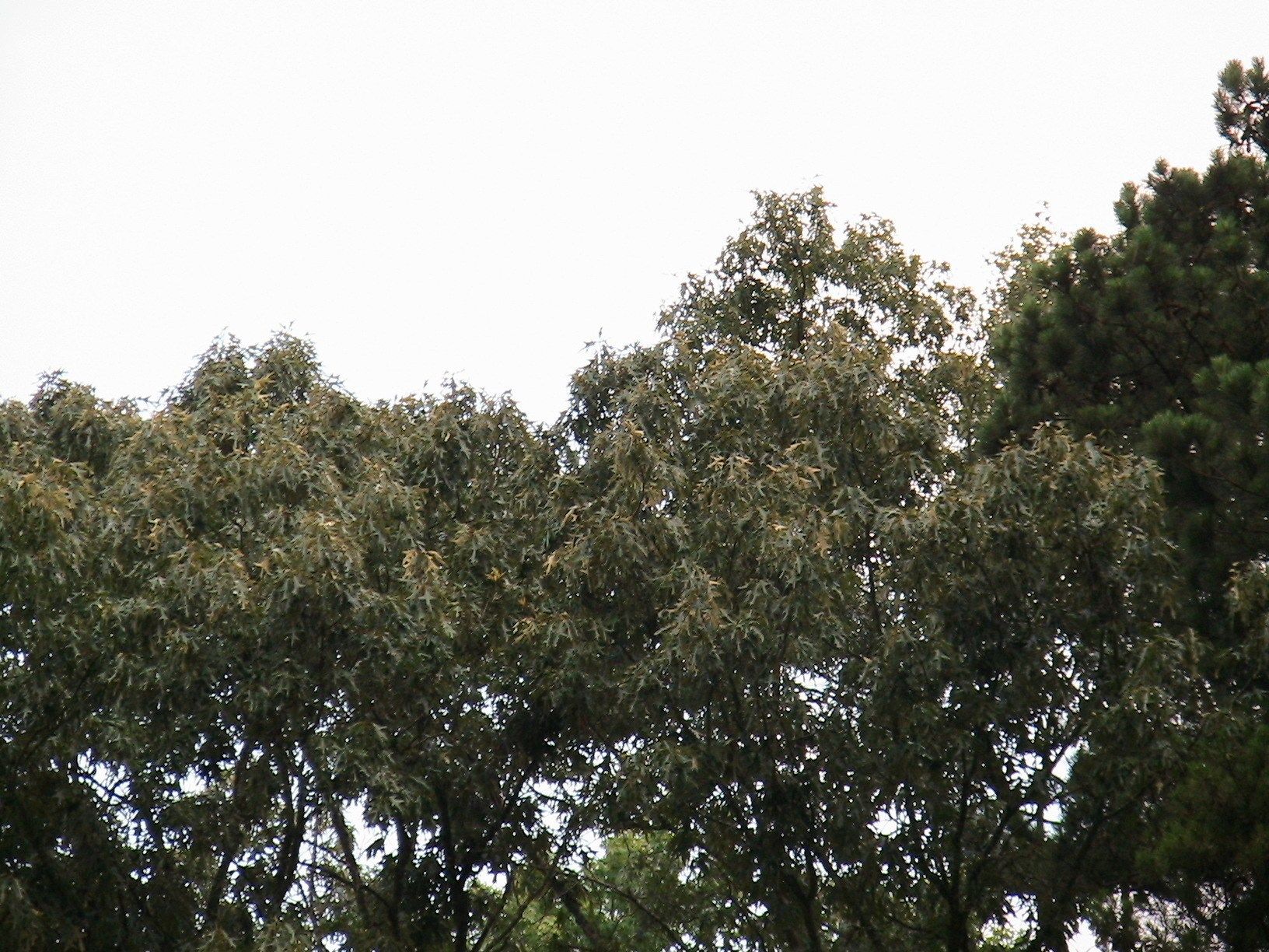

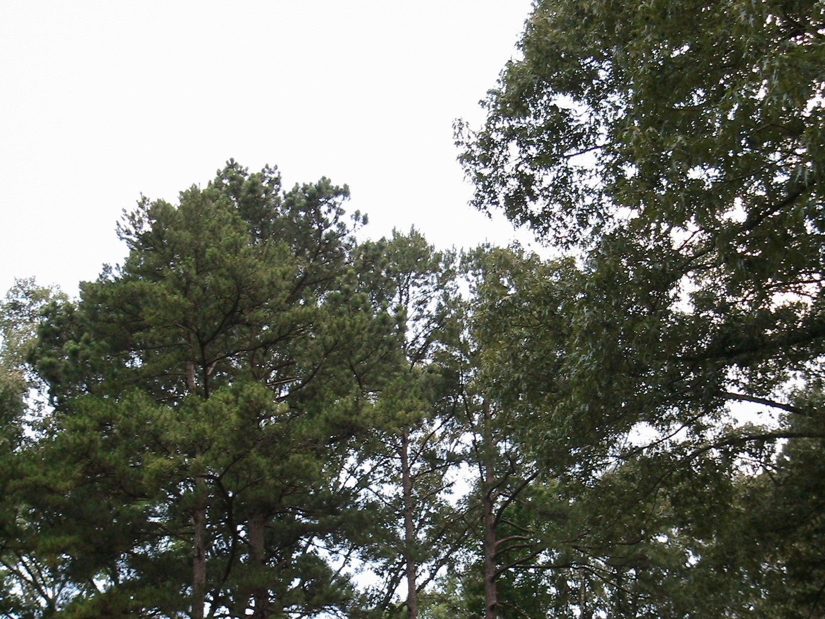

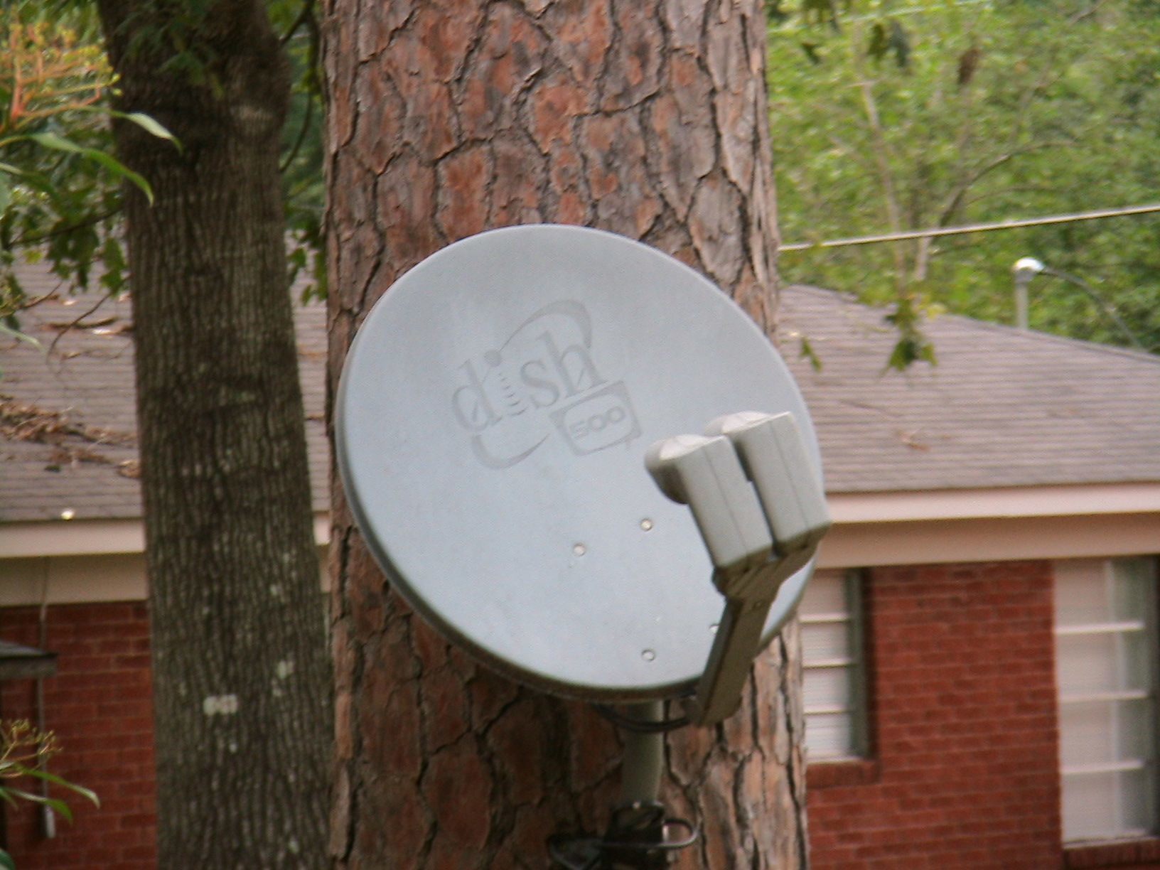

I'm at 32° 23' N , 93° 46'W (according to google). Here's some pics of the offending trees and the neighbor's dish.
I think the neighbor's dish is a Dish 500.
I got the 45° figure from the installer, who set his inclinometer to 45° as he walked the yard.

It's hard to tell from those pics, but those trees do like they could be a problem for the 1000.2. And you have to remember, your house is not your neighbors house. Even if you were to somehow bend space time and both exist in the exact same place at once, your neighbor just has SD(which the installer even told you that you could get too). you need to be able to hit 3 satellites from one location. The 129(for most of your HD) is going to be lower then the others.
I'm sure with a bit of effort and time the installer might have been able to rig something up, but most of them don't have time to waste and have to make a (basically) on the spot decision, based on experience. He needs to be able to garuantee that LOS for a long while.

what's your zip?....I am at 35north, 81 west and the 129 is at 250 Azimuth, 24 degrees of EL...I highly doubt that 12 deg west and three deg south is going to make up 21 degrees of elevation...I took your Lat/lon and guessed you are somewhere near Bossier City ,LA..Took that zip (71111) and looked up the 119( I cannot isolate the 129 on my receiver)...The 119 is 217 deg AZ and 43 degrees EL.....The 129 is 10 degrees longitude west of the 119 and in these parts 9 degrees lower in the sky....Making adjustments to the best of my ability, the 129 is probably around 33-36 degrees of elevation in you neck of the woods...no way is it 45 degrees....How is your view of the 61.5?..the AZ is about 126 and the EL is about 39....A two dish solution may be your best bet ..Better than to spend a fortune on masts, concrete, guy wires and other headaches

I love the "pole" that Dish500 is on ;) LOL!

P.S. I wouldn't use your neighbors dish as a basis of comparison for anything considering the fact that it's mounted to a TREE!!!:eek: I guess he must be a pro at realigning that thing.
EDIT - I guess I should have read page 2 before I replied.:D
Is your neighbor's dish attached to the tree ? Just oddly curious
Oh yeah. It's screwed right into the tree. It works for him.
