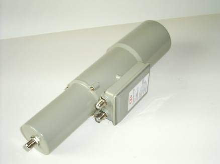

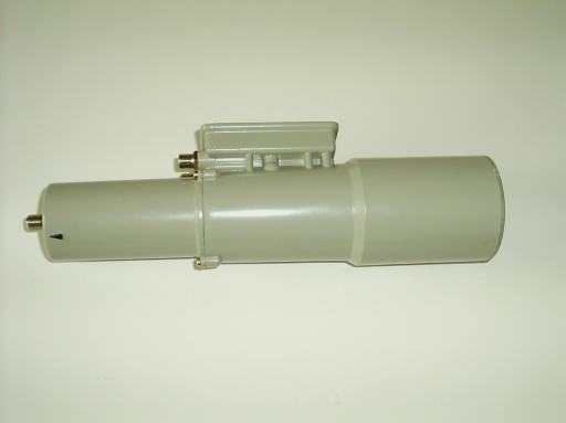

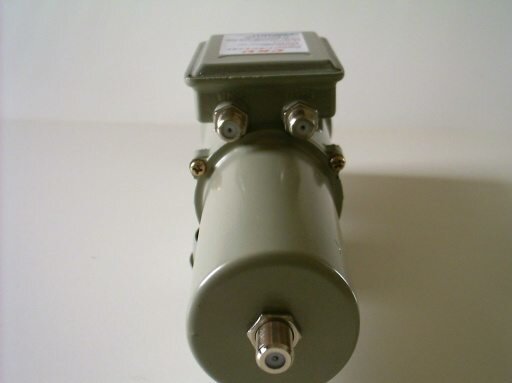

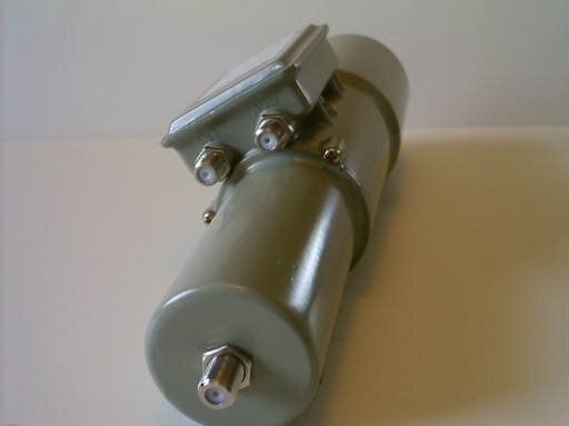

Just back from a week working on motorized satellite systems in L.A. California :)
First thing I see on my return is a new C/KU LNB for testing :)
Still working on it so once again this is a review/test in progress.
I have been using the Splendid ASC-421 C-Band LNB up until now and the first thing I did was swap it with the new CKU LNBF.
I was on a HD movie channel, the signal Quality was at 67% as soon as I swapped the LNB the quality jumped to around 70% :)
Still working on the KU side and will add my findings here........
The C-Band side is standard with the L.O. being 05150
The KU side of the LNB is a Universal with the L.O. being 09750-10600

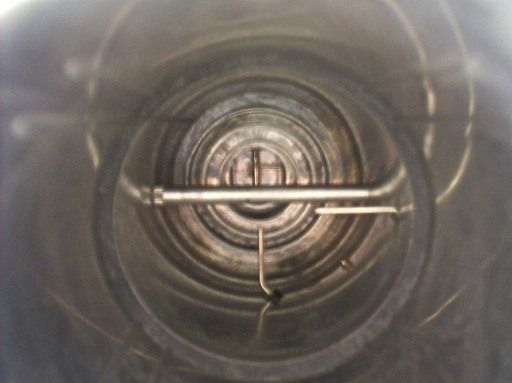

The REALLY neat thing about this fantastic LNB is that it has its own internal 2x1 DiSEqC switch, so one cable from the receiver does it all!
MUCH more to come!
"High stability DRO, and using the new BSC technology"
Comes with a dielectric plate for the few circular polarized C-Band satellites.
Nasty Negitave remarks will always be removed from a review!
Pictures......

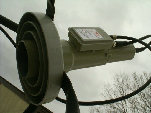

Update, still getting PERFECT results with C band but not having as much luck with KU, for example the best I can get on The University Network on IA-6 is around 45% and on Azteca I get around 60% signal Quality.
I have never tried KU before with my 6' mesh dish so will be open to suggestions here!
Was out last night and at some points was able to max out the signal quality on KU signals on my professional satellite ID. meter (SatHawk) but never as good on the receiver.
Was hoping to work some more on this today but we are having HEAVY thunderstorms!

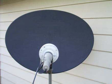

WGN News SBS6
Signal Quality at 60% on the CKU LNB and 6' dish (Around 75% on the 36" with Invacom 0.3dB)
maybe the holes in your dish are too big for good KU reception
Have you tried to mount this on your 36" dish and see what happens for KU?
Will try the 40" P* later, but the holes seem small enough.
Can you drop your 6' dish off here tonight? :)
I did try putting a smaller solid prime focus dish right in the center of the BUD but that never helped, when I was removing the small dish the signal quality did take a jump, so you "may" be onto something there......
Production just started today, so I would guess a lag time of around 8-10 weeks. Will keep you updated here :)

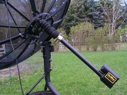

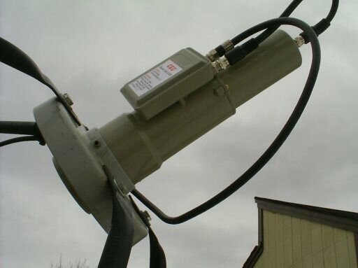

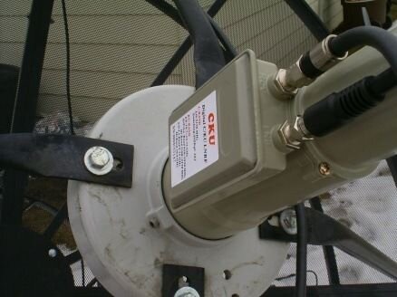

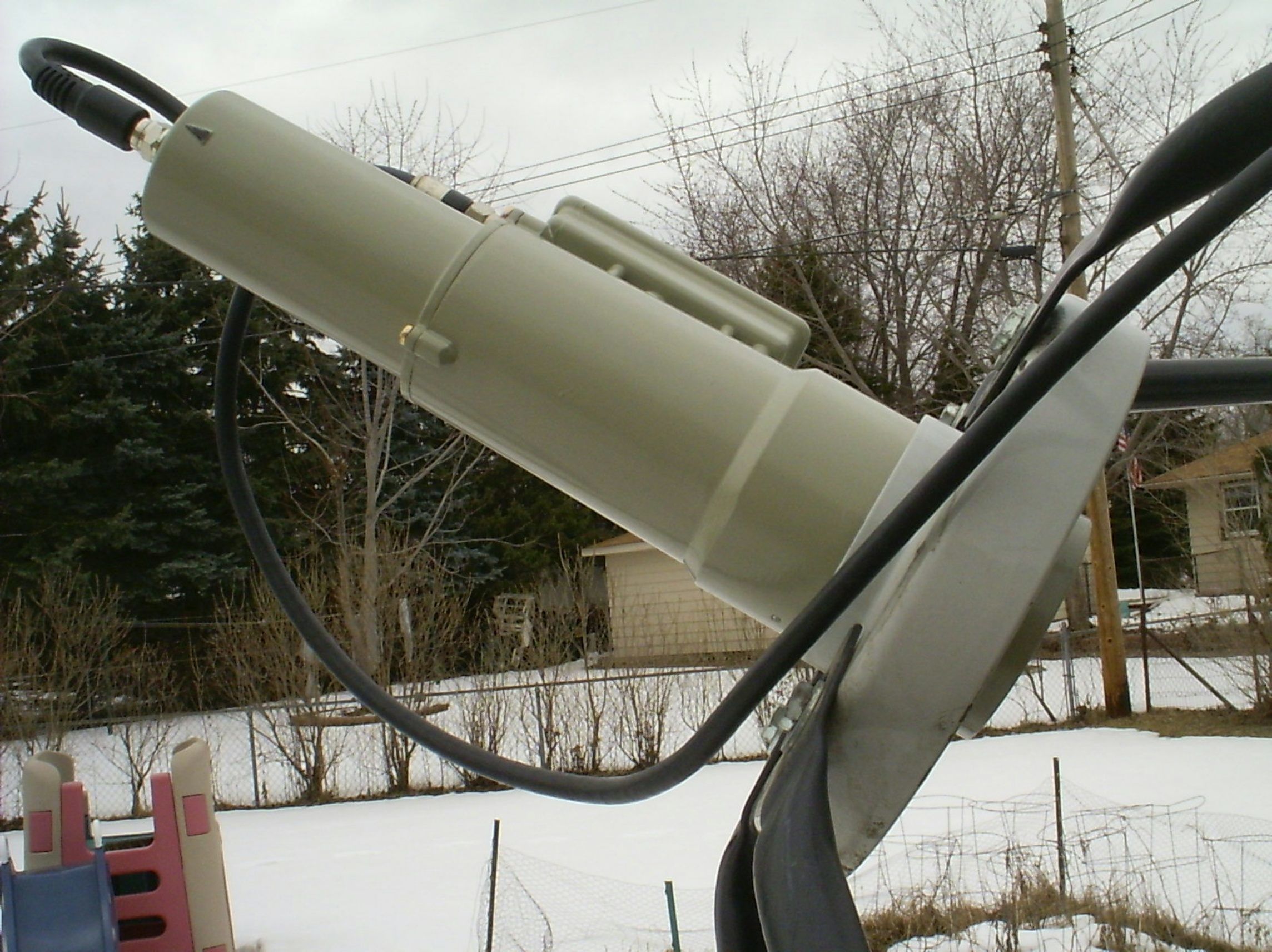

Tried putting the CKU LNB on my 40" P* dish, again C-Band was fine (As my previous 40" dish C-Band experiments) KU not as good.
So I put the CKU LNB back on the 6' dish (Upside down) with the notch at the 6 o'clock position.
Now getting 66% signal quality on The Patient Channel on AMC-3 :)
Best results so far!

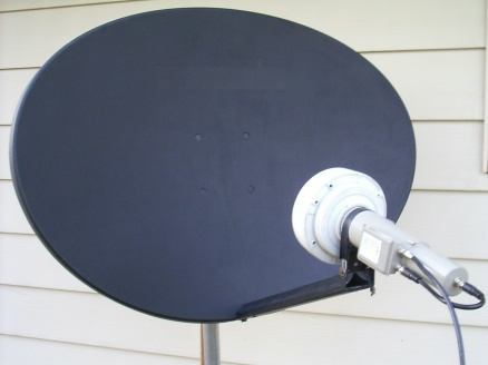

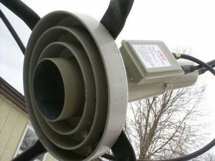

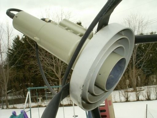

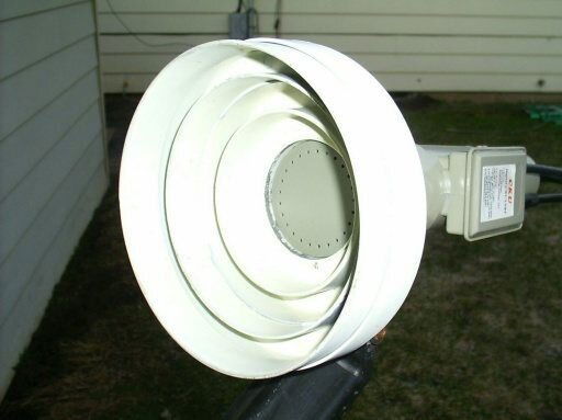

Modified holder and hand made scalar ring (By Alec, member here from Alaska).
Pete,
That scalar ring undoubtedly helps some with C-Band reception--but wouldn't it hinder Ku reception? Try removing the scalar and see what your Ku reception looks like.

I started with a regular scaler ring!
Oooooooh....*very* nice. I may have to rethink my decision to go with a 90cm dish, a 1.2m sounds very tempting now.
I did NOT find it terrible with KU, just more of a compromise than the ultra low noise LNB's I am used to. Also I rushed the test and my BUD was not motorized at the time of the test. The test was also done between trips to CA. then FL.
Expecting GREAT things with the Standard KU version and my motorized BUD!

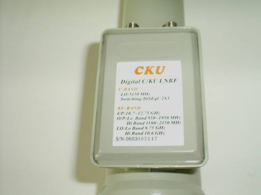

BSC321-2 C/KU LNBFSpecs
BSC321-2 C/Ku LNBF
C Band
Input 3.4~4.2 GHz
Output 950~1750 MHz
LO 5150 MHz
Gain 65 dB
Ku Band
Input 10.7~12.75 GHz
Output 950~1950 MHz Low band
1100~2150 MHz High band
LO 9.75 GHz Low band
10.6 GHz High band
Noise 0.3 dB
