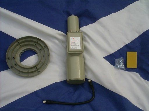

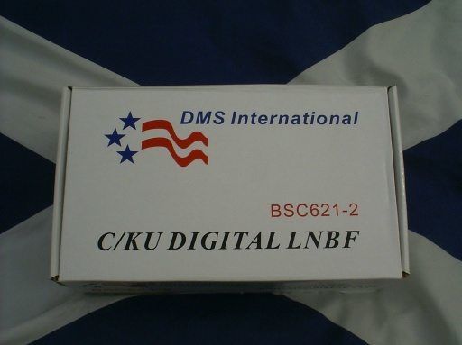

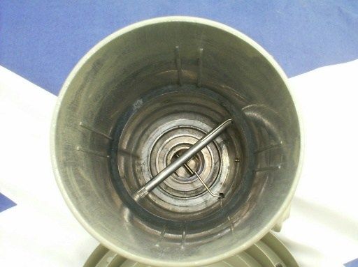

Mine arrived :D
More pictures..........

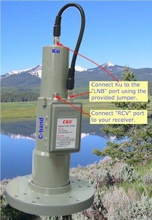

Installation Instructions!
See below picture.......

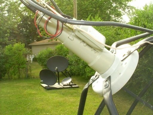

Here are some tips when peaking in the Ku signals using this LNBF........
First find a C-band satellite signal using the C-Band side of the LNBF (C-Band is much more forgiving than Ku), change to a known live Ku transponder on the same satellite, then motor east and/or west until you hit the Ku signal, it will NOT be in the same azimuth position as the C-band signal.
Then re-skew the LNBF to peak the Ku signal, I had to move mine about 2º from the "0" position.
Final step was to adjust the F/D of the LNBF for maximum Ku-Band signal quality.
I also modified the LNBF cover to squeeze every point of signal quality from the LNBF. (Mentioned in its own thread)
Very happy with the Ku results. The C-Band signals did drop slightly after peaking in the Ku signal but it has to be done! And my C-Band signals are still great, and with C-Band not being effected much by rain fade its not a big deal.
