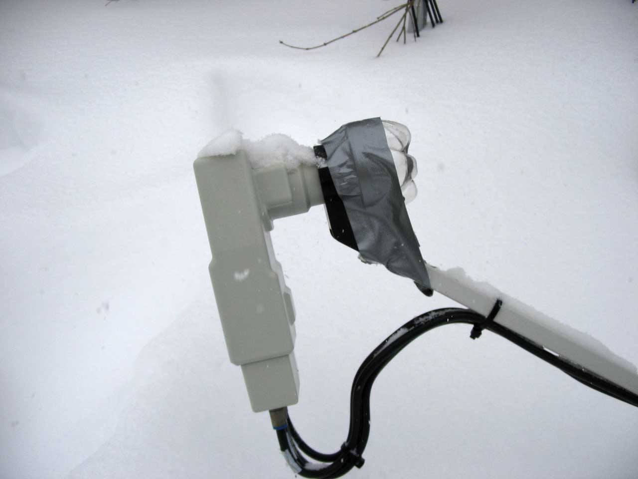

So I got my BSC621-2 today, to go with the Coolsat 6000. I had been playing with the Coolsat using my old C-band LNB, and have been pretty impressed.
Anyhow, my question is about the BSC621. - I got the scalar ring hooked to the four BUD support arms, and it is very solid.
But the BSC main unit seems to only be held in the scalar plate by one bolt that you thread in to hold it in place. - It seems very wobbly and won't really sit square.
Am I missing something here? Do I need another bracket or something?
I am getting channels, so I may just Jerry-rig to make it more solid. - All I did was just put it up there an tighten it, to get out of the blizzard. I will adjust and play with it later.
Duct Tape. LOL :)
