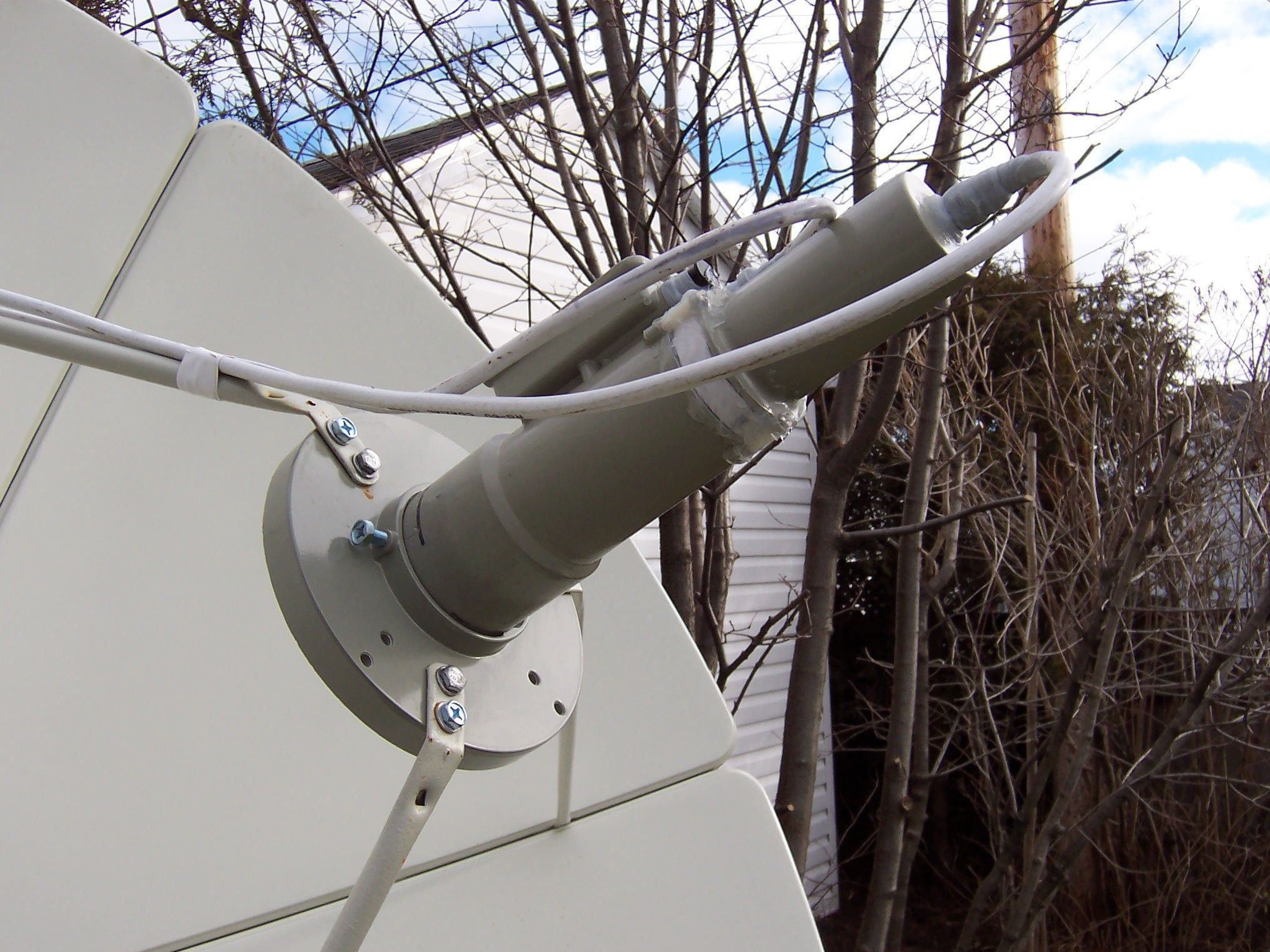

Hi everyone
I have read alot of useful information onthis forum and now it's time to share my experiment
with the standard BSC-621 LNB.
One mont ago i buy a conical scalar ring and a BSC-621 C/KU lnb to experiment with my old 4
feet GI fiber oofset dish .After a week of testing and tweaking my conclusion was, on Cband
i had to much co-satellite interference !Not a big surprise but the ku side perform very
bad. Why? i dont Know... maybe the dish F/D not made for this LNB .I do it, i buy a 6 foot
prime focus dish.
A week later i start tuning the dish and lnb. Afet peaking the lnb for c Band (focal length
and F/D) now i have good signal and no more co-satellite interference on the sat i want. I
was very disappointed by the ku signal , i have lock on strong transponder only!
At that point i scratch my head!
I notice during my test on both dish , if in the bracket i tilt the lnb body at one position
quality raise to interesting number 90%. At the same time i lost the c band , this is not a
pratical solution.

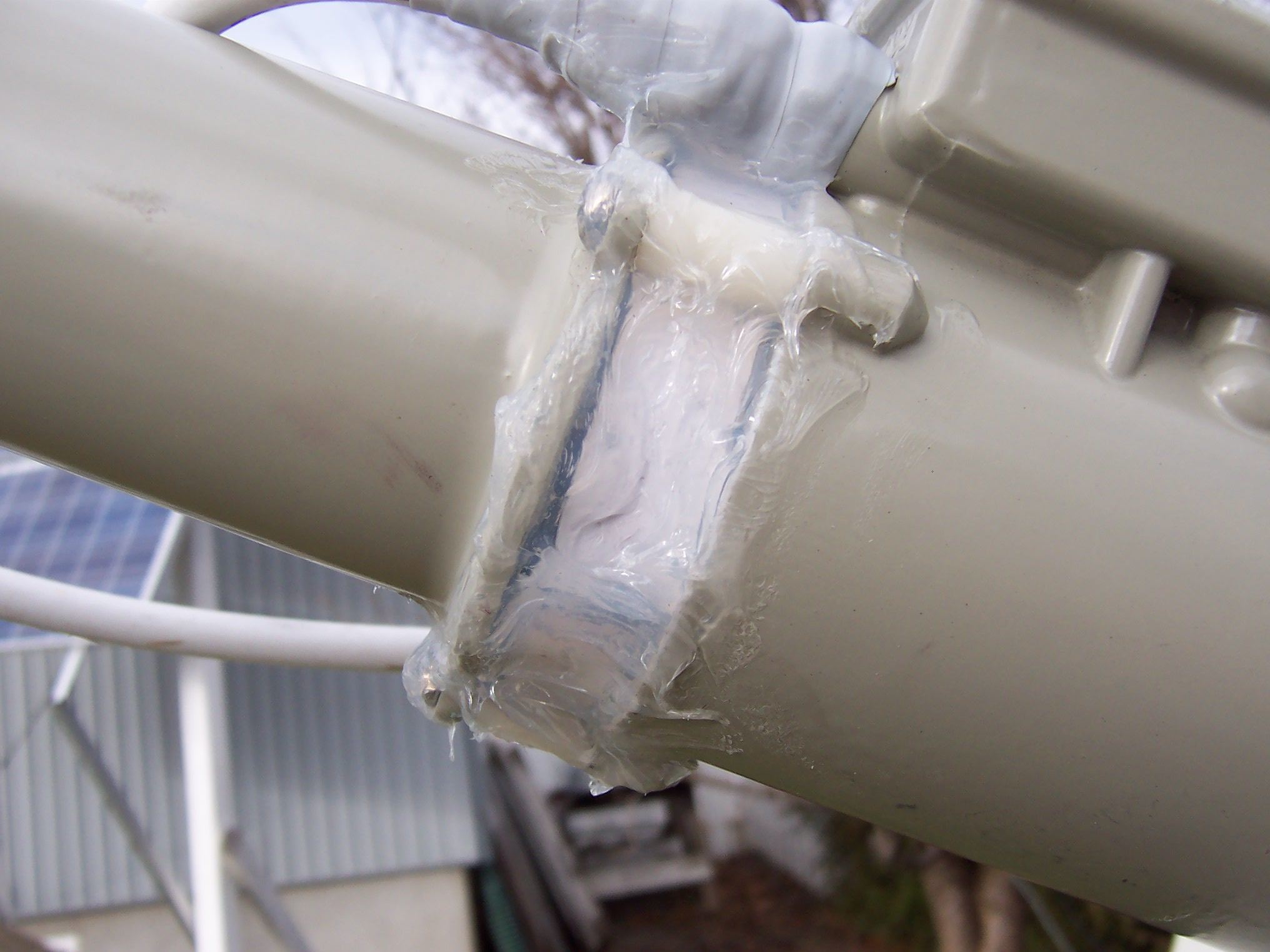

After another week of thinking, i decide to separate the ku side from the lnb.I remove the
tree screw and separate them. A bit hard to separate because the rtv is very goog quality.
With my receiver beside the dish i star slowly pulling out the ku lnb until i find the best
position for maximun quality on my receiver. I find between 1/2 to 5/8 inchs was the best
distance.

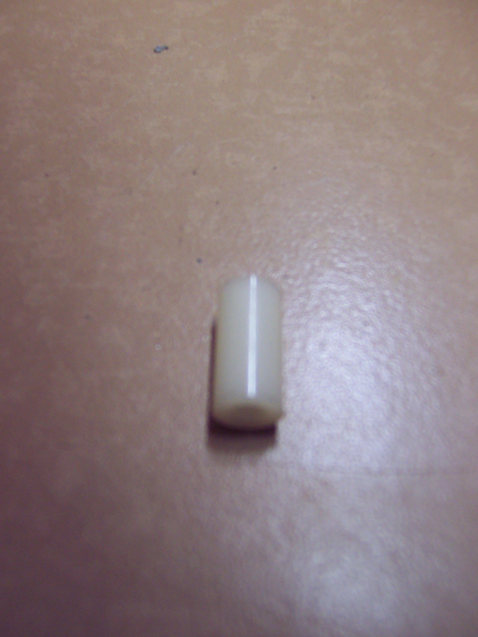

To attach the lnb (ku) to it new positon i use tree 1/2" plastic standoff spacer used for
supporting pcb(printed circuit board) with longer screw.I seal the gap with a strip of
aluminum sheet and silicone RTV.
I think this lnb was desing to be used with dielectric plate in place , ku wave goes right
at the ku waveguide opening with the plate. Without the plate that chage the speed of the
wave and focus point at the same time.
The C band section of the tube act as a wave guide, for ku the wave is bounce on the wall
and then focus again and bounce again until wave focus and enter the ku waveguide .That my
theory.
If some boby try this mod post your result.
Since i made the mod i see no degradation on c band.
Any comments welcome.
Nick

Thank you for your very clear pictures! - :up
That LNBF has had a pretty bad reputation on Ku for the several years it's been around.
Other LNBFs, such as the Ck-1 and the DMX741 seem to work adequately on Ku, but require delicate centering on the dish to work effectively.
Hope other members will try your solution and confirm.
Thanks again - :cool:
