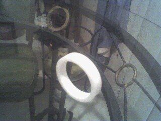

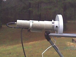

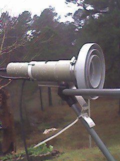

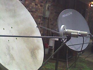

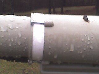

Here are some pics from my mod of the bsc621-2 with the 1/2" polycarbonate rings. I am using a 1.2m dish with flat scalar driven by a sg2100 motor, not in picture, powered by a pansat 2700 receiver. I am getting a signal quality of 55-60% on the c band side of most sats. 0% on ku side with or without the mod. I am still testing this so more results to follow.
Photo_101509_005.JPG Photo_101509_006.JPG Photo_101509_007.JPG Photo_101509_008.JPG
Try cementing in aluminum foil to the interior and edges of the ring. You have made an abrupt end to the waveguide that maybe disturbing the Ku signal.
Minimo - "I seal the gap with a strip of aluminum sheet and silicone RTV."
Makes perfect sense, I will give it a try. If this is the case, I can make the ring out of aluminum and this should solve this problem, right?
BSC621 Aluminum Spacer
Madd,
Aluminum spacer should work good. I like your approach of just using longer screws and spacer.
If you install Al spacer, don't apply silicone untill after you secure it with screws. Make sure you have good conductivity between parts. Otherwise you may create Intermodulation IM products that would kill the signal.
If it works and you have a Paypal account, I'll buy two:D
