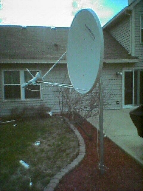

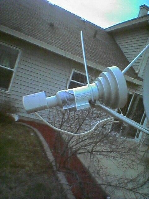

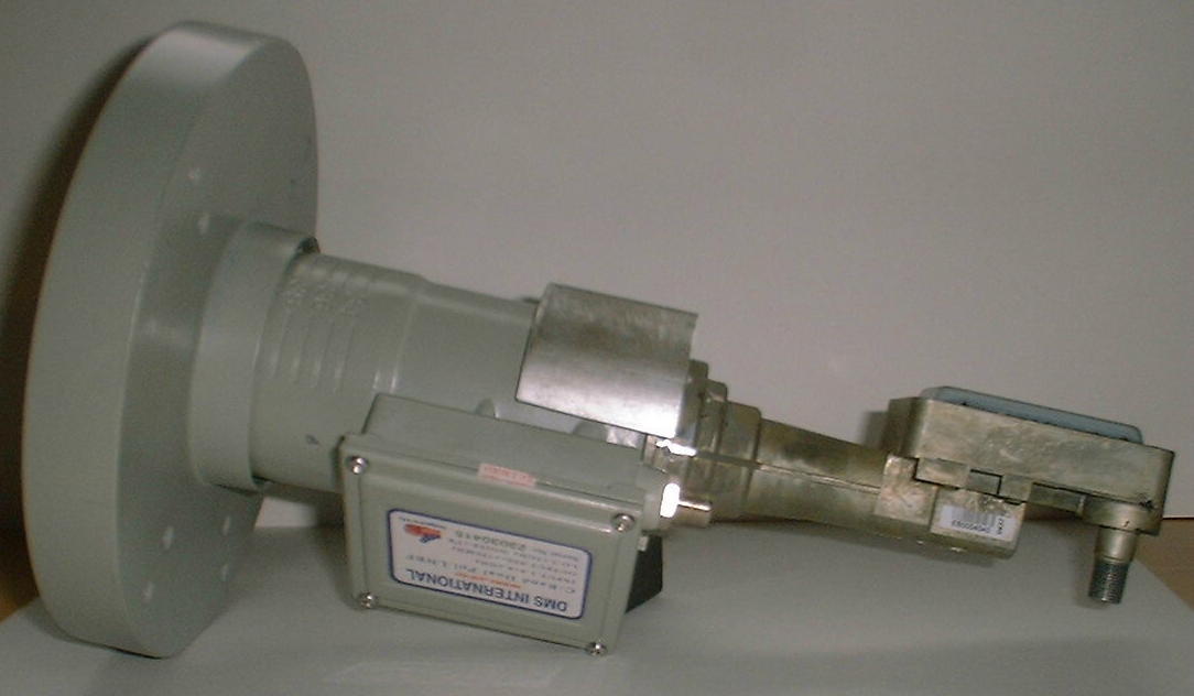

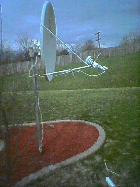

Have you ever posted a picture of this rig?
I have searched & seen several posts where you mention it, but no picture:(
I keep amusing pictures, but don't always keep where they came from.
Below are some like what you are describing.
I don't know if any of 'em are Truckracers pix, though.
