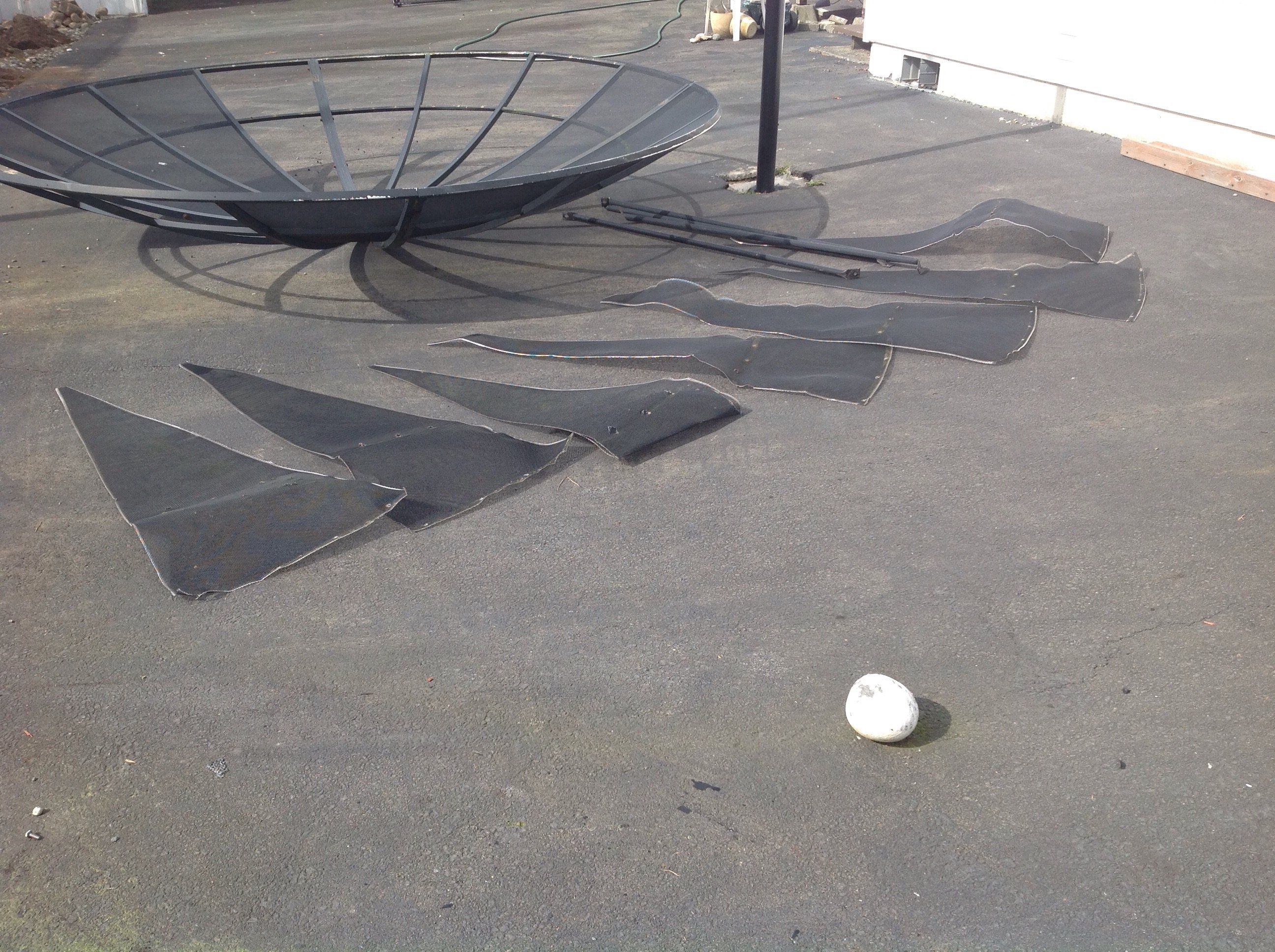

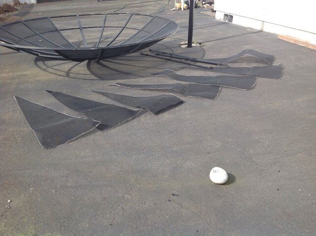

No, I said in my previous message that the mesh were torn and has holes on them, so my 22 years old nephew thinks it needed to be replace. So, I'm asking you do you know what brand makes package I could find at LOWES or Home Depot that is roll of mesh????
See photo attach.
Not the worst case I've seen. Think I'd just work the pieces flat and patch the largest holes with something like this. "Available in different patterns" Sew the patches on with aluminum wire. Give 'em a shot of black spray paint.
I used this technique where there were half a dozen 6 in holes made by hail BITD. Didn't notice any loss in performance. Just massaged the patches to conform to the curvature.

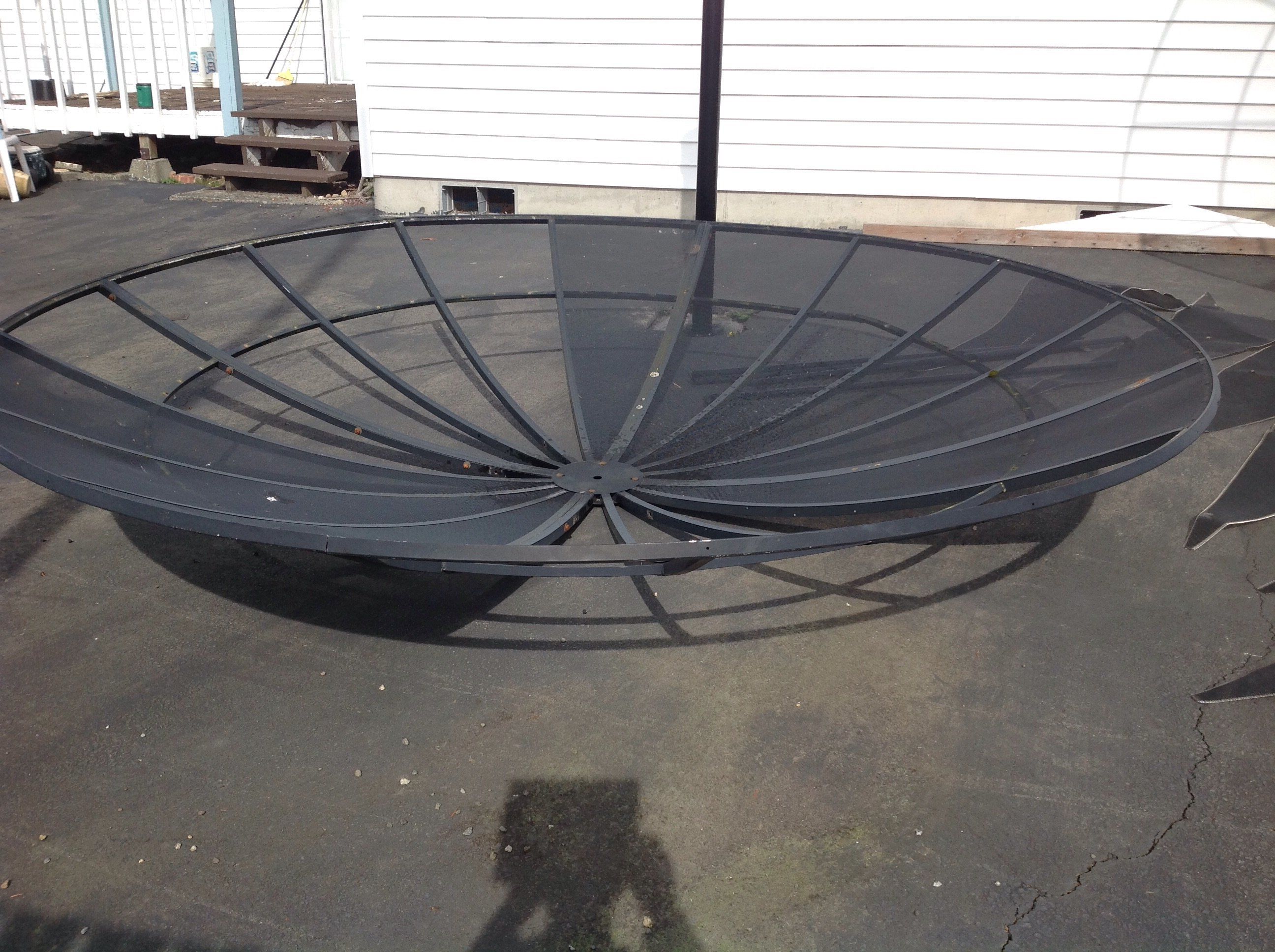

From the photos you posted, I think your old panels can be reused. The tears appear to be only around the screw holes.
I recently did a mesh repair on my 7.5' Echostar (KTI). The panels on my dish were in similar condition to yours. I laid each panel (curved side up) on smooth flat concrete and flattened them out using a rubber mallet. Once flat, I slid the panels back into the channels on the frame.
When reattaching the panels to the frame, I moved the screws over from any areas around the original screw holes that were badly torn. There were a few 4" - 6" torn spots in the main field of the mesh that I sewed back together. For that I took stranded picture hanger wire, pulled a single strand out and then stitched the tear back together. If needed, the thin wire could also be used to secure the mesh to the ribs.
There was one piece of mesh on mine that I couldn't completely salvage, so I used a piece of thin perforated sheet aluminum to replace the damaged portion of the mesh. I cut the aluminum to shape using a mesh panel and then placed it into the frame. A metal supply company in your area may stock perforated aluminum sheeting.
BTW, is it just the angle of the photo or is your dish warped?
