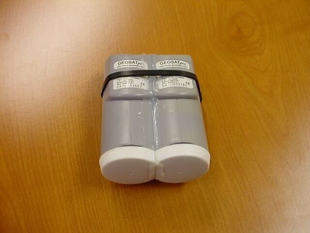

I made a dual LNBF set for receiving 123W (G18) and 125W (AMC21) using the mini LNBFs from SatelliteAV (-SINGLE STD FTA SATELLITE LNBF- MINI - SatelliteAV, LLC.) and the GeoSatPro 1.2 meter dish from SatelliteAV (GEOSATPRO 1.2M OFFSET SATELLITE DISH - SatelliteAV, LLC.).

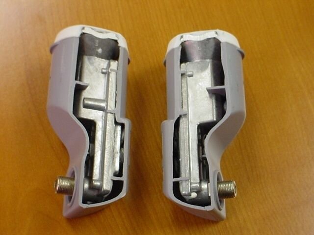

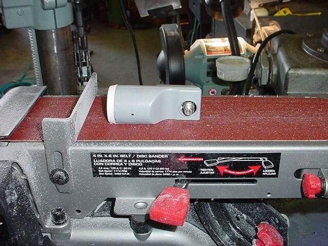

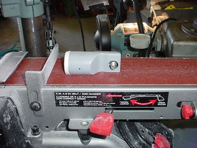

The Center Line spacing of these mini LNBFs is 40mm as they come out of the box. I wanted 30mm C.L. spacing. So I machined 5mm off of the adjoining sides of the LNBFs and mated them with silicon RTV rubber & a tie wrap.

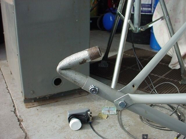

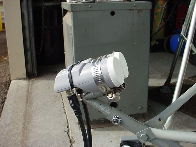

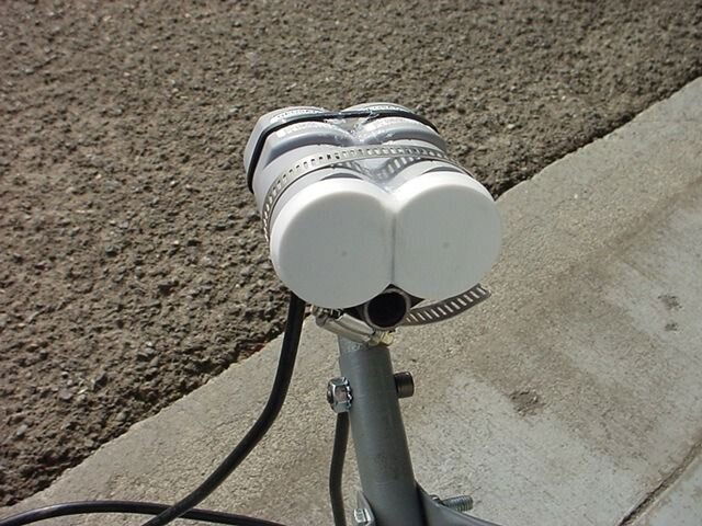

Next I fabricated a mount from a 3/8 inch pipe nipple bent to 45°. I then fastened the dual LNBFs to the mount with a hose clamp. This allowed the paired LNBFs to be skewed. Here in Oregon I only needed 1° because my longitude is 123°, but the set up can be skewed on the pipe nipple as needed.

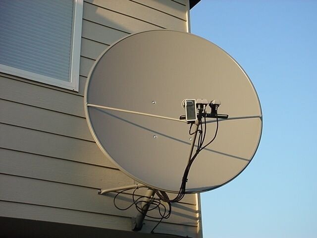

I have attached pictures of the process and the finished setup.
I receive both satellites just great.:)

~60-65% on a Merc II. Will get better numbers when I get it permanently mounted to the house.

pretty cool to see the inside of LNBFs. I always thought they were circuit boards and such epoxied to the inside of the case. I didn't realize they were self-contained in a metal case and then the outside was put over that.
I may try a G18/AMC21 experiment using a thing I picked up many years ago. It's a curved bar with clamps - one LNB goes at the center and the bar has room for a few more LNBs if you want. I last used it for AMC5/SBS6/AMC6 setup but the bar has been void of all but the center LNB for a few years.
I guess taking 5 mm off the side of each Mini wasn't so difficult after all. - :eek:
You really made it look easy! - :up

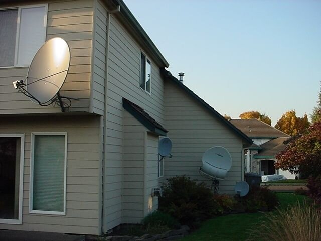

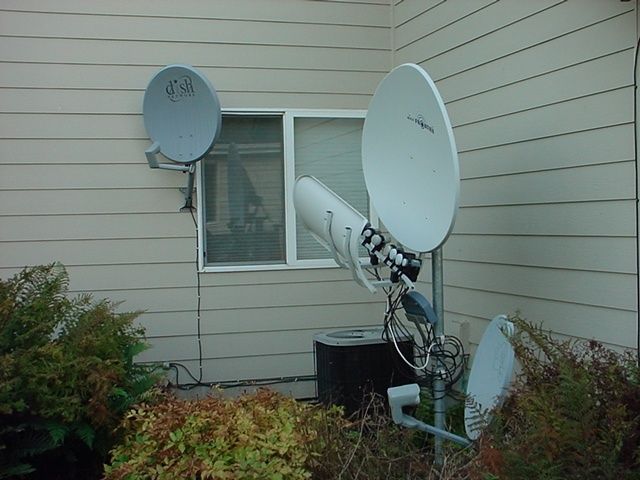

Update
I have now mounted the dish at the house. I added 129°W (G27) and 119°W (Echo 7) to the 123°/125° (G18/AMC21) co-joined mini-LNBs. Signal quality (Fortec Lifetime Ultra):
129 - 73%
125 - 85%
123 - 80%
119 - 99%
Pictures below, first pic of the new 1.2 meter followed by my T-90 and two dish network dishes. If a person wanted to have just one dish, the 1.2M dish with these four LNB's would give a very nice set of programs.
