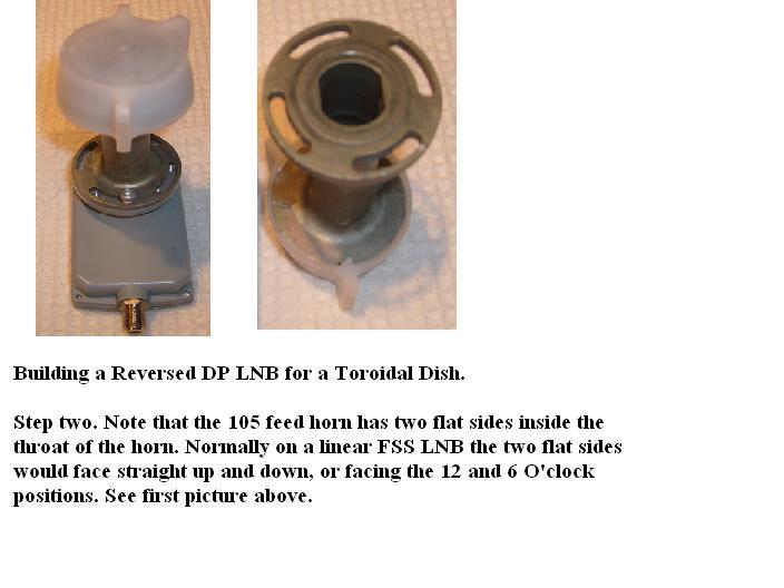

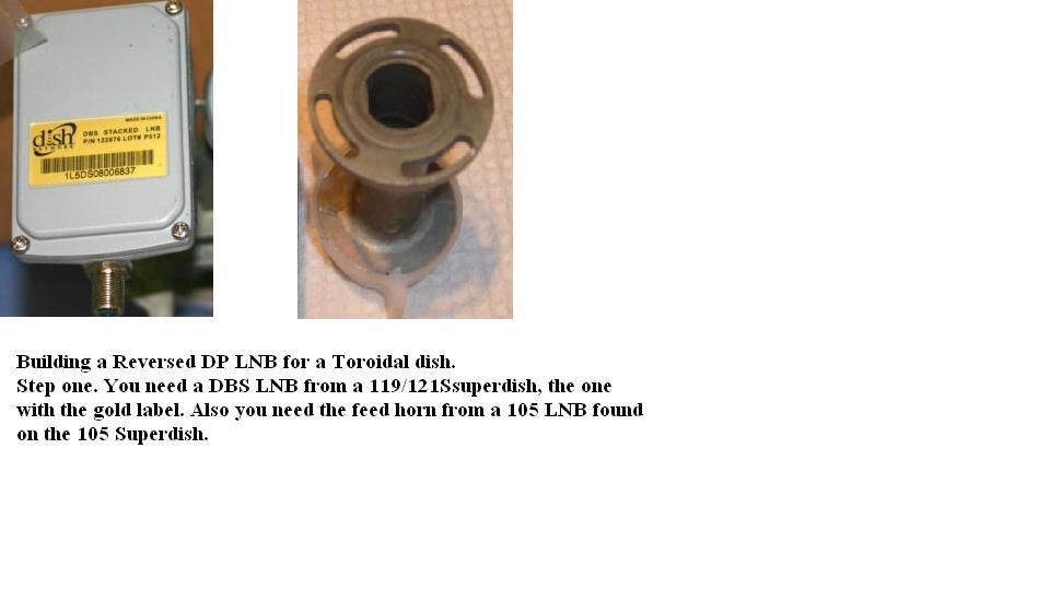

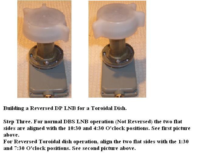

How to build with standard Dishnet lnb parts. If anyone is interested I will put together a "How To". Great for using the T90 with a Dishnet receiver.

I would like to see what you have done!
Bob
Thanks for asking wescope, I too wanted to know, and see what was done?
And jerryt, thanks for posting the pictures and directions. In the 2nd picture, I didn't understand, or at least I couldn't see what you were talking about with the 2 flat sides straight up and down? But, when looking at the 3rd picture and reading the instructions and seeing the flat sides in relation to 10:30-4:30 positions as opposed to 1:30- 7:30 positions. And then looking at the 2nd picture again, it all clicked. Thanks!
