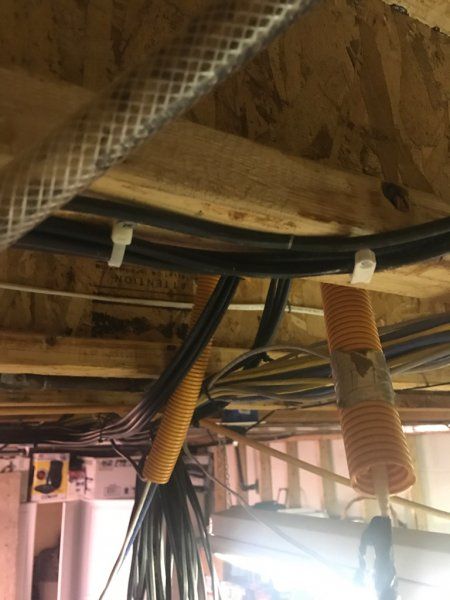

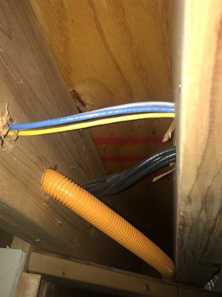

Why don't you just run all the wires now since the walls are open?
You can even install wires to the potential Dish location to avoid any wires on the outside of the house.
Reactions: dishrich
Be sure to also run cat6 also.
Also screw using wireless boxes. Run the wires now!

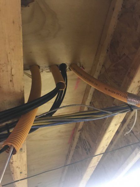

A good idea is to install conduit for future expansion.

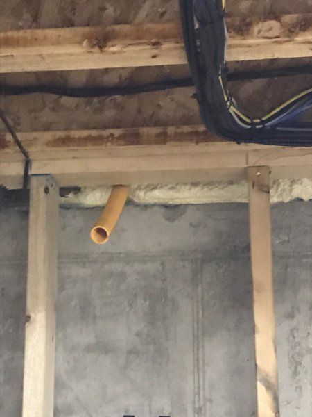

Now is the time to run wires while the walls are open.
I usually run RG6 and Cat6 to every room and have them end in a media box in an accessible closet or the garage with a power outlet at that termination point. From that termination point, I also run a couple RG6 and CAT6 to a box outside for the cable tv/internet/phone to come in on. I usually run one to the attic for an antenna and I run a couple outside to a box where I want the Dish and its connections to come in. I also have RG 6 out to my patio for a tv. Now is also the time to run speaker wire for rooms with Surround Sound or out to a patio.
This, I'd run Cat6 along RG6 cables to every room that you might think having a tv or internet like a laptop or computer or any streaming devices like Netflix/Roku/Amazon fire tv.

Run two coax (swept to 3 GHz) and at least two cat 6 to every room. Except the bathrooms, unless you like to soak and watch TV.
Yes, even the laundry room. Cost at this point is trivial.

Now is the time.
Get a good contractor to come and determine your best long term mounting location for LOS.
Now, while the walls are open get your coax from that mounting location to the inside to a central location where you can manage media connections.
I'd recommend 2 RG-6 coax and 2 CAT-6 per room as a minimum all to your central location be it garage or basement.
From your living room or master bedroom you might want to plan for a couple different room layouts.
You can always connect and disconnect your cables as needed.

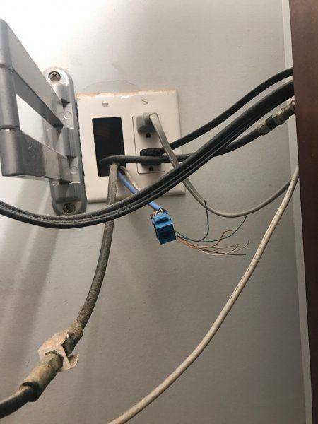

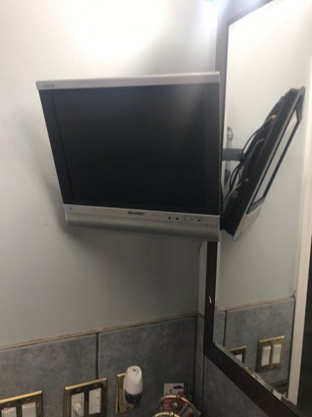

Yea I got 2 RG6 and cat5e run to my bathroom.
H25 tucked away in the medicine cabinet.
