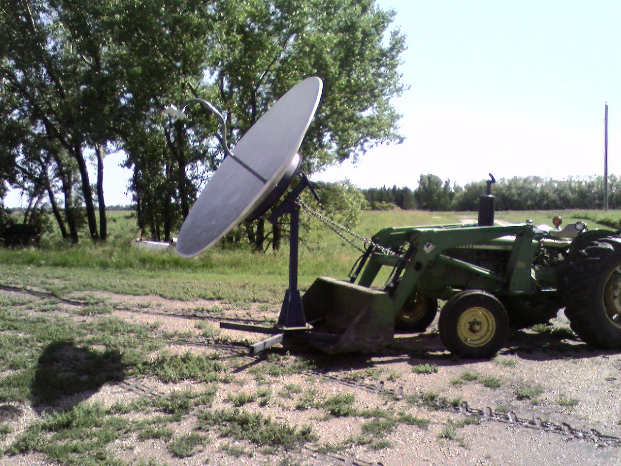

I use a tractor with a front-end loader...Often move the dish, mount, and supporting structure all at once!

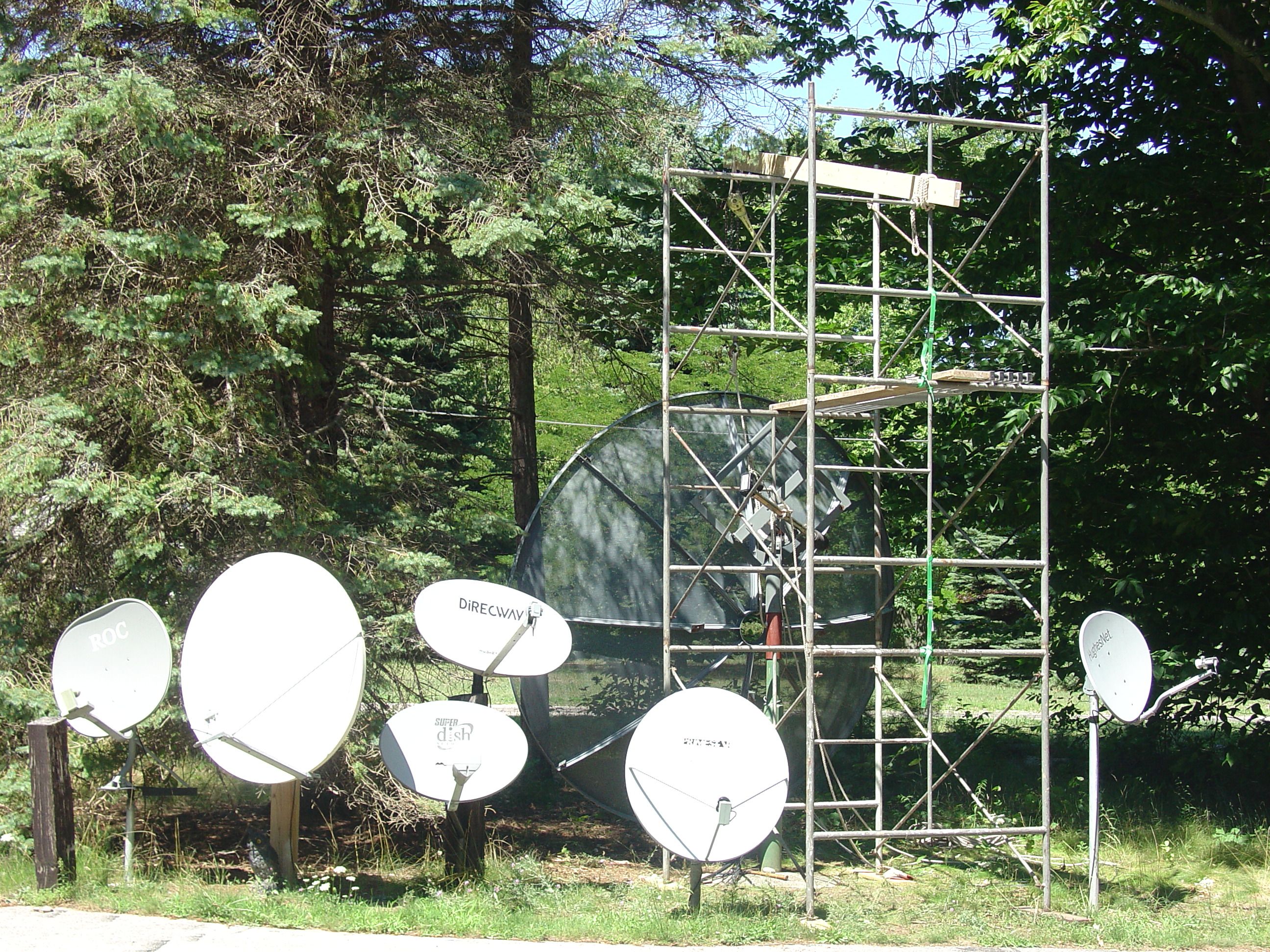

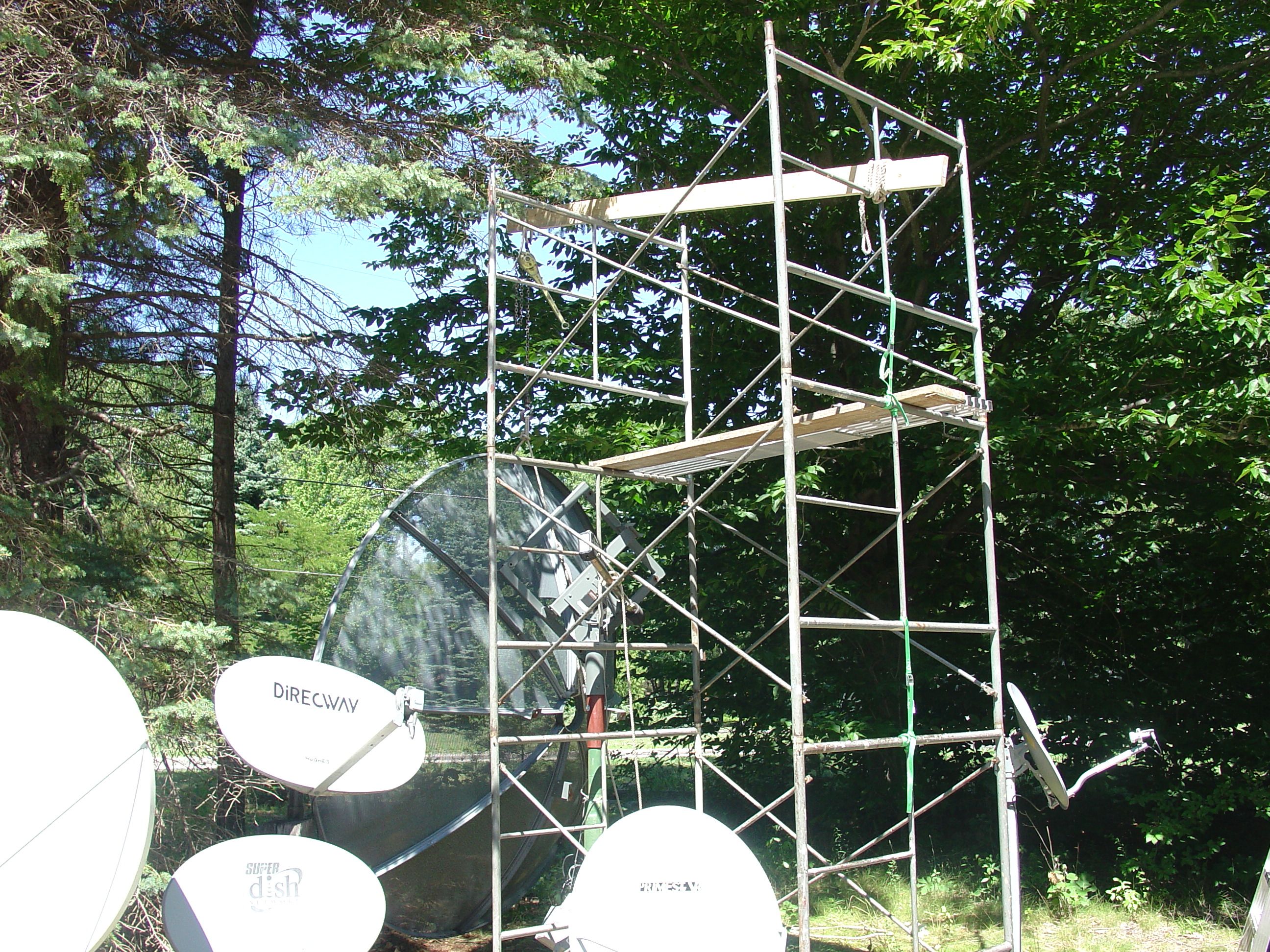

That's quite a lot of scaffolding there John, should work though. Make sure you tie the top of the scaffolding, opposite to where the dish is being lifted from, to a tree or something stationary as a counterpoise.
Be safe!
