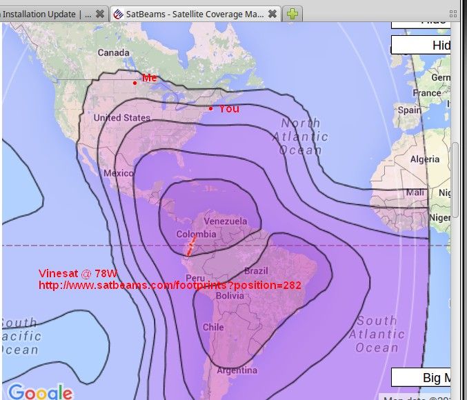

Well I'm getting that satellite and by the look of the footprint , 2nd cllickable, you're in it stronger.
The footprint looks to be only for South America.
John
I'm even closer to you John and I can get the 3885 transponder on 78w here in Central PA with a good signal on an 8' mesh. As Fat Air said, you should be able to get it. Make sure when you do your adjustments to do them very slowly in small increments and wait for the receiver to get a lock (can be as long as 10 seconds in some instances). Good luck! :)

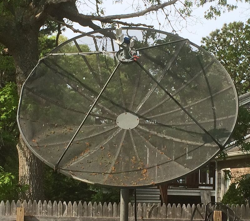

Hard to tell with out seeing. Keep at it you will get it!
Did you read all of FaT Air's BUD manual?
Maybe upload a few close up and backed off photos.

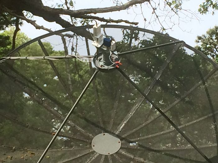

I'm including pictures of the dish pointing in the direction of 78W.
John

Not trying to muddy the water, but could it be that the polarity is out of whack? His vertical is actually horizontal? Just a thought I had looking at the last pictures.
Reactions: JFOK
Could be. That is what I meant by skew in an earlier post. I should have been more specific.

John, I can't really see too good in the pictures, but is there a DISEqC switch [or 22KHZ] in the setup anywhere? It looks like two LNBs on the feed there, but I can't be sure. Maybe a C and a Ku one?
If you're using a DISEqC switch and the port # isn't set right, it could be picking up the wrong LNB and still give the 45 signal. If there is a switch, bypass it and just run a cable straight to the C LNB for now.
