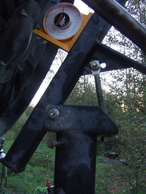

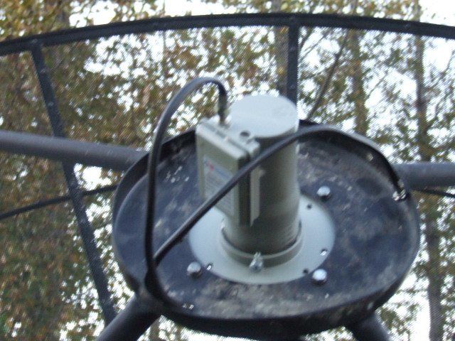

So here is a picture of the new LNBF. I measured the distance from the back of the scalar ring to the front of the LNB on the old integral chapparal. Then I measured the same on the new LNBF. I used an inclinometer to adjust the skew to horizontal or 0 degrees to the right. You can see there are two coax cables installed. One is a long one with one coupling splice in it that goes to the house. It is just over 150 feet long. The other is a short one piece coax cable for doing the initial dish setup with a portable TV next to the dish.

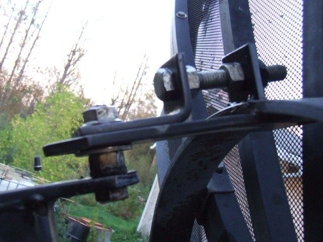

Attempting to set up the elevation here but I am bit confused. I read in one place where it said that the elevation should be set at your lattitude in degrees. I am at 55.7 degrees N lattitude so thats where it sets at the moment. The confusion comes in reading my customized dish aiming coordinate tables. I entered my location in satellite AV's geosatfinder and printed off the tables. I have a potential view of 57 satellites and the one directly south is 121.00 W Galaxy23/echostar9 The true azimuth is 179.2 degrees and the dish elevation is listed as 26.50 degrees. This seems far too low for the main elevation setting. ????????

Then there is the declination. Does anyone know what the declination is supposed to be at 55.7 North? How do you measure it? Where do I place the inclinometer?

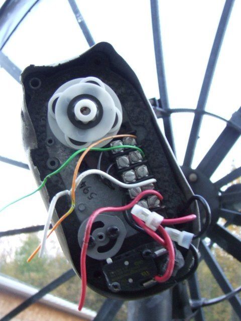

Finally the actuator is ready to be connected to the actuator control cable. I have put a splice in the old cables. I soldered the spliced wires and shrink wrapped them to hopefully exclude any moisture. Hoping it works. I have the red and black motor wires figured out but the green and brown? orange? Yellow? wire is puzzling. The wire is faded and is actually all three of the latter colors. The inside of the cover of the actuator motor case has the following notations
Brown-
Reed Sw
Brown-
Thats it. So is the wire brown or orange because I have both wires in the cable. What are the polarity of the sensor wire terminals? My V-box has red and black terminals for the two sensor wires.
It doesn't matter on the reed switch what color it is or what terminal you hook it to.Just as long as you have 2 wires coming from the switch hooked to the sensor terminals on the vbox.Just do NOT hook the reed switch to any power terminals,it is just a switch either open or closed.
If when you hook up the motor wires and the dish moves in the wrong direction,just swap the wires.
Oh and just to add it doesn't matter what color wires you use for the switch,just use the same 2 wires at BOTH ends.:D
