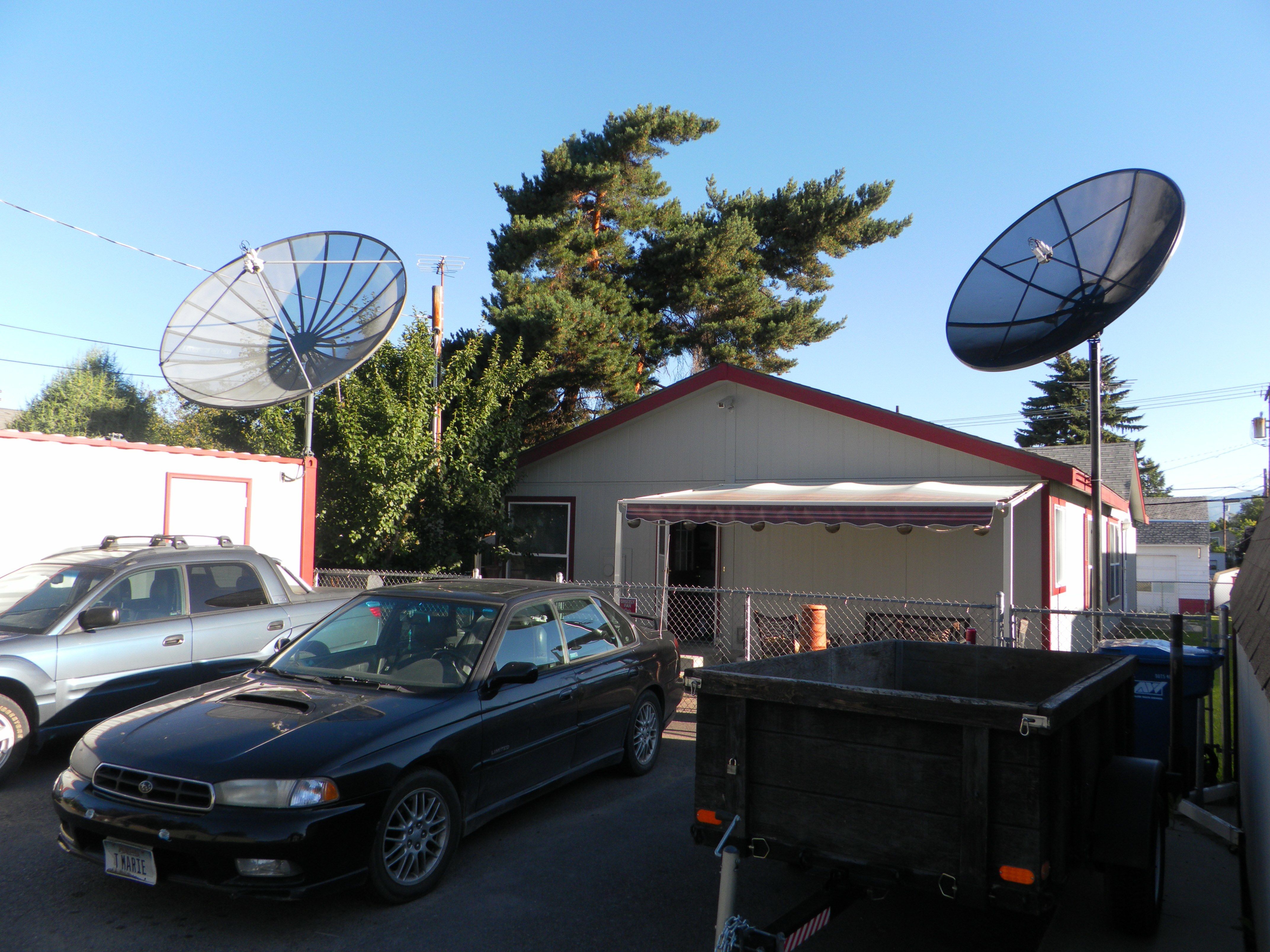

You have a 10 foot Orbitron mesh dish and a 10 foot Winegard Pinnacle perforated.
Which one would you install? And why?
(No room for both)
RT
I have both my Pinnacle and a 10' mesh dish up. I must admit the Pinnacle is dialed in better. :). I thought I could make the mesh dish better as it's not real deep (F/D.39), but so far the Winegard still beats it on both KU and C.
