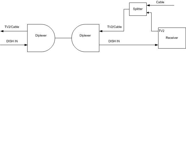

I have a similar setup to this, but can't get my TV's with the combined TV2/Cable to find digital cable channels. I have attached a sketch of my setup.
I have basic Comcast cable coming into the house (note that if I tap off of it directly, I get analog locals, digital locals, and HD locals which are also digital). When I run it into the back end of the splitter (I also use the notch filter that Digiblur described) and out through the diplexers/combiners, the TVs hooked to the TV2/Cable wire don't get all the channels. I get a couple of the HD channels, but miss some, and all the digital locals (200-250 digital) are gone.
The splitter is 5 - 2300 MHz, so that's not the issue. The TV2/Cable does feed into a 3-way splitter, but it's also rated with similar numbers.
Is it the diplexer that's causing the problem here? If so, I can always run a second wire, I just wanted to run it by you guys here to get your input.
Unless of course, there is a way to pull this off without running a second wire.
Your diagram leaves out the band stop filter.
Don't assume that cable channel numbers are interchangeable with digital channel numbers. They're typically all over the map just as digital TV channels are relative to the frequencies.
The diplexer is necessarily going to whack everything above 975MHz out of the cable signal. Then there's whatever gets whacked by the band stop filter.
Diplexing cable TV is an all-around bad idea as it is unpredictable and often dynamic.
Yeah, sorry about that, I have the same notch/band stop filter that Digiblur mentioned (blocks cable channels 75-80).
I think my next step will be checking what comes out of the reversed splitter, before the diplexer, and see what channels make it through. I'm convincing myself more and more that I'm gonna need to run a second wire and lose the diplexer.
