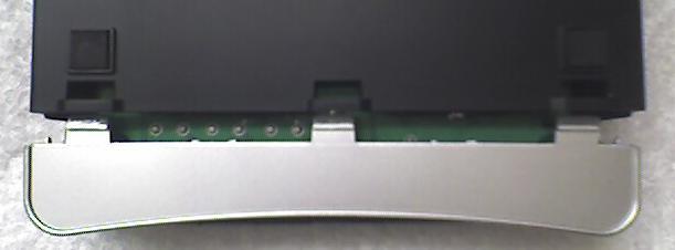

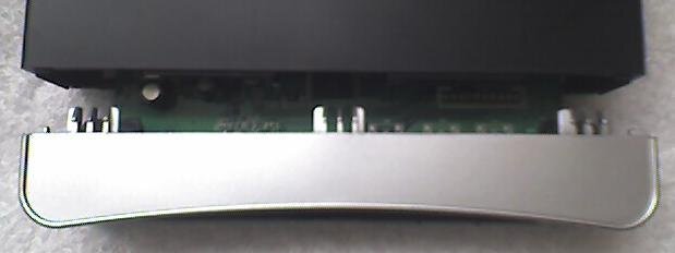

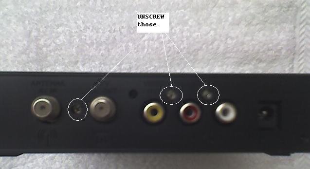

Please tell me how you removed the circuit board from the Venturer STB7766 Converter box without breaking the plastic cover. I ask you because you have posted alot of info on the parts used in the box.
Or if anyone else has opened up this box, feel free to contribute.
Just unscrew three screws on rear site, press/hold a three snaps at bottom and be sure other three latches at top didn't hold the cover - slide id toward rear side
