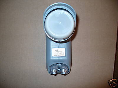

Just buy the same Bell LNB on ebay. Make sure it has two output ports.

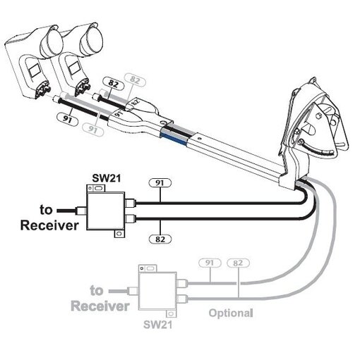

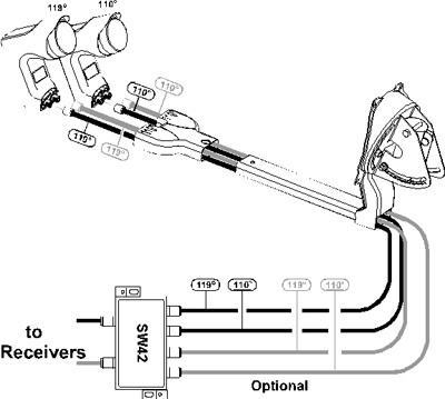

For the switches you can use two SW21's, or one SW42. Attached are some examples copied from hugh & Q. You can buy the switches on ebay as well. Just use the same "check switch" each time you change locations. I think the expansion port you are talking about is really a second output port which you will need to get both tuners working. For the lines on the 3rd attachment just replace 110W with 82W & 119W with 91W.

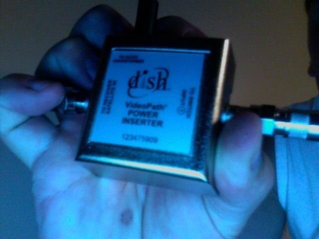

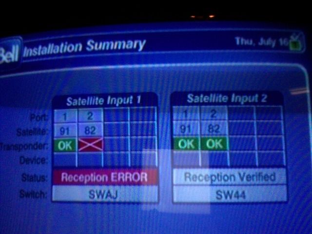

With slight embarrassment, I am having difficulty reconnecting my 9242 at home. The joys of having a teenager helping disconnect before labeling connections. Either my connections are wrong, or trees have grown in one week, or someone has moved my dish slightly. I have low signal strength and lose channels at times. After 30 minutes with a friendly CSA in London Ontario, I was transferred to a technical "expert" who seemed far away, liked to use the phrase "thats wonderful", and started with unplugging everything, despite my input. When I run Check switch, I get an error message where Sat 1 input Port #2 Sat 82 the transponder is X's. Status Reception ERROR. Switch: SWAJ. I have attached pictures of the error message and the equipment I have.

Ok, Power inserter in Port 1, Diplexer between Port 2 and wall, Check Switch reads OK, in all 4 boxes and strength good. Still no reception in 2nd TV. I know that the installer had trouble with 2nd TV, as we needed to use a VCR for a Tuner ... set to Ch 22 and I believe air. Any ideas?

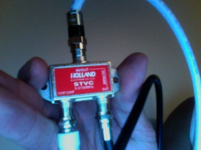

It turns out I was missing 1 cable. I connected it from the back of the PVR, the home distribution output, and connected it to the UHF/VHF input on the HOLLAND STVC Satellite Diplexer Signal Combiner and Splitter and presto....
