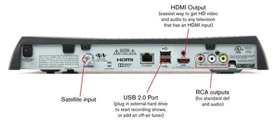

Short answer: yes.
The 211K has HDMI, Component, composite, and coaxial outputs, and all are active simultaneously. Now, the newer 211Z lacks the coaxial out (please correct me if that is not true).

The vip211z has HDMI and a composite output (yellow) not to be confused with component (red blue green) which is HD
