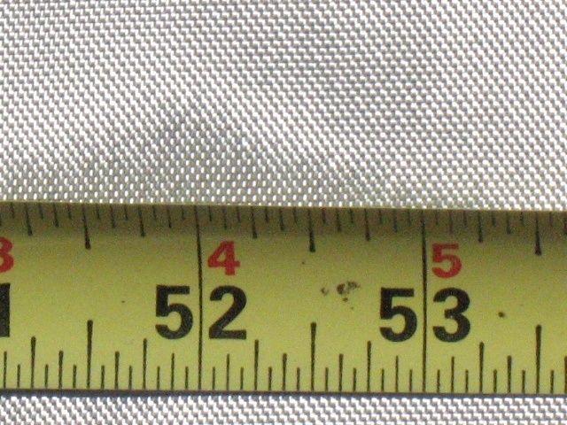

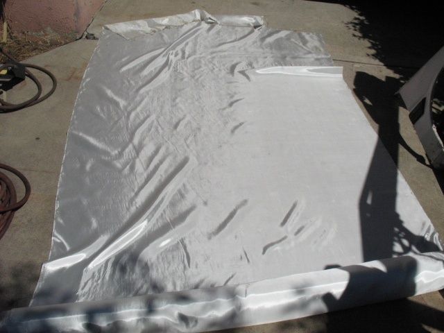

Here's a suggestion for your mesh dish: Very light glass cloth cut to fit & then spray resin to make it adhere to the mesh. I have some cloth here that is very tight weave, .007-.008" thick, 60" in width. I have at least 15 ft on the roll.
I got for free at work because it was too dated for Milspec.
If you'd like I could send a piece of the cloth to you in an envelope. PM your mailing address & I'll send the sample.:)
