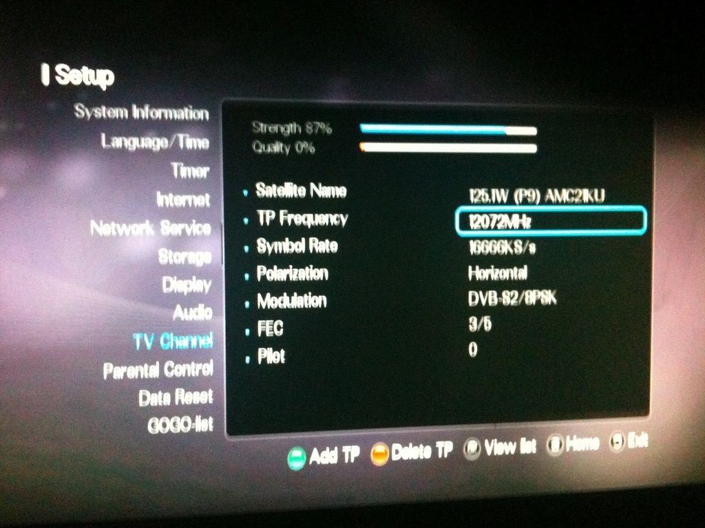

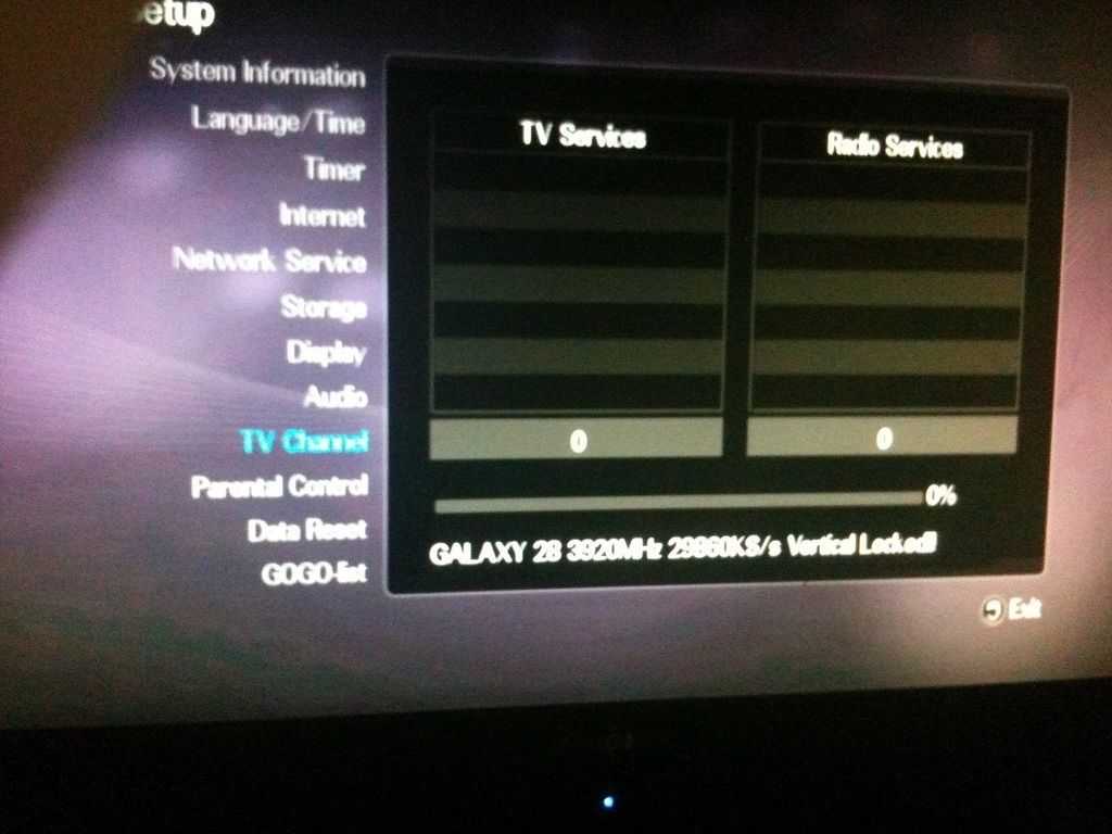

I have been trying for MONTHS now to get DVBS2/8PSK signals from my AZbox with no luck... I can pick up anything in DVB, or even standard DVBS2 such as TCT on G19. But I can't tune anything that is S2/8PSK.
On satellites where there are known S2/8PSK signals such as RTN, I can get everything on the bird, with signal of 100% and quality of around 70, yet I can't tune any of the S2/8PSK.
Even some of the networks on KU, I get a nice high signal and quality on the normal DVB channels, but NOTHING on the S2/8PSK transponders. Not a single peep. These KU ones should be coming in GREAT, my signal and quality on KU is higher then I ever had it on my other 1.2 meter KU Dish. The KU signals should be like cakewalk...
I don't get it...
Anyone have any of these issues with theirs? Should I do a factory reset to the box and try again? I have a 8 Foot C / KU Dish and again all other non 8PSK come in GREAT with high signals and quality, just not the 8PSK ones...
Any ideas?
My dish isn't align quite right, but I have no problem getting both PBS on S2 here in Eastern Ontario. Quality isn't as strong as on 12180, but it doesn't break out. Oklahoma is better than Luisiana for about 10 %.
Do you get any quality on them?
Yurek if you could PM me the settings for those 2 channels so I can try them, as I dont have them programmed in. And I will give them a shot. :)
Thanks!
LPB is at 12072 H 16666 3/5 FEC pilot OFF (so set to 0)
LPB Web
Nope can't get it... I can get all the other PBS stuff on that bird without issue.
Screen shots below.

I know LPB is wacky at night. I havent been able to get it here in MN at night.....
try tomorrow during the day

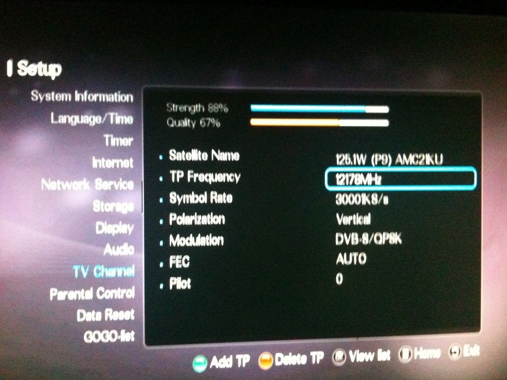

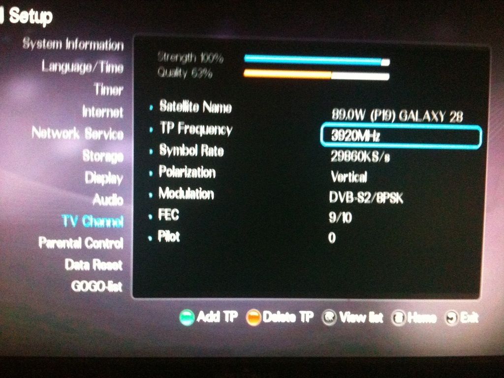

Well guys it's not the AZbox, it appears it is my Dish...
Thanks to cracklincrotch I was able to get signal from my first S2/8PSK signal tonight. :)
Unfortunately my level is 64 and I guess the AZbox needs a 65 to show a picture.
But not screwing with the dish now having a big snow and ice storm here.
I am just glad to know that its not the box. :D
I just wish one of you guys lived in the area so you could come check my dish as sometimes 4 eyes are better then two. :D :)
