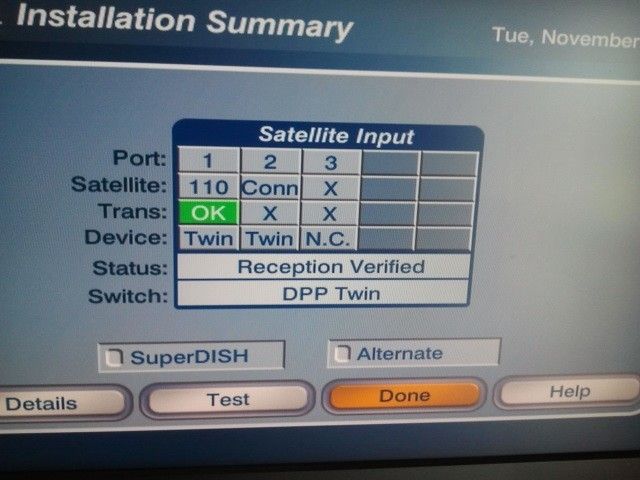

If you have a Dish Pro Plus Twin LNB like the picture you originally posted, you should not get a check switch that runs 30something checks. In my experience that usually indicates you have a bad connector, barrel connector, ground block, or cable somewhere between the receiver and LNB.
you will get 38 checks if it cant lock any satellites ;)
Not if his receiver is connected to a DPP lnbf. A DPP Twin "Check Switch" will allways do the "1 of 3", "2 of 3", "3 of 3" thing, it will just take longer to complete if it's aimed incorrectly. His symtoms indicate that the connection between the dish and the receiver has been compromised or he has a faulty piece of equipment.
2012-11-13 11.35.22.jpgthe dish is pointed south west at the moment and this is where we originally got t.v. This is what we picked up now.

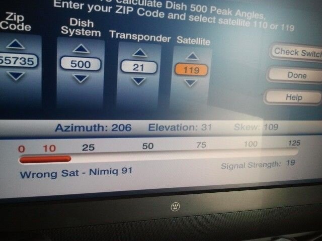

2012-11-13 11.54.02.jpgOk I lowered the dish from 48 and this is what I got! finally picked up 110. the strength is 50+. Is this enough to watch local? or do i need to find 119?? I'm not to sure how this stuff works.
Update: When I turned on the receiver it did the "acquiring signal" with the 5 green bars and that went by in 30 seconds and then it did the "downloading program guide" and after that it resets the receiver and starts that process all over again. If I go to menu and then program guide it gives me an error saying I should unplug my receiver for 10 seconds and try again.
The Dish500 only gets the 110/119 so you are all set. You only need 129 if you are going to watch HD programming. But, you need a dish1000 for that.
