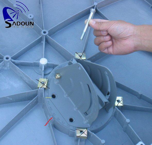

For some reason The skew doesn't have that line to stop the number, also do the skew is matter as far to get a satellite, my Globecast dish have never used for 1 year and Months so i don't know if the lnb will stop working because of that Hope not It's a bring new dish. when i plug it to the receiver i get the S but the skew not moving at all no numbers at least
Yes, the skew needs to be set or you may not get a signal. Since Globecast told you to skew dish to 120 that's what you need to do. I'm attaching a pic of the globecast dish with a yellow line showing where 120 degrees is, a red line showing where the referance line is. The 4 black x's are the bolts. Losen the bolts, rotate the dish so the 120 degree mark lines up with the red referance line, and retighten the 4 bolts.

OK THANK U I WILL TRY BUT WHY 120 NOT ON THE RED LINE AND HOW COME MINE DOESN'T HAVE IT NO LINE

That yellow line you show me is that where i have to put any other shew number there in case i am looking for other sat i am just asking i just want to have and idea for the future

also, in the pic above the red line is where 90 lines up. It may not be red but should show the indent
No its not red on your dish it is just a line moulded into the dish. It is the reference line because whatever numbered line on the inside lines up with the reference line is the skew of the dish. That dish says 90 when it has 0 skew. If the skew you need is 30 than it is 90 +30= 120. if you aim at a different sat and it tells you to skew -20 for example than it would be 90+(-20)=70.
