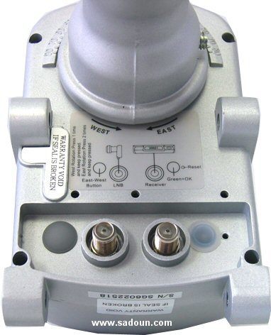

As far as reseting the motor goes, this motor has the little hole right beside one of the buttons, but the only thing there is the LED, I actaully pulled the button cover off to look. My Skywalker motor is identical from the outside but has the has an actual reset switch by the little hole and the sticker tells you how to reset it.
On this SG-2100 the sticker only says the status LED is in the hole and doesn't mention the reset at all. The manual doesn't talk about this either. Neither can I go the "0" by pushing both buttons at the same time like the Skywalker motor does.

on my SG2100 there is a pinhole for the reset and only one button for manual tuning
press button and hold for one direction or press, let go, repress within a second for the other direction. Had to manually move the dish when I was cleaning the snow around it the other day :)
The pinhole is sometimes partially covered up by the LED cover. It is there, just next to the LED. A straightened paper clip will do the trick nicely. Hold it there until the LED stops flashing yellow/green and goes back to green again.

As far as reseting goes, I contacted DMSI and they tell me this is the new version of the motor. And I found the "Hardware Reset" intructions as per manual (in case someone else has the same motor):
A. Cut off the power for motor
B. Press both of EAST/WEST bottons at the same time, then, turn on the power of the motor. LED - Orange blinking & stop, memory erased. You can get the original Software System.
C. Reprogram For the desired satellite.

Here is a picture of the Digipower SG2100 motor. There is only one button (the gray one on the left) that controls East/West. The reset switch is in the hole to the right of the clear LED cover on the right.
