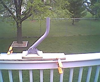

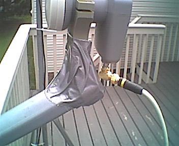

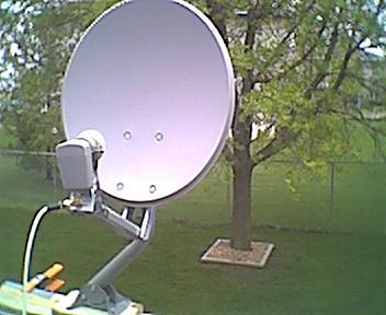

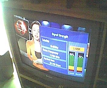

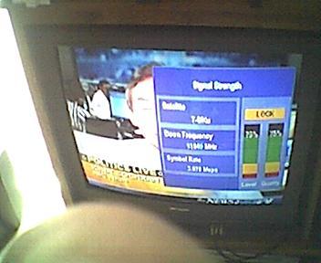

yes it can be done on a 18" dish...I done it before (and the pics below are to prove it)
The CCTV9 is in English and has documentaries but does have news too but as noted, its government run

now here in Minnesota its just off my true south (of 93W) so in Kentucky you will have to skew the LNB...skew on a smaller dish is CRITICAL!

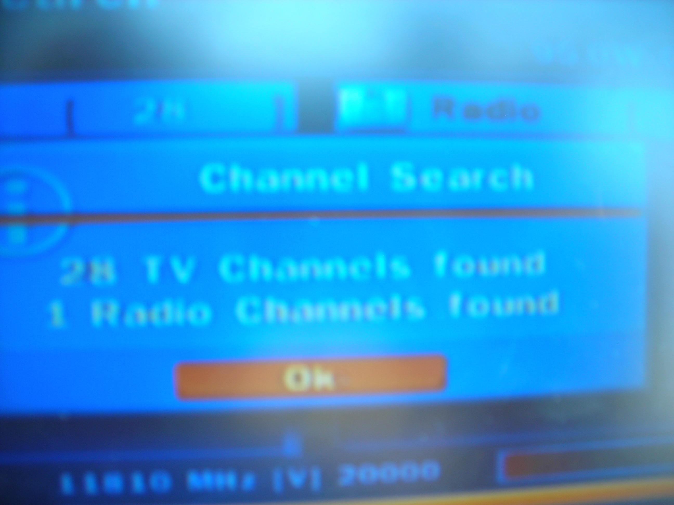

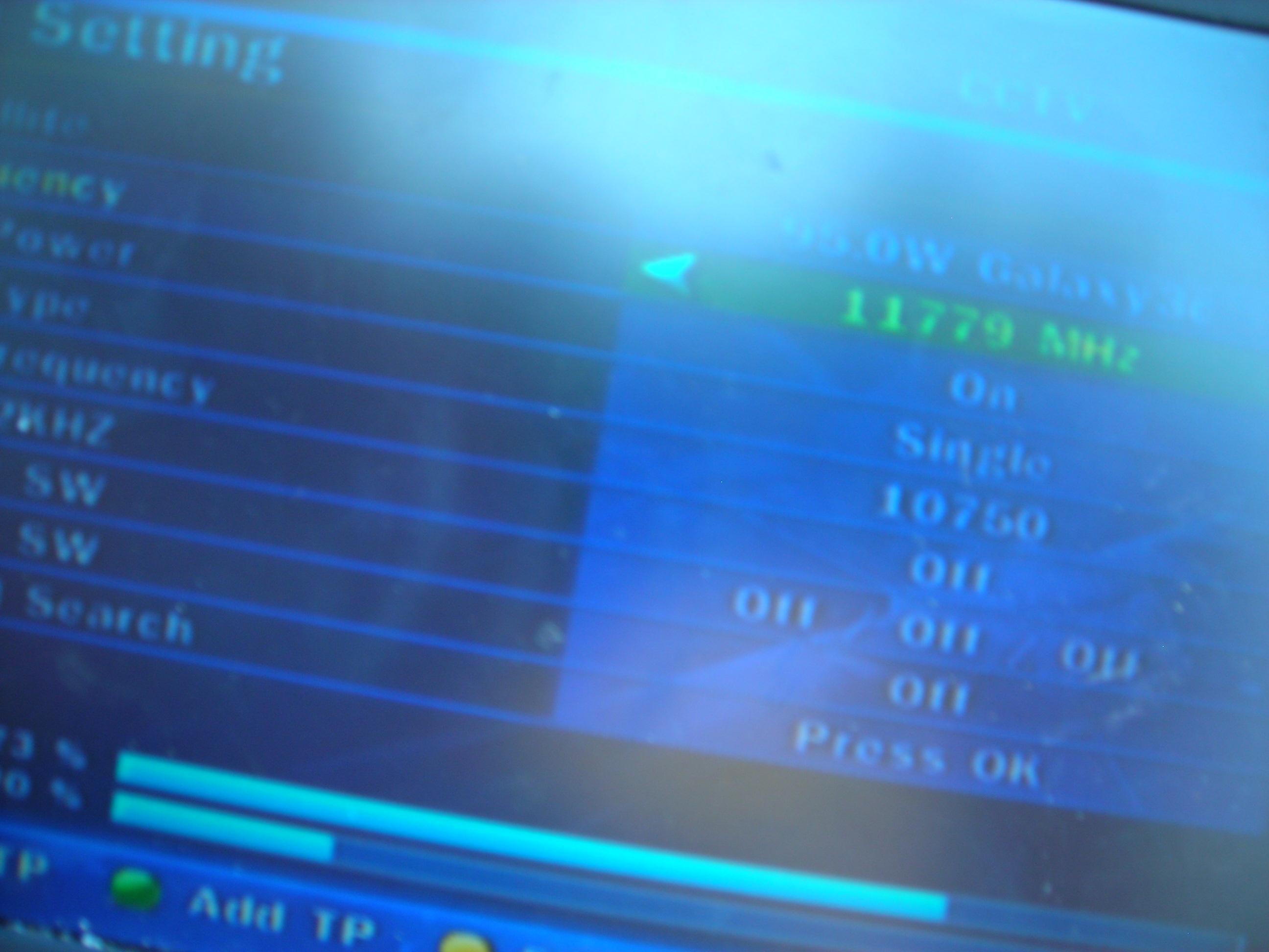

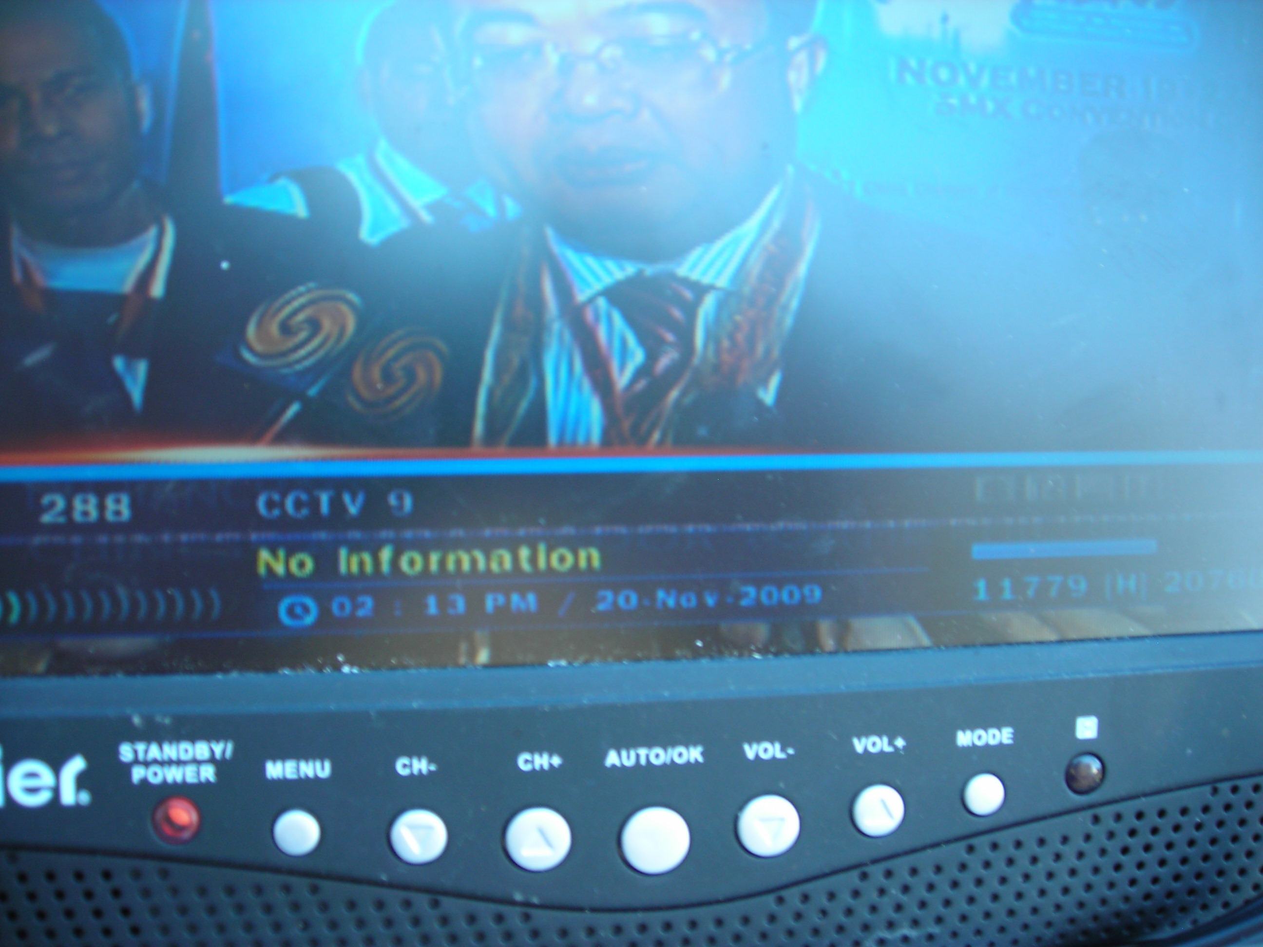

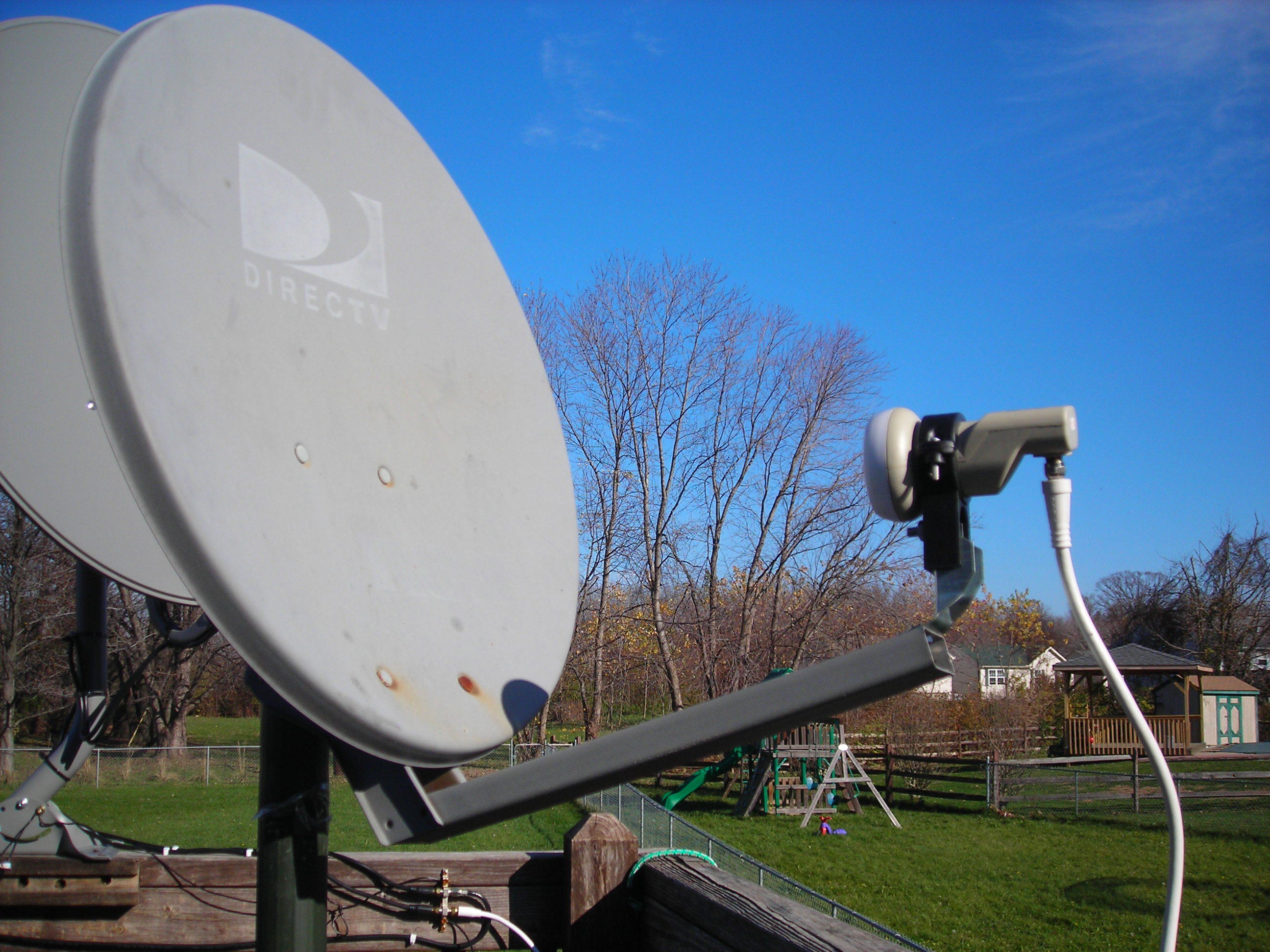

I did it, CCTV on a 18" Old Direct TV Dish with a Linear FTA LNB. The quality signals seem low. But the signals are stable. The LNB is a Orion, which has always read low no matter what kind of dish I put it on. I probably have to fool with the skew some more too.
I got all the CCTV channels with no problem. There were other channels but were encrypted.

Bill
try skewing the LNB a little. Looks like its almost set to 0 skew which in Kentucky would be off by 10 degrees or so
stand in front of the dish and turn it clockwise a little bit
Looks good otherwise :)
Bill

If you dont skew it on a 30" dish it will hinder the signal a little bit
Dont skew it on a 18" and it is really hindered....that signal should go up some when you skew it correctly
