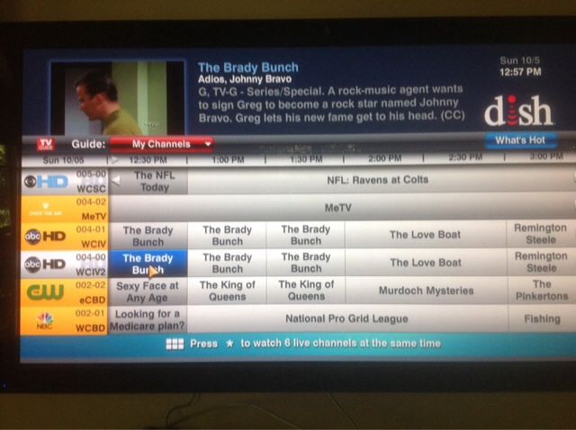

The guide has always been correct but yesterday I rescanned for locals, when it was done and I saved, the guide on the main channel both over satellite and OTA was wrong. It now shows guide data for the sub channel 4.2 the ME TV channel when it should be the main network ABC channel. What is funny is that prior to me rescanning the ME TV sub channel always showed "digital service" so I had to use manual timers to record shows on 4.2 which was a pain.
I have tried everything to fix. Red button reset, unplug the hopper. This last time I disconnected the dish and ran check switch when error of no signal showed I reconnected the dish and reset. The
new guide data downloaded after about 10 minutes but it is still the same. What gives, need help.

Ok I get it, right now both 36.2 and mapped down 4 on the guide show the network feed. When will Dish catch up? Right now there is no accurate guide data on either channel. 36.2 is showing "WCIV" in the guide all all day and the mapped down sat channel shows ME. Frustrating.

You're a genius Hall! People are complaining on Facebook. Seems they uploaded the wrong programming and it is affecting cable systems as well. They are working on it.
Fixed as of last night. Station put out wrong guide which got picked up by all subscribers
