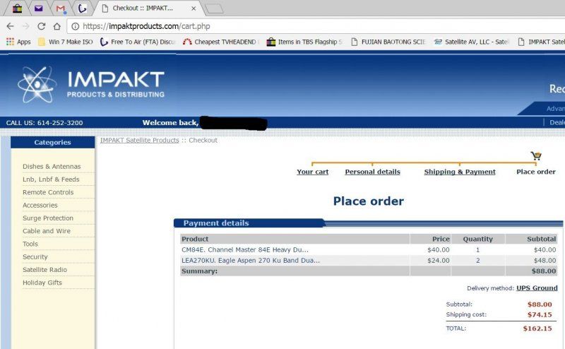

Impakt Order
So, do I need two Aspens 270's like whats in this picture? Also do I need anything else to set this dish up?

It comes with a two section pole, but no mount. The lower part of the pole seems to be made to bury in cement. I just bolted mine to a NPRM, and added a muffler clamp and two pieces of 1/2" conduit as braces between muffler clamp and NPRM. It's a really nice dish! Just pick two of your favorite satellites that are 6 degrees apart to aim at and you're good to go! :)

If your going to spend $162 I would almost just pay an extra $85 and get a geosatpro 120cm dish :)
Both dish's CM 84E and GS 90cm are good choices in my mind.
