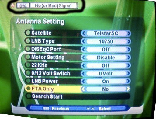

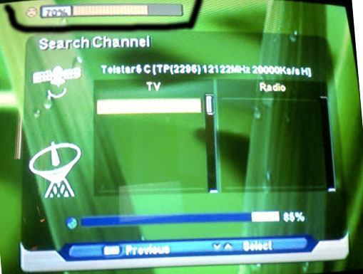

Sorry for double post, but I've noticed something when I was trying to look for channels. In the antenna settings when I did everything the signal is 0%, but however when I search for the channels the signal is 70%, still the search fails. I have different receiver too, and I got the antenna settings from there, yet that receiver finds everything but this one doesn't.
P.S. I attached 2 images, my antenna settings and when I search.

For one thing>you have a c-band sat selected, and are searching KU freq's. That says Telstar 5-C, and has a 4digit# showing as the transponder freq it was searching. Try to select a KU band satellite in your setup menu there, where the correct freq range is selected , 11700-12200 for linear ku . (UNless you are using a big c-band dish, and you ARE trying to search c-band)

So I selected the satellite Telstart5KU, and added the needed transponder, but still I get the 0% signal. In the menu I added Galaxy 19 satellite and added the same settings. This time in the antenna settings I receive 50% signal instead of 0%. When I search the signal goes up to 60-70, but however the search still fails. Am I on the right track or no?
P.S. although I added Telestar 5KU it still searches for 4digit number. I have no access to change that manually. Is there any other way to change that?
Does it have any North American satellites in its memory? You should be able to look at the transponder list for each satellite (most will have a few tps stored under each sat, some rec don't) . If you're selecting 10750 for your LO, and you have a ku lnbf and a ku dish aimed at a ku satellite, you should get ku frequencies. Now , are you sure your dish is aimed at an active satellite?
