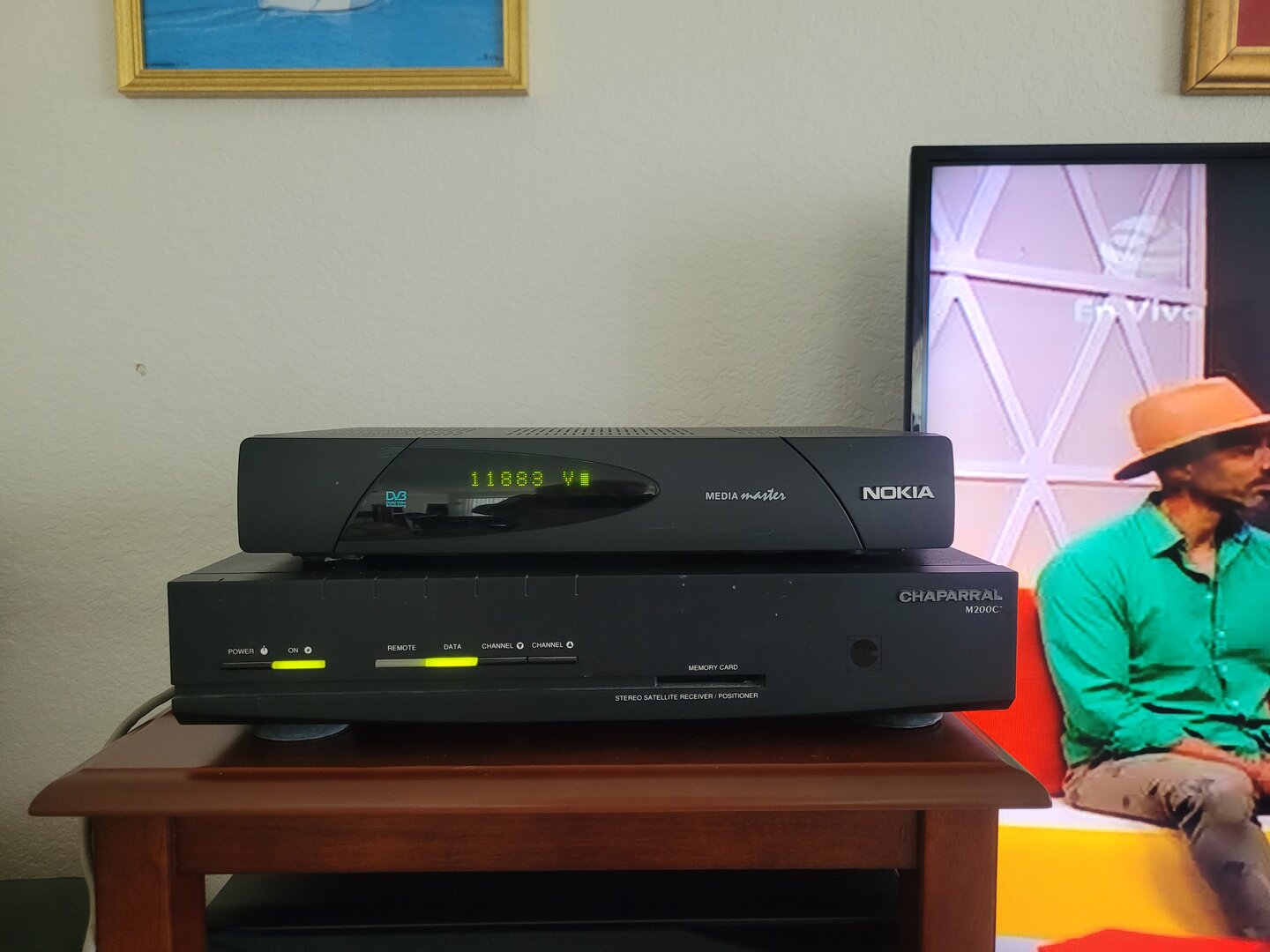

Thanks for posting the 100C manual, I just found my 200C and spent a couple days updating it as a positioner for my fta horizon to horizon ku dish setup (P* dish with Eagle H2H mount.). I had no issues adding and renaming all the new fta satellites from 30west to 139 west. (did have to erase some old preset analog channels on a few satellites to make room). Anyone know of a source for the 100C control software that you can use through the rs232 serial link ?

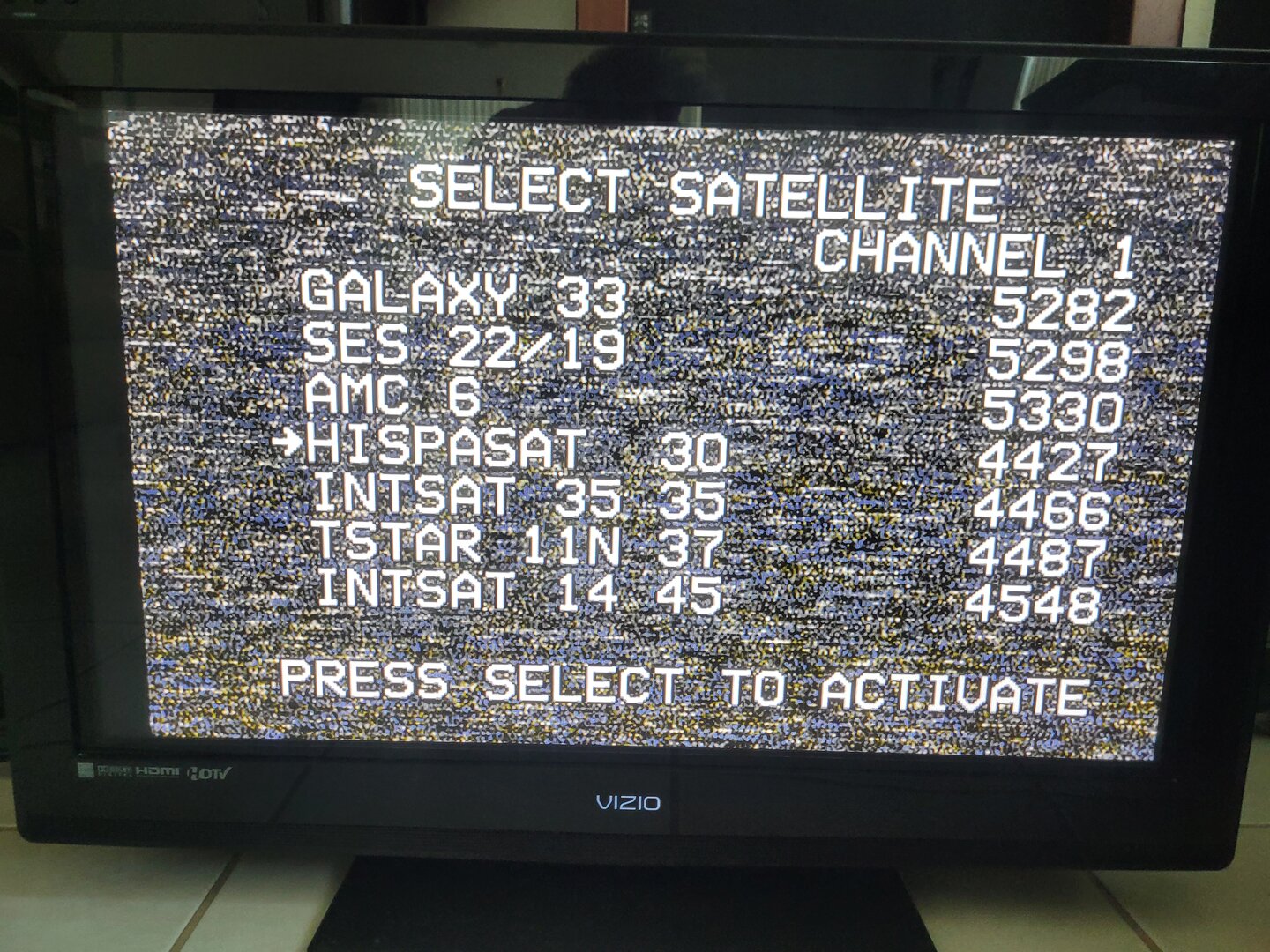

To add new satellites to the 100C/200C (if using as a positioner) just take an existing satellite position and then press Menu 1 - use the east west keys to move to a new position, and then press Cancel on remote. A dialogue will pop up and instead of hitting the enter key to store the new position for the current satellite, press the Satellite key on remote and a new Satellite is automatically created. you can then rename it in Menu 4 etc...
For those still using the M100/115/200C as positioners, if I can find the database manager software (DBM) to download the satellite list, I'll happily share the new 2023 satellite database that I manually created (positions from 30 west to 139 west).
HTH
HTH
