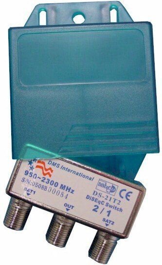

The DMSi DiSEqC switch comes with a cover (see below)
One trick that REALLY helps is to make sure to have the switch sitting horizontally this helps keep the water out. The DMSi switch I have been using has no cover but does have dielectric grease in all connections.

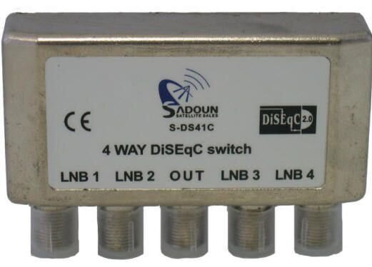

Good idea. I have a few different brands of switches from receivers I have purchased. I do like that model where all the ports are on one side. All of my 4 way ones have 3 on one side and 2 on the other. Makes it a pain when running cables (have to contort 2 cables to get to those connections)
