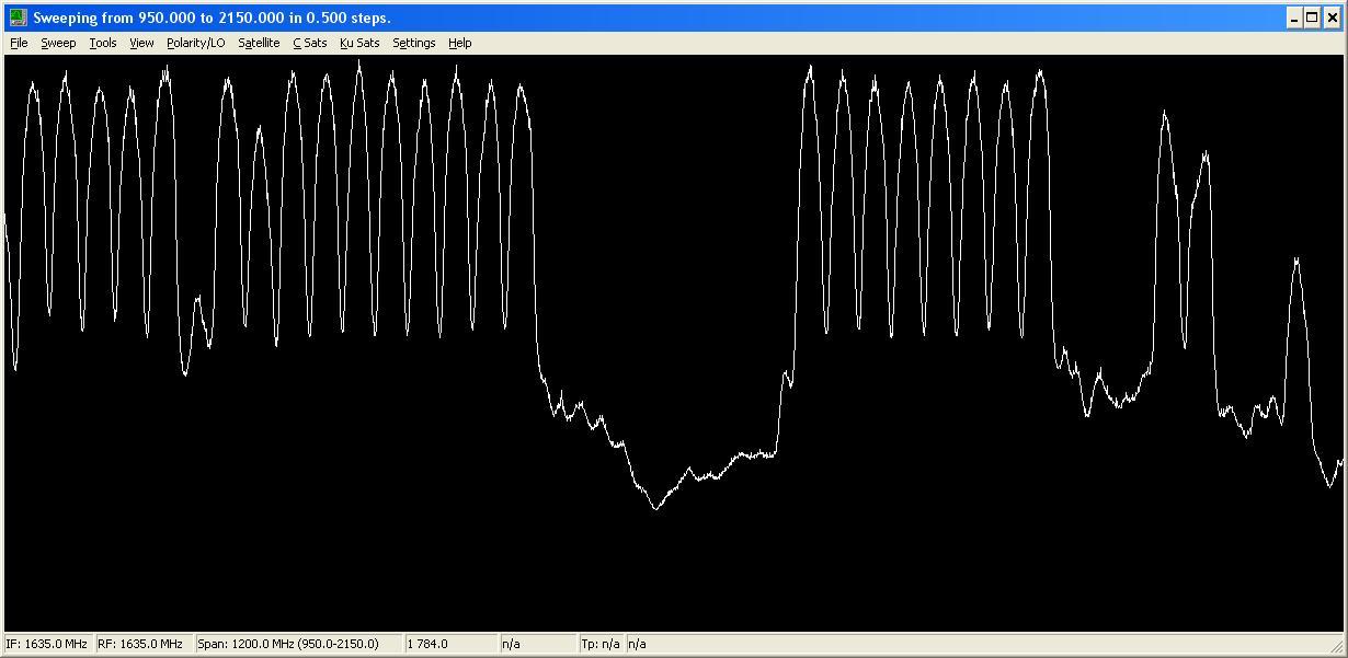

A lot of tpns come back - told yeah I've seen today low levels, but now it come to high. Picture taken right now.

Little shorter period - 1:18pm 2/11 to 7:35am 2/12; that missing interval didn't show any changes.
A lot of odd tpns has been turned on at 1:29pm 2/11.
