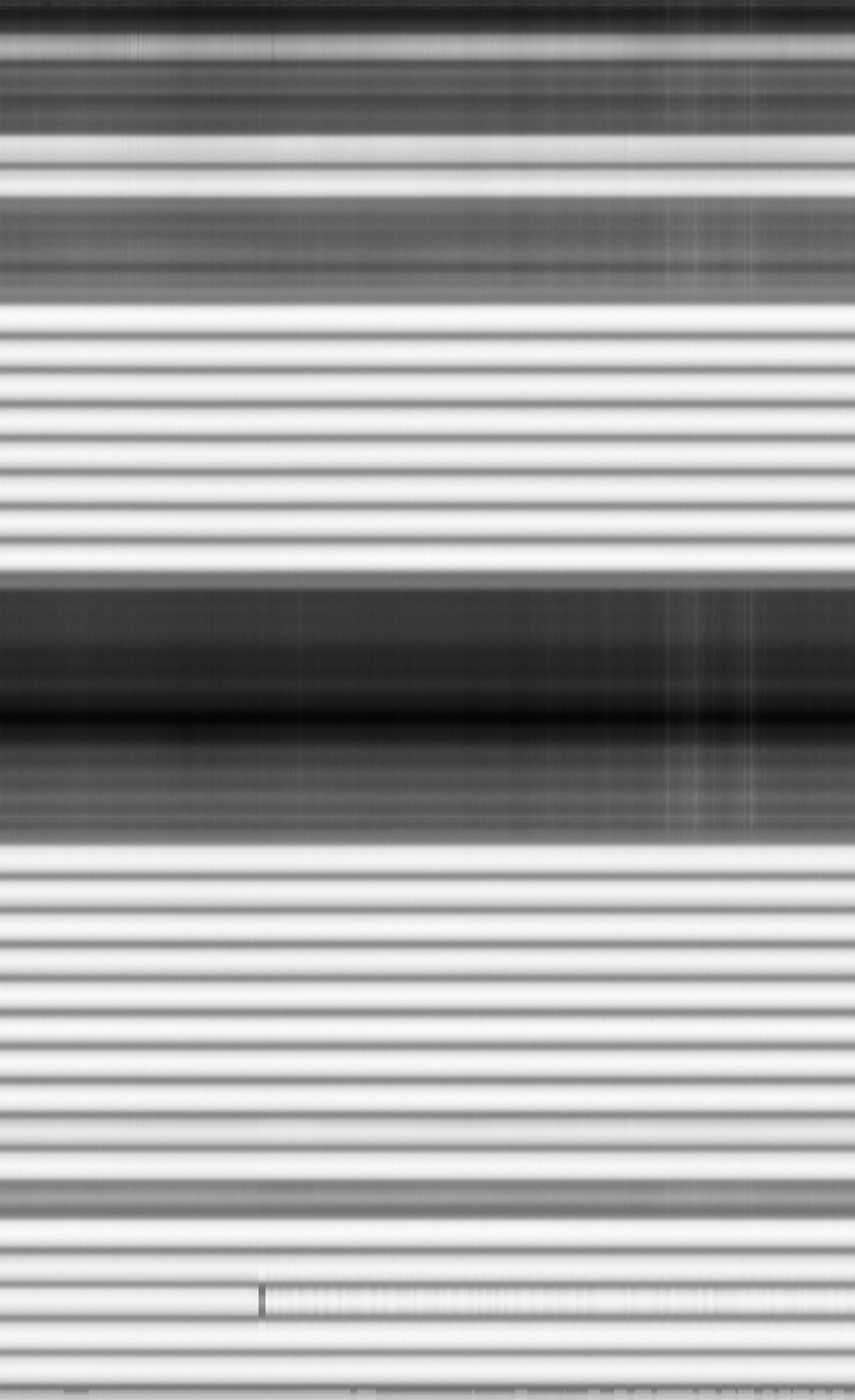

Looks like tp5 returned to E5 at 3:14pm 2/11 - see that gap after 3:04pm 2/11, signal show same jitter as before Ciel-2 now.
I can see the tp5 mux with 53% SQ and 95% SS.

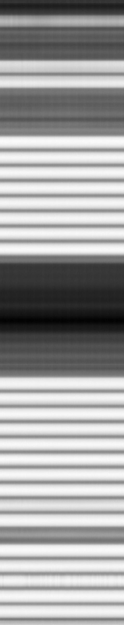

Just check on that picture after that spot at 3:04pm, then look for same tp5 on old scans. By other reports it looks as a CONUS tpn with old parameters now.

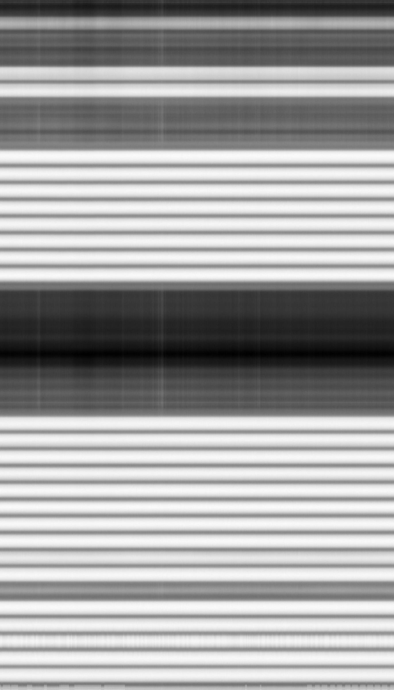

I lost four days BLSA's graph due a storm - power outage happened yesterday.
Got only last 8 hours: 11:43pm 2/17 to 7:31am 2/18; last night that tp5 [TID 405] did lost signal for 5 second after 12:20:53 am and still running on E5.
