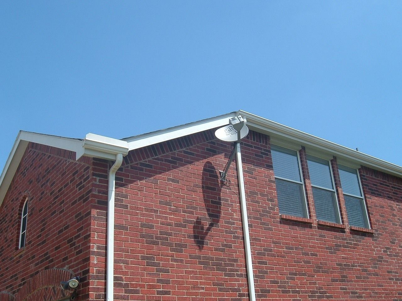

No Trees
Brick is good!

nice pic #18
my setup is a dish 500 with a wing 500 for 129 both on pole in ground.
