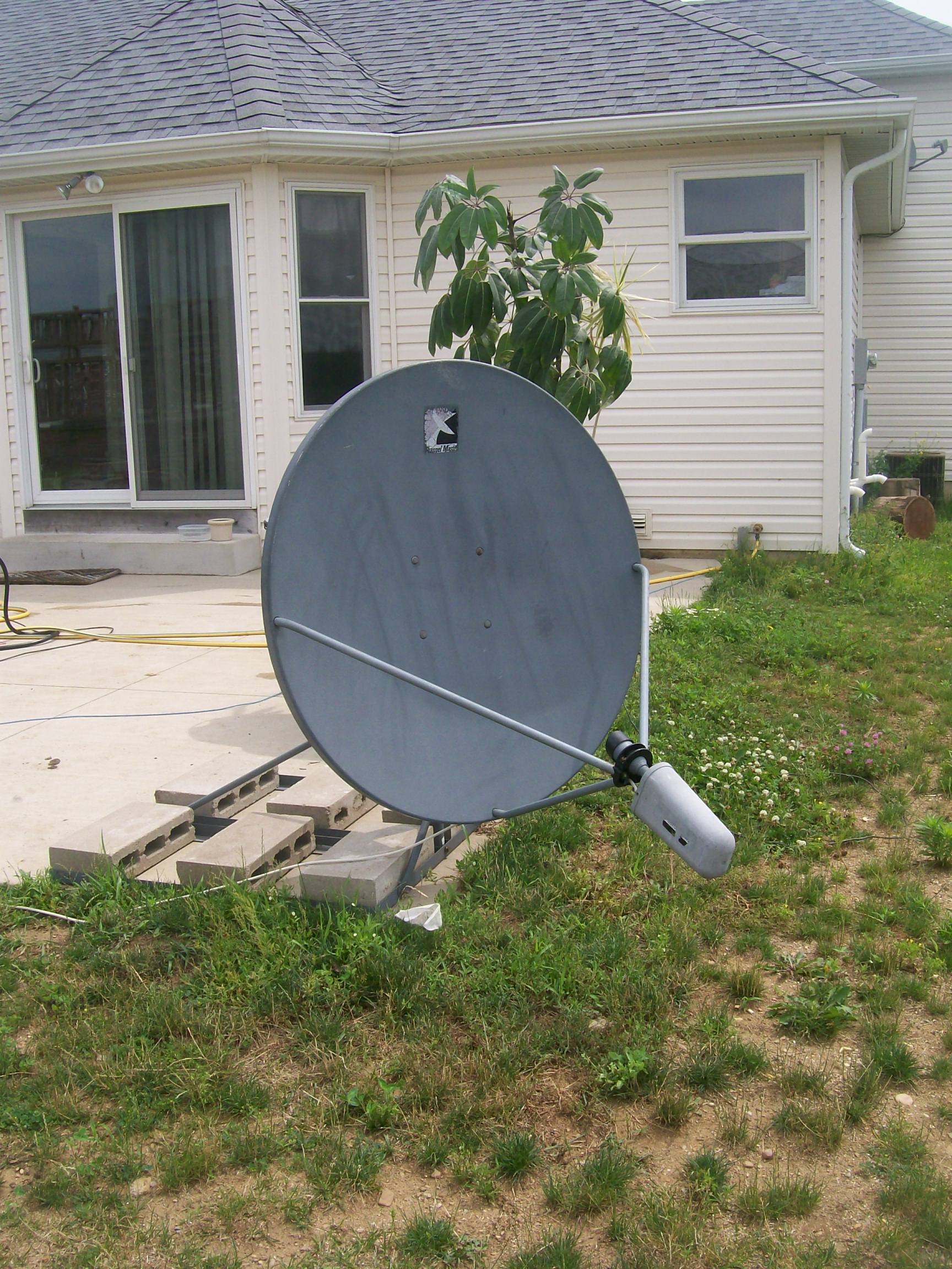

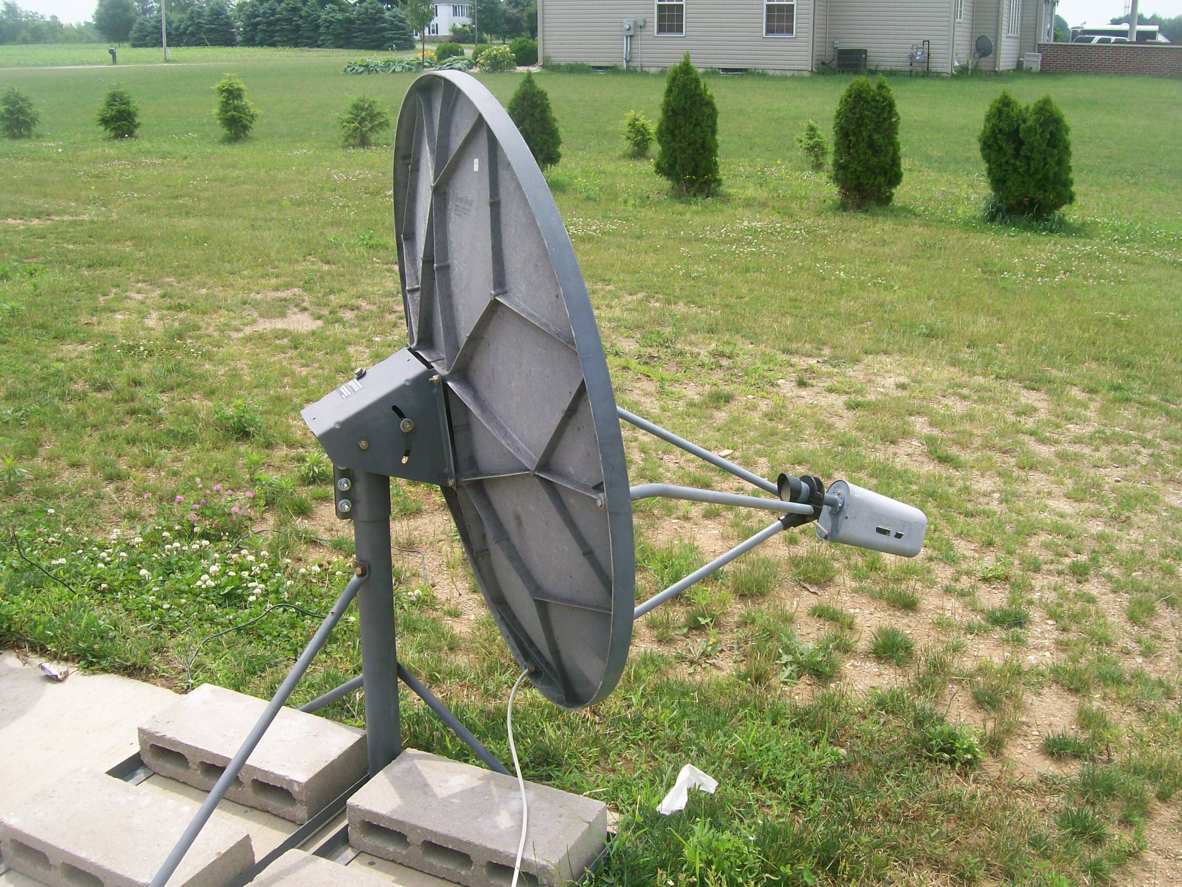

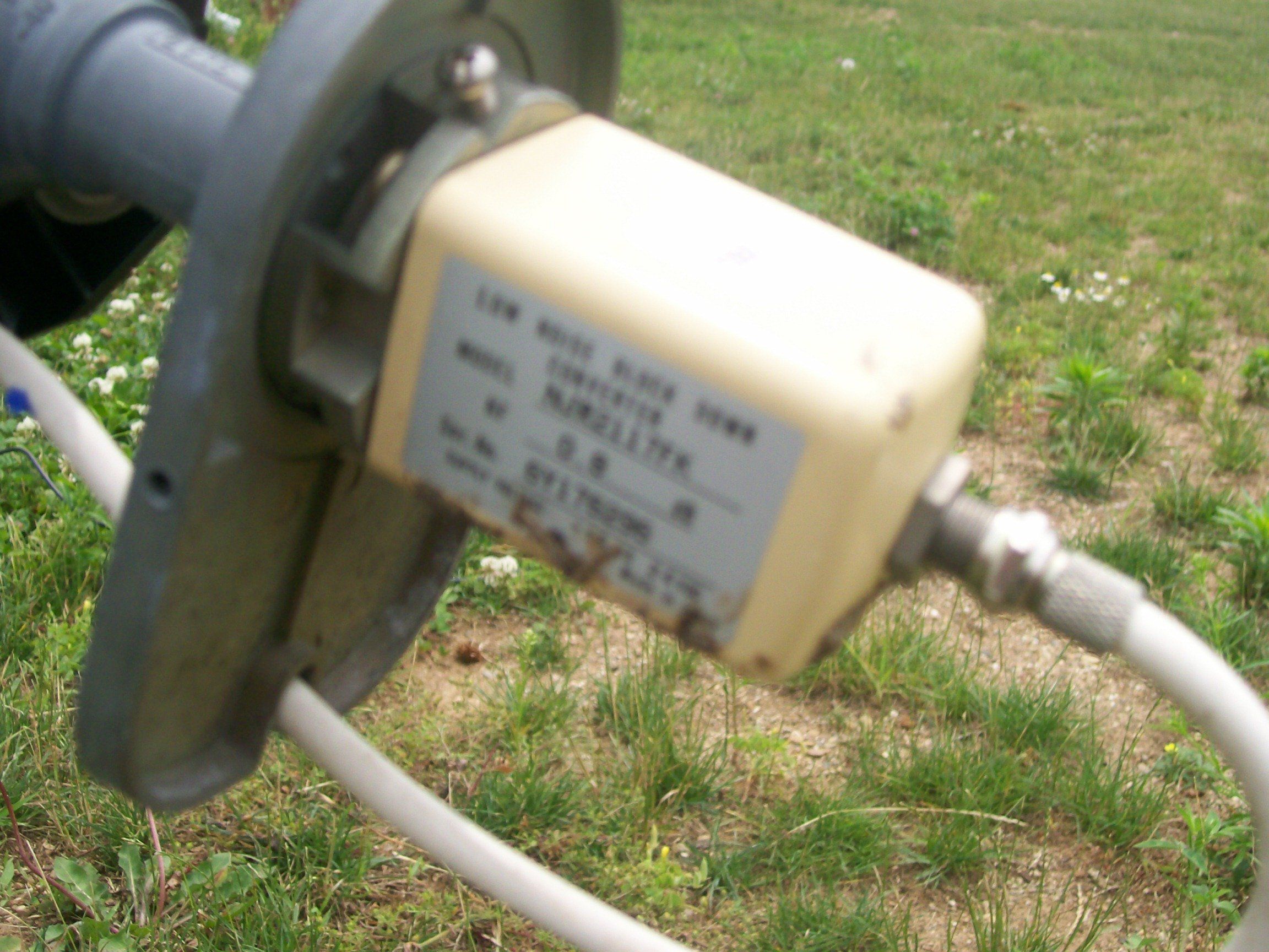

I dug a 1 meter Channel Master dish out of the trash at Menards. It still worked fine, I was using it on Galaxy 25 for music choice until they scrambled it. I want to get a circular LNB on it, but I still want it to look original. I took off the LNB lens and put it on a 105 Superdish LNB. It fit together perfectly. I was just looking at a 121 superdish LNB setup. The circular LNB for 119.0W on the 121 superdish looks pretty close to an FSS LNB on a 105 superdish. Would this work?

Give it a shot. I had some regular circular lnb's on my 1m dishes for awhile, takes a bit of work to get the spacing right, but it works. I found the 1m dishes have a smaller 'sweet spot' than the oval type dishes, but it can be done. Let us know how you do!
