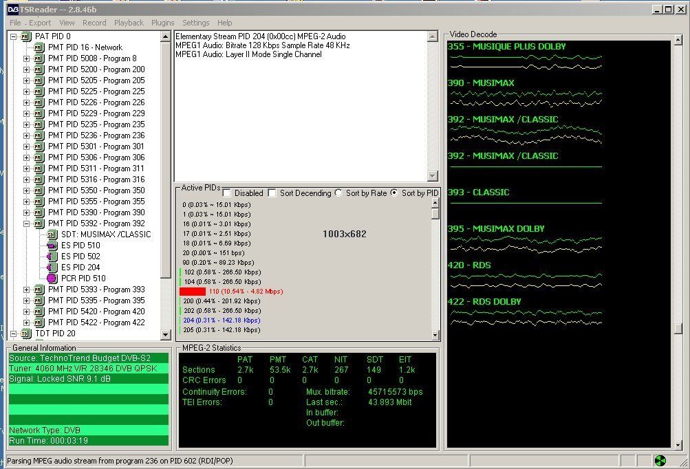

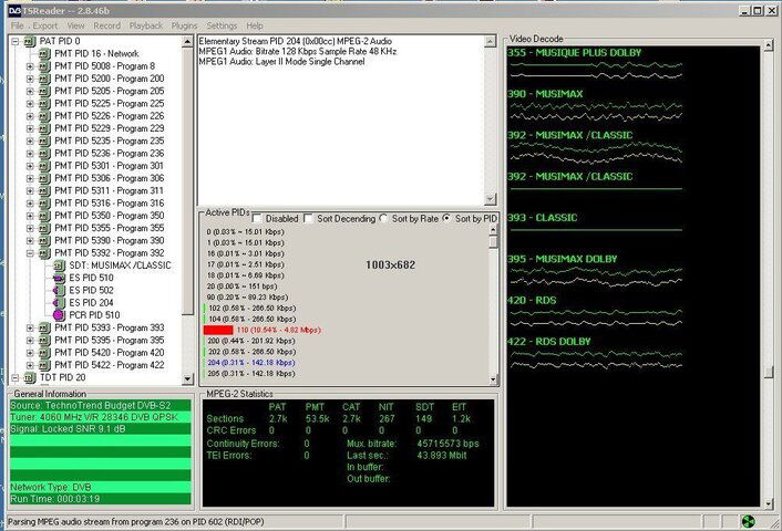

It looks like there is simply no audio there. I pulled it up with TSREADER, and that PID is just sending out dead air it seems.... or at least TSREADER can't read it. I've attached a screenshot of TSREADER, and you can see that the main audio channel from ch 392 is showing audio over at the right, but the 2nd channel, which is 204, is blank.
I guess it's also possible that it is mis-labeled as being mpeg.
Not sure how my attachment went up on top??
EDIT: I take back what I said above..... I just looked at that PID with a binary editor, and it sure looks like there is real changing data there. So maybe it's fooling TSREADER as well. I activated the AUDIORIP plugin in TSREADER, and it doesn't even pop up that PID as having audio, which is strange, although it doesn't even pop up the main audio PID on that channel, and that plays fine normally. So something is unusual about that whole channel.
Anyway, this is strange.

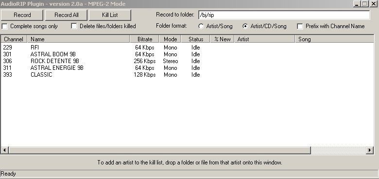

Interesting. The stations you describe sound pretty much the same as what AudioRip pops up, ie only 5 channels, and yet, I think I counted something like 13 or 17 (can't remember) different audio streams that were FTA. One other strange thing, when I was streaming the audio channels across my LAN, to try listening, I was changing channels, but the same audio was coming through for some reason. Anyway, screen shot of the AudioRip popup shown in attachment.
