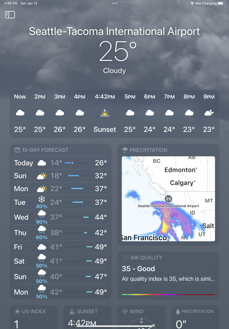

The COLD WEATHER UP HERE IN SEATAC, WASHINGTON!!!
In the 20's at this hour and will be 26 degrees, Saturday January 13th!!!
Do anyone here knows any best space heater for a 300 sq feet room
which has NO insulation up in the addick above?????
Do anyone knows what is the best space heater that handles
with outside weather in the 30's and drop down to the teens???
And that the house is NOT well insulated????

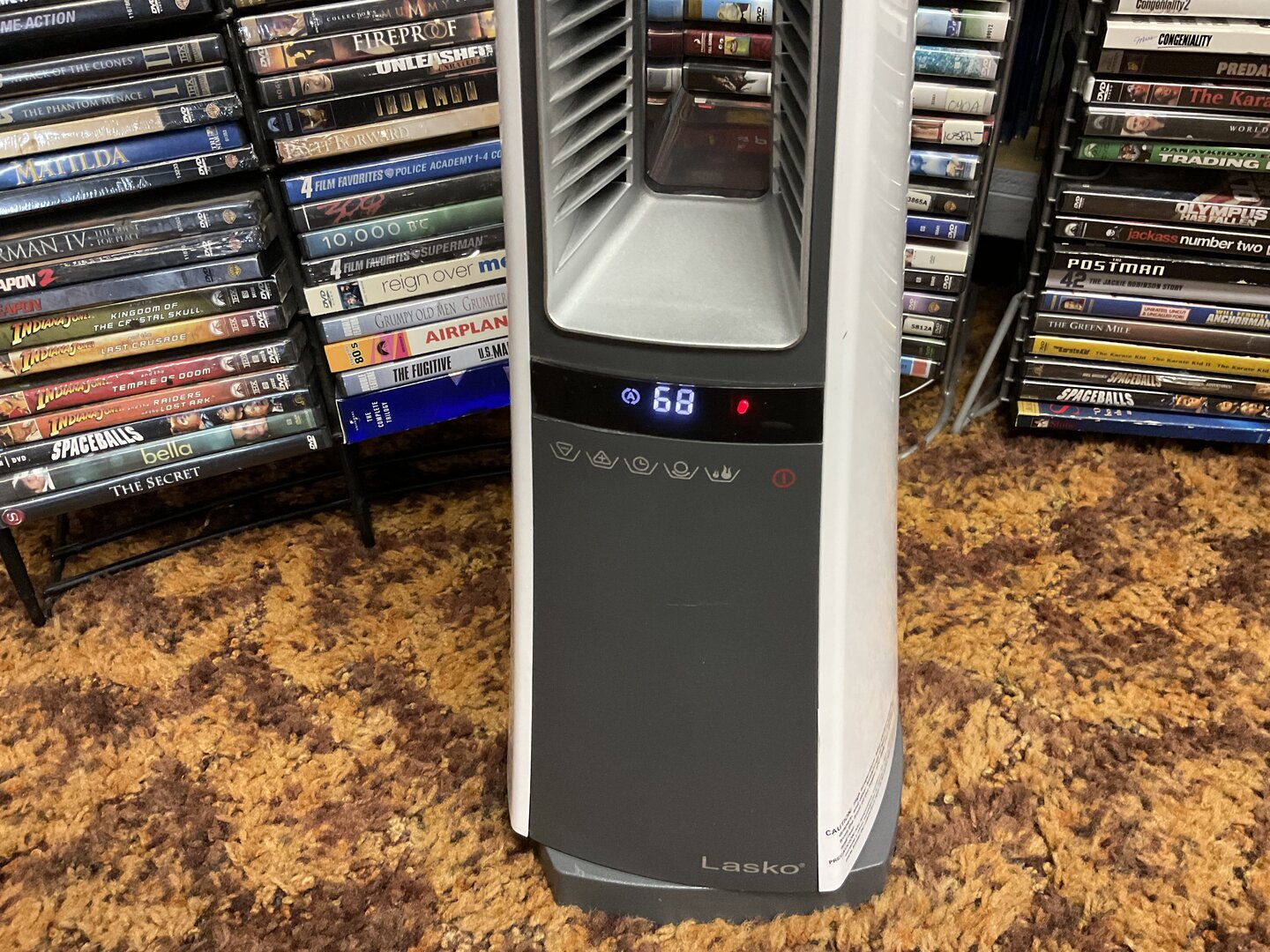

In November, 2023 my 38 years old nephew gave me this
Lasko Oscillating Bladeless Heater for a large room that's 300 sq ft.
When I got it, it worked!!!
That's because the outside weather was in the 40's and 50's
which makes my studio warm from 59 to 67 degree, with
the Lasko Oscillating Bladeless heater.

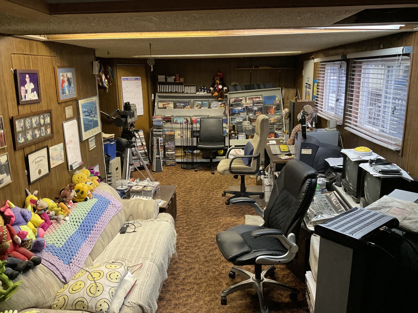

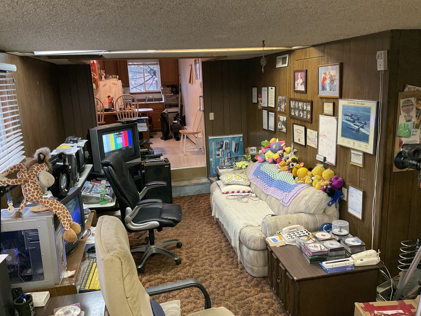

Inclosed photos of this heater and photos of my studio to show
you it's 300 sq, feet.
You'll see photos of the heater with different temp.
When it was 68 degrees inside the room with NO
insulation, the outside weather was in the
40's and in the 50's.

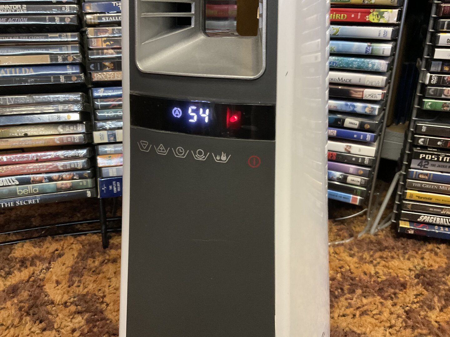

When the inside temp. is 54 degree "CHILLY" without
insulation, the outside freezing temp. is in the 20's!!!!

Remember, in the photos, above the ceiling is the addick
with NO insulation!!! That means cold air, especially during this
time, the arctic air or artic win goes through inside!!!!
This is the room where I type this thread to all of you.

That's a cluttered room. Make sure you have enough clearance around any heater. A no brainer.
