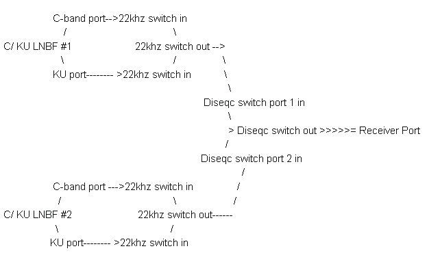

Yes I guess you would need dual LNBFs or dual LNB type feed horns.
One has to get creative with the different switches etc to make things work... can get rather complex! :)

I'm up and running with the following setup (below) using 2 C/KU combo lnbf's and two new Ecoda 22khz switches connected to one 1x4 diseqc switch. One lnbf has a dialectic plate to pick up circular signals while the other does not which allows for maximum signal pickup for hard to tune satellite in signals. The problem I'm having now is with the dish actuator motor arm that appears to be affected by the cold. Once I move the dish past 45.7 east it gets stuck and I cannot get it to go back west unless I go out to the dish and force it. Once this happens the satellite dish position are off and I need to re-aim the whole arc again. Maybe I will look into a stronger dish actuator motor instead of the cheap $70.00 version I got off ebay. (Edit) On my receiver I changed the settings for C-band to use 22khz off and for KU band I changed the 22khz setting to on as well as changing the port for the 1.0 diseqc setting.
