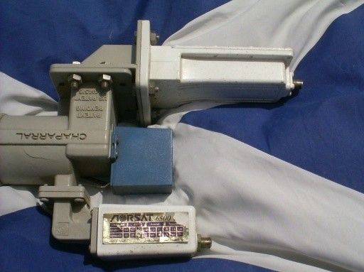

PSB said:
Yes you will need two LNB's for both C and Ku.
Some come combined (See picture below)
Some LNB's do both C and KU at the same time like the BSC621-2 LNBF
There is another way to combine C and Ku............
http://community.webshots.com/photo/100919814/1130616190051497581kAELDc
