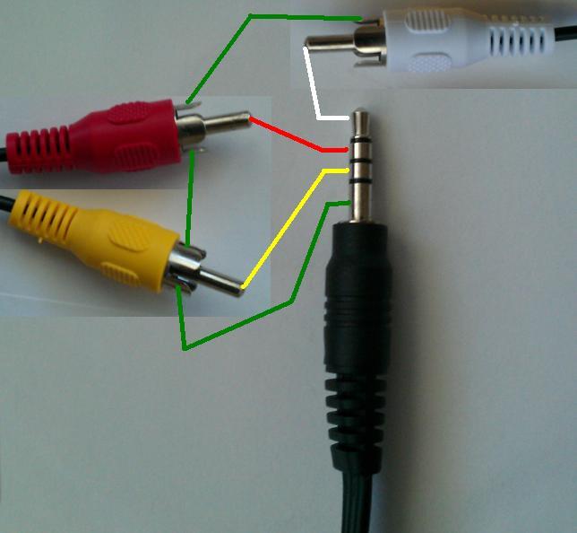

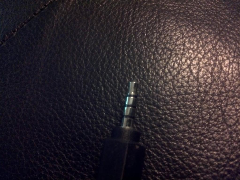

I would appreciate that. It's possible that these aren't standard. I think they came with my video cameras. I'm wondering what the tips of the jack goes to, yellow, red, white on the microhd. Then I could check the continuity.
Video and Audio from the microHD work fine on my Slingbox PRO-HD.
Unfortunately, there is no industry standard for TRRS (Tip, Ring, Ring, Sleeve) configurations like there was for TRS (Tip, Ring, Sleeve) earphone jacks.
Attached is the microHD AV plug diagram that will be included in the next Owners Manual.
View attachment microHD AV Plug.pdf

Cable arrived in today's mail. I had to swap the yellow and white but the slingbox is up and working. Watching MEtv at work. :)
