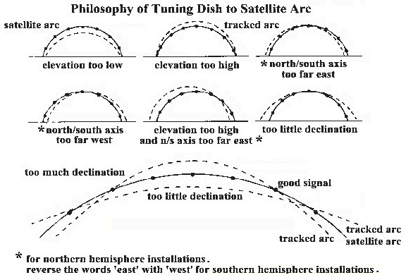

The only axis needing control is the azmuith (E <---> W) position. Once properly aligned, the inclination/declination position (elevation at any given point in the arc) is handled mechanically by the dish mounting assy geometry as it moves thru the arc.
My favorite C band dish reference site -
http://www.geo-orbit.org/sizepgs/tuningp4.html
The positioner arm, aka 'jack', uses a 36vdc motor and feedback pulse generator (reed switch/magnet) that creates counts as the motor rotates, moving the arm in or out, thus moving the dish thru the arc.
So we need a 36vdc source, 24v is probably acceptable. Even 12v would drive the motor, but mean the timeout to fault value (acceptable time between pulses) would be fairly high.

Whatever you do, if the dish came from anywhere near (within 25-50 mi) of where you intend to use it DO NOT mess with the elevation adjustments until you have read or discussed what a dish alignment consists of and what you MAY need to do to get it aligned.
