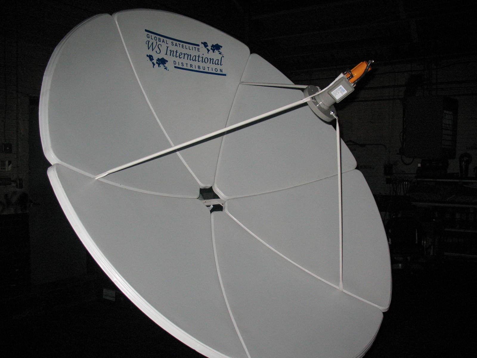

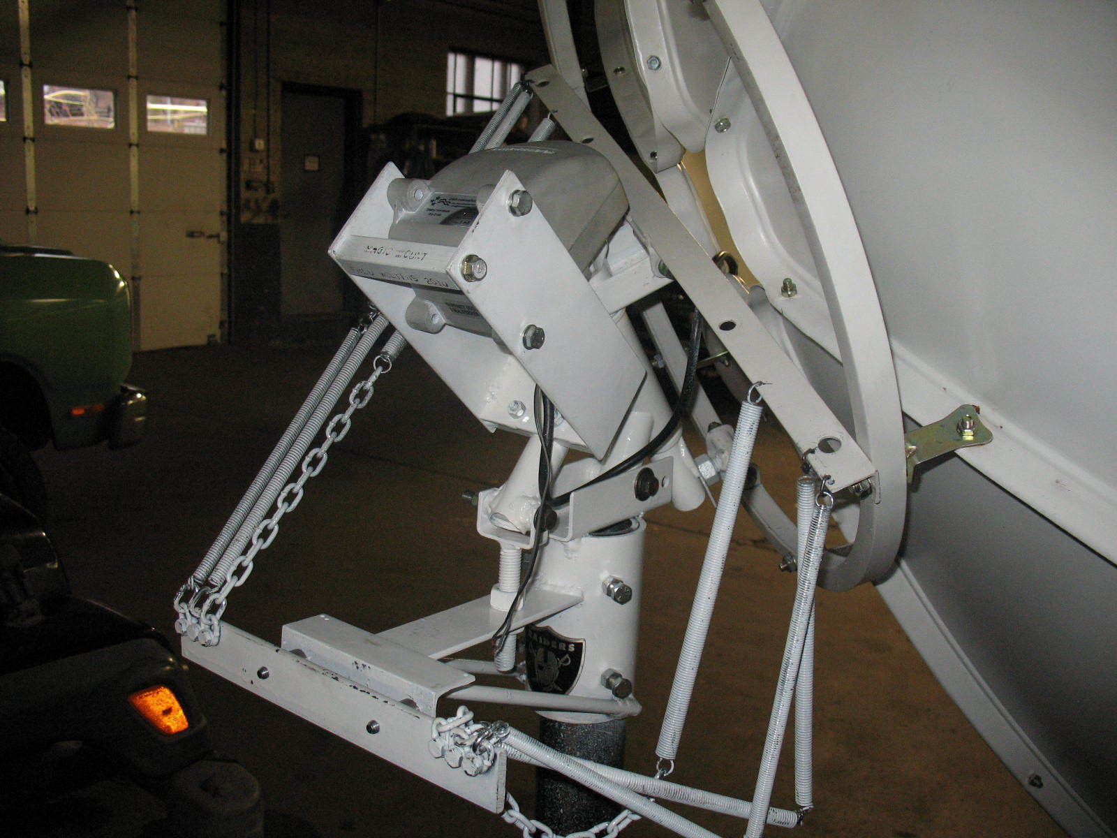

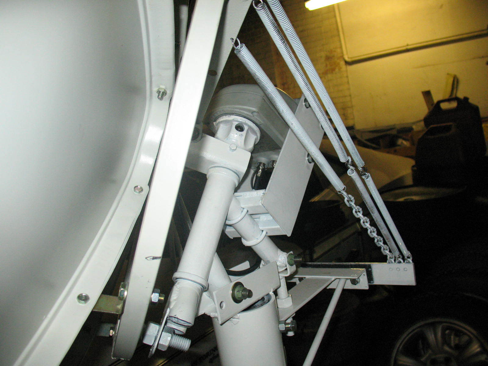

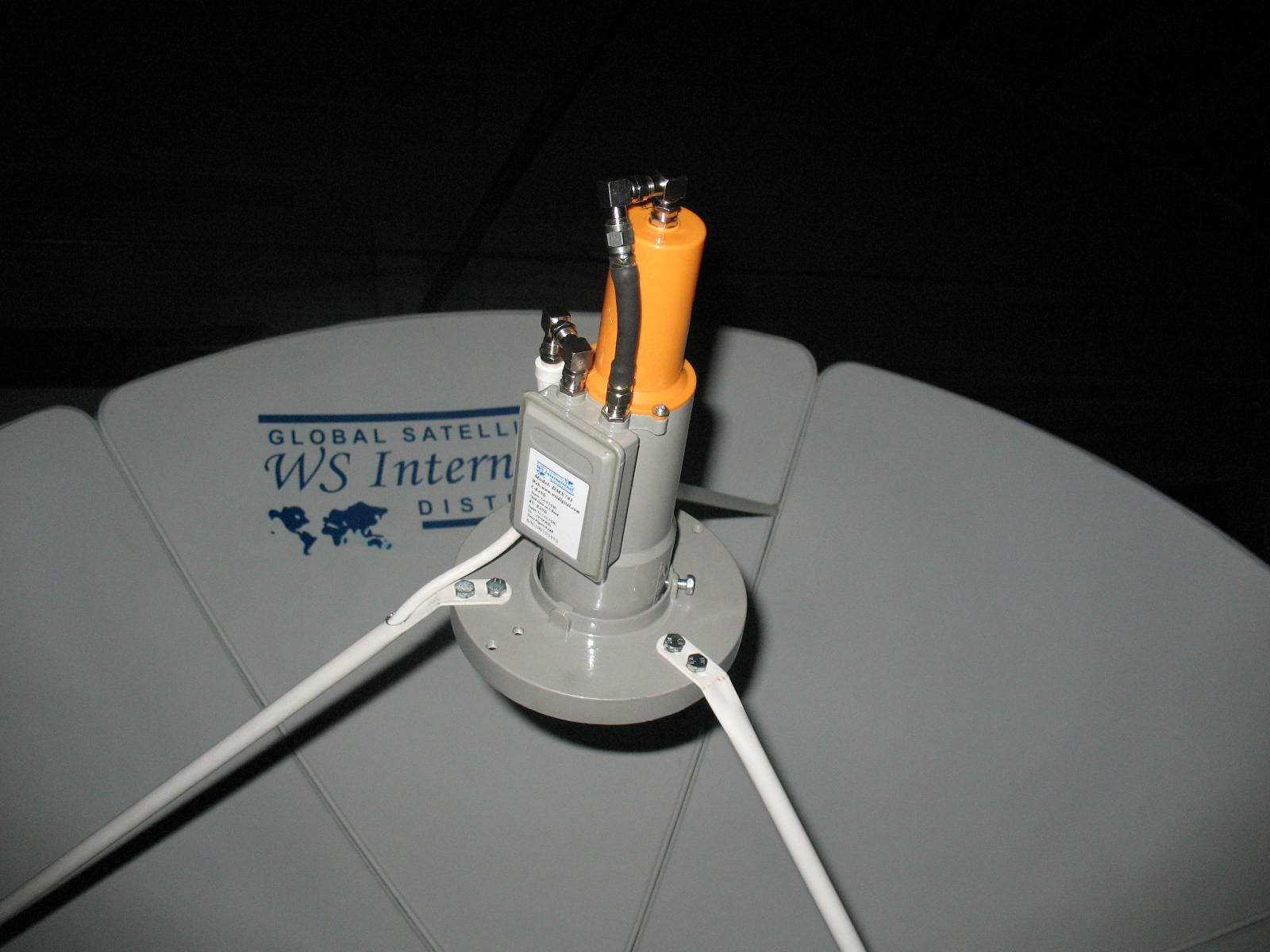

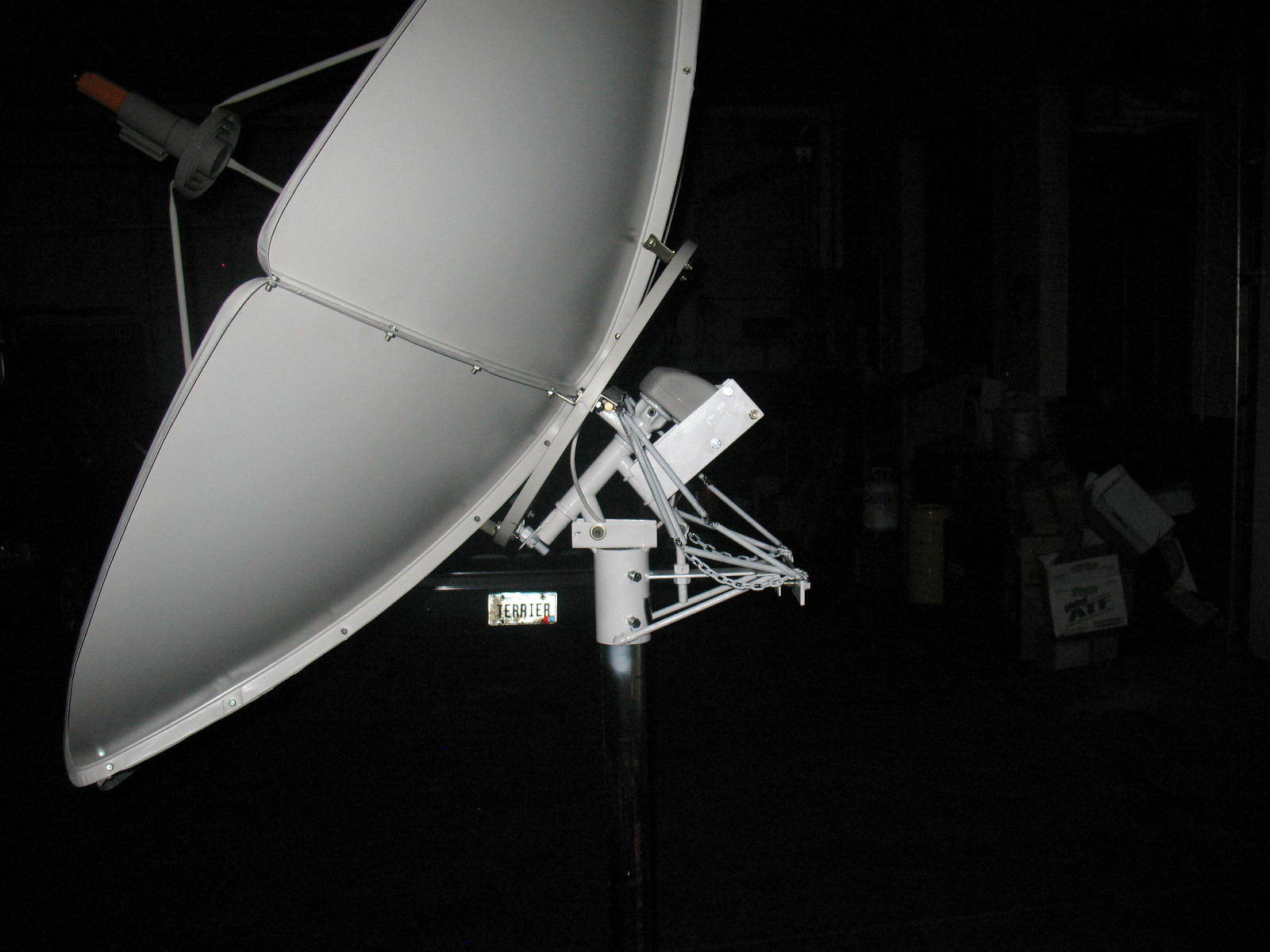

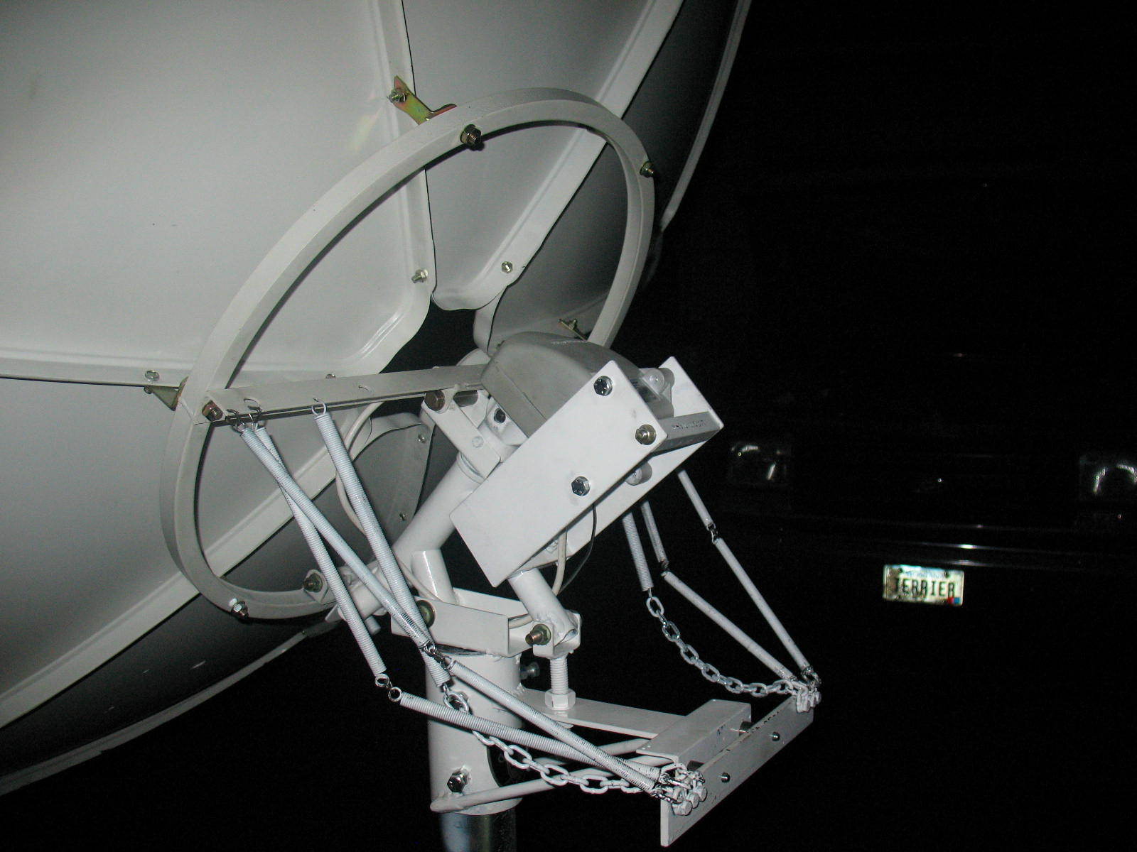

I too want to use USALS on a WSI 6' with a DMX741. But knowing what I just told you I may have wasted more than 18 Hrs LOL. I put a SG2100 on that Dish
Winter hit hard and fast here and I have to delay putting this dish into use.
