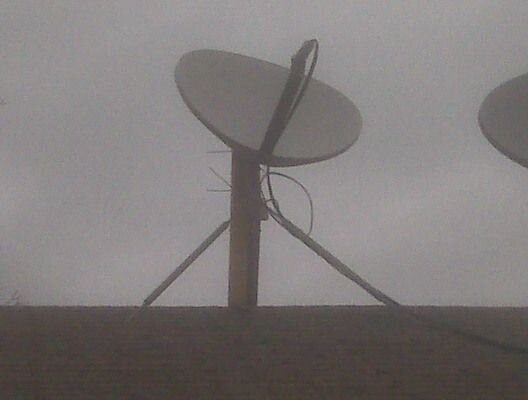

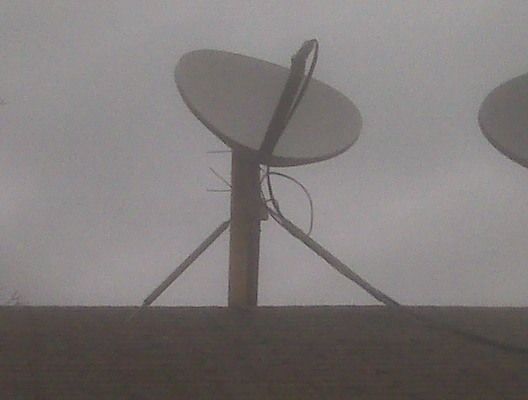

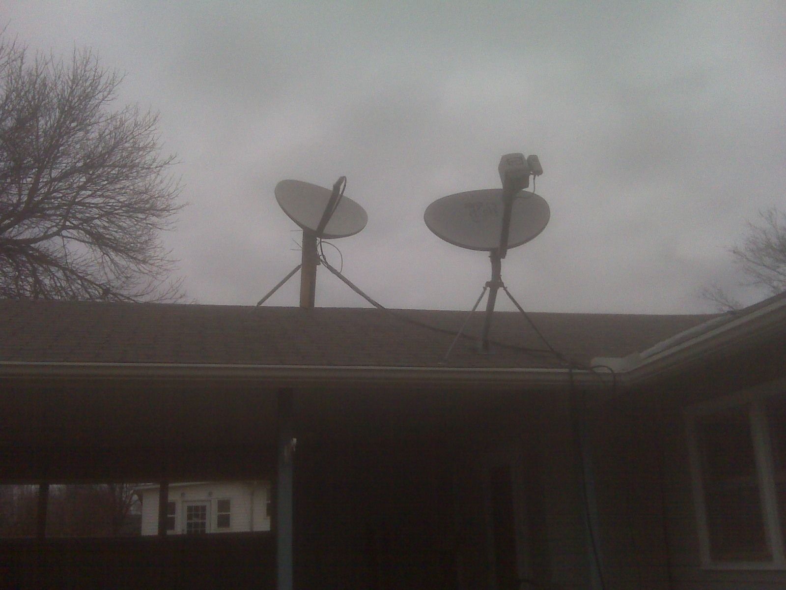

Here are the two dishes I have up at the moment. More to come as I have time. The super dish will be getting a liner LNB and will be repointed since DN scrambled everything on 119.

Actual DishNetwork SuperDishes HAVE a linear LNB on them already.
Sometimes people miss-identify a DN dish as SuperDish, though, so your mileage may vary.
There are other threads describing 'em, but I'll just say that there were two variations (metal reflector, and molded), and two LNB assemblies for EACH.
(so, four combinations)
They were either made for the 105° bird, or 121°w

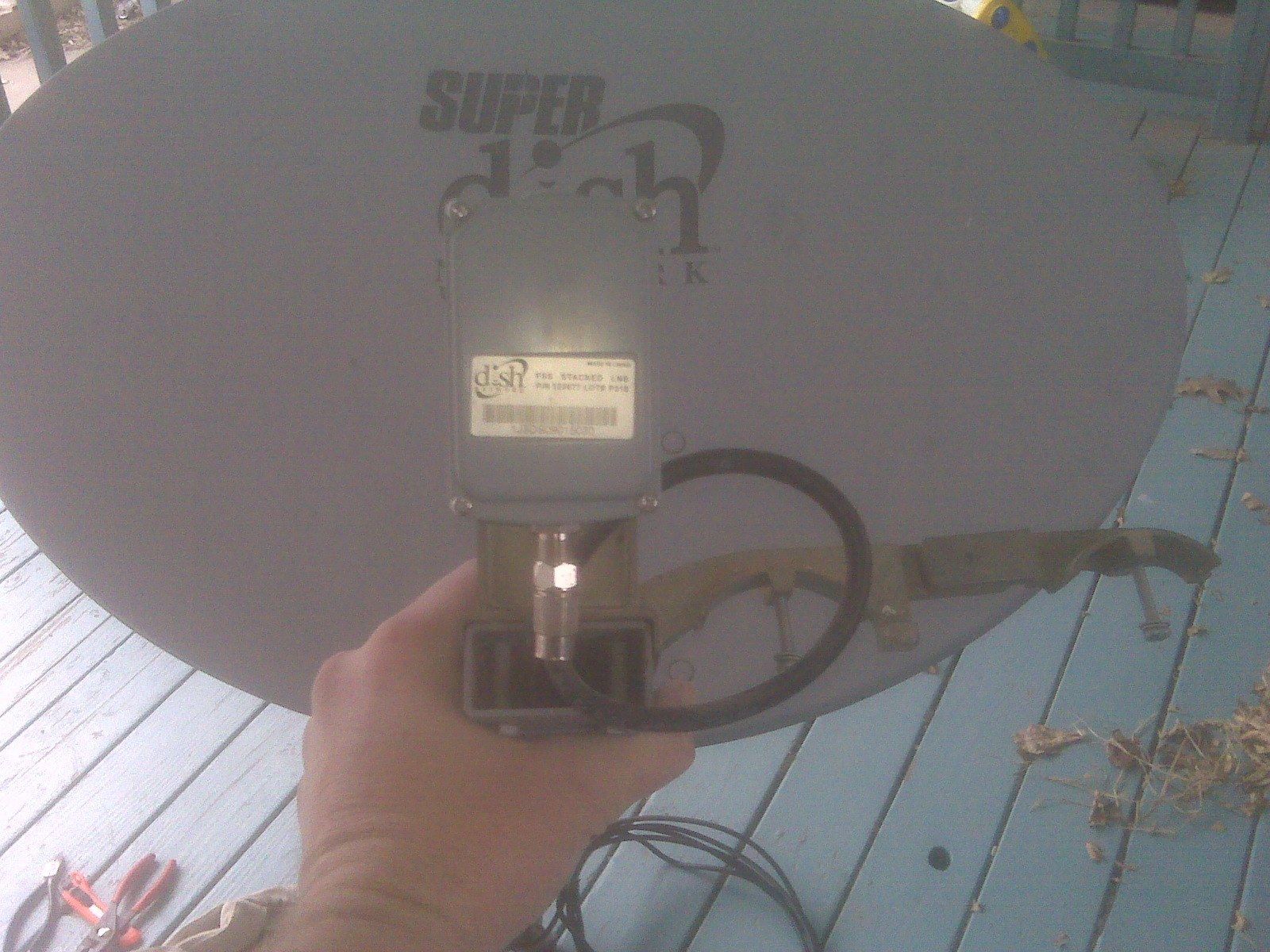

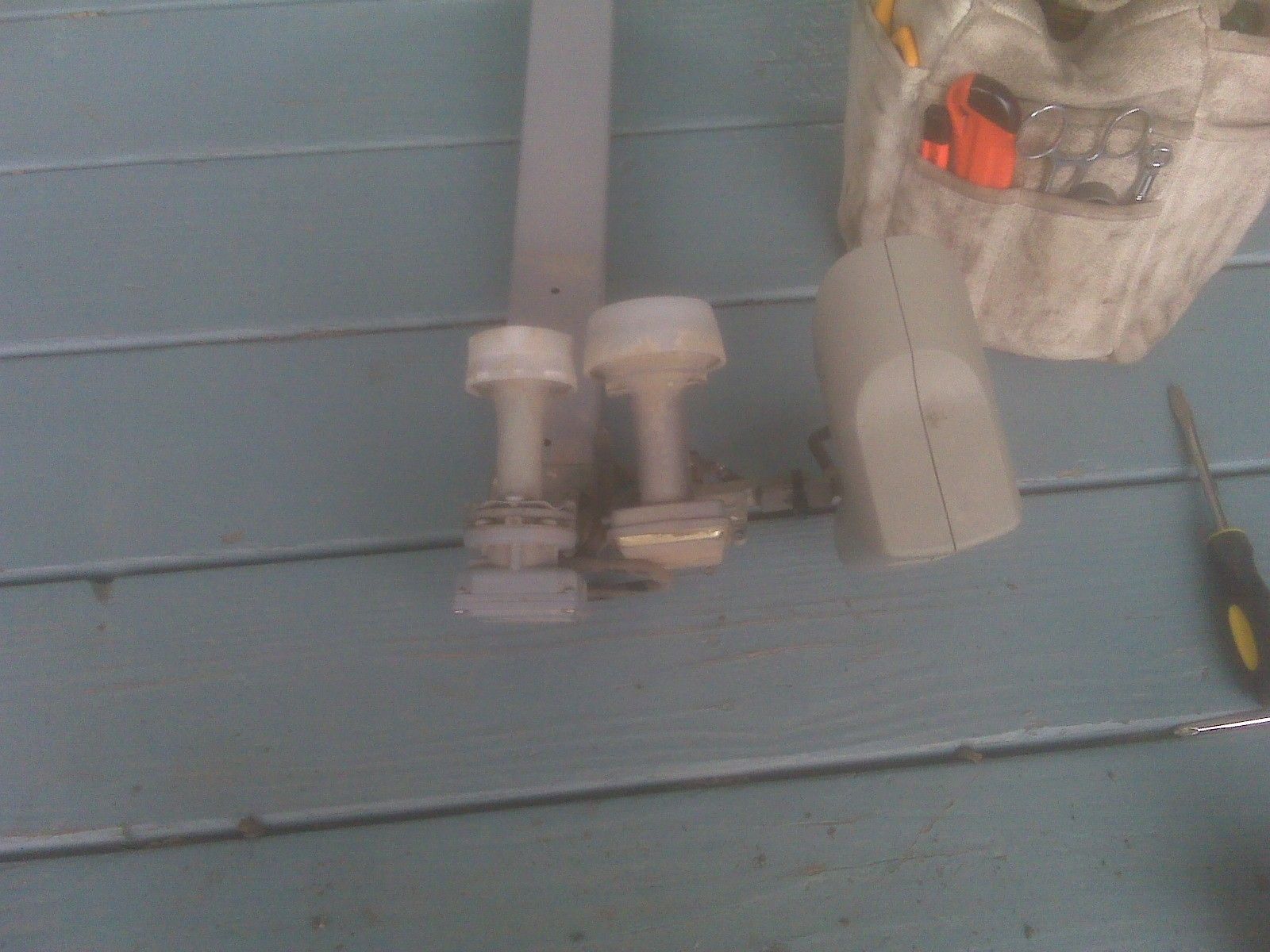

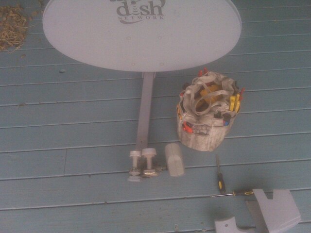

All mine say super dish on them but who knows. I take some pics up close soon and see what I have.
So the LNB for the 105 sat or the far right one if looking head on at the dish is a liner lnb?
Ok I was wrong the FSS Stacked Linear LNB is the one that is far left when looking at the dish head on. However since it is stacked how wil that play with the 93W dish? Will it run through the switch properly or not.

it will work with the switch regardless if its stacked or unstacked as long as its a multiswitch or a diseqc
Just set it to LNB LO 10750 and it should scan fine
you could use the LNB you linked to. Its not bandstacked so you'll be ok
