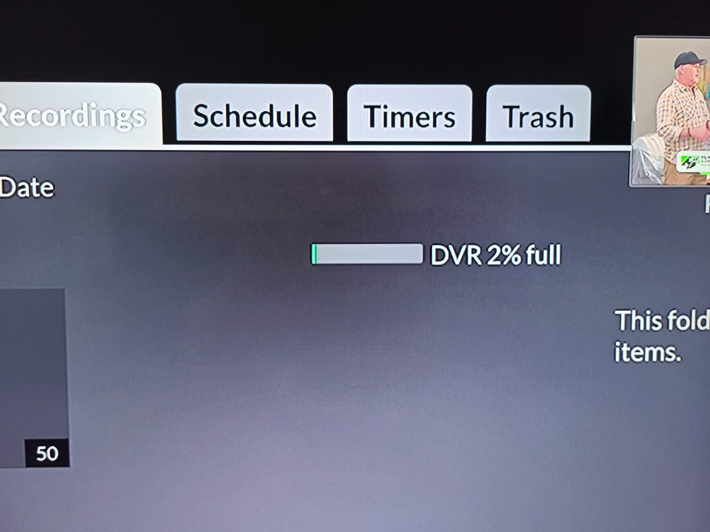

I ask because on my Hopper 3, the bar graph that shows the HDD % Full is now missing when I am in the DVR menu. It was alway there up until a couple of days ago and was wondering if there was a recent software update.

Looks like H380 is the most current. I received it this morning. Where do you see a bar graph?
Until recently, if you pressed the DVR button on your remote, on the main DVR screen that shows your folders with your recordings, there used to be a bar graph towards the top of the screen that would tell you what % of your HDD is used, with a bar graph showing the amount.
This was there up to a couple of days ago. Now is it missing.
Here is a screen shot what it used to look like but now is missing.

The bar chart that shows the DVR % is visible.

The bar chart shows the DVR % is visible which for me is 100% even though there is 120GB of free space left on the internal HDD.

H380 still has the issue where 119GB-120GB free is considered 100% full on the HDD so the last 119GB-120GB can't be used at all. The fix is either make it available with the correct % remaining or treat the HDD as 120GB less in capacity so the % meter for what's used is correct.
I got the Hopper 3 back in May and have also noticed this intermittent disappearing and reappearing of the HD full percentage bar. In the last week or two though, it's consistently appear and hasn't did its disappearing act yet.
I'm only at 2% for now, so haven't had a chance to really need it but did notice it!
